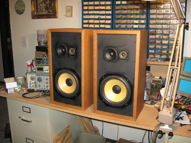

I've been building speaker systems since the 1960's as a hobbyist, and had a chance to learn quite a bit from EE's at Tektronix and Dolby when I worked there as an ET or EA. Recently, at age 61, I realize it's time to shrink my footprint so I can fit in a place I can afford. So I built a 2 way, with an 8 inch woofer and a Peerless/Tympany TG9FD1008 three inch mid/tweeter driver (in a sub-enclosure). I bi-amp it with X=500HZ, 4 pole LR active crossover. The cabinet is almost a copy of the AR4X speaker (slightly larger) , and is sealed. I also put another circuit in the crossover chassis that boosts the low bass by about 10dB, peaking at 34HZ, with a fast rolloff below that, and no effect above about 100HZ. I also designed and built a 4 section Baxandall tone control circuit for my preamp.
I can't recommend a 3 or 4 section Baxandall tone control circuit enough. It's ridiculous that any preamp doesn't have this. And the low bass pump circuit is also to die for in my opinion. For woofers I'd recommend a Peerless Nomex cone, 6.5 inch or 8 inch. I have those in another system and love them.
What's great about my system is that there is no crossover happening in the upper-midrange, like so many other speaker systems have, where our hearing is most sensitive. No moving lobes of maximum intensity, and no abrupt change in off-axis dispersion. My 3 inch acting as a tweeter rolls off relatively gradually. The end result is one of the best sounding systems I've ever built.
Also, getting a passive crossover to be accurate is often very difficult, due to the changing impedance curve of many drivers. Cabinet effects can make this more challenging still. An active crossover performs exactly the way you design it, and good tone controls give you the ability to deal with room acoustics, Fletcher-Munson and baffle step issues easily and effectively.
The sub-enclosure for the 3 inch driver must be completely resonant free. I used a 4 inch inner diameter ABS plastic plumbing pipe (bought at Home Depot) that goes all the way to the back of the enclosure (about 9 inches), and is about half stuffed with wool felt, foam rubber and regular synthetic fiber glass fluffy stuff. it's a sealed enclosure as well. It measures flat from about 400HZ to about 14kHZ.
When I took this picture, I had the Vifa/Tympany TC9FD1008 drivers in the box. They are almost identical to the TG9's which have light gray glass fiber cones. The TC9's measure almost as good for half the price ($12 instead of $22 per). The TG has a slightly smoother high end.
This may be overkill for what you're trying to do, but this is what I've learned is a great way to go. The stereo effects have a coherence that you don't always get with more complicated systems, and the low bass is VERY enjoyable. Now I just need to sell my much bigger 3 way triamp'd open baffle system in the other room...
Oh, I forgot to mention the tweeter. It's the same one McIntosh used in the early 1970's, but I never actually hooked it up. There's no need to. I was going to bring it in at about 8kHZ as an option, if the 3 inch driver didn't have good enough high treble. The TG9 sounds so good I don't want to mess with it. I power the whole thing with a 4 channel 3886 power amp I built. See more on my website if you're interested. http://www.ephaseaudio.com/
