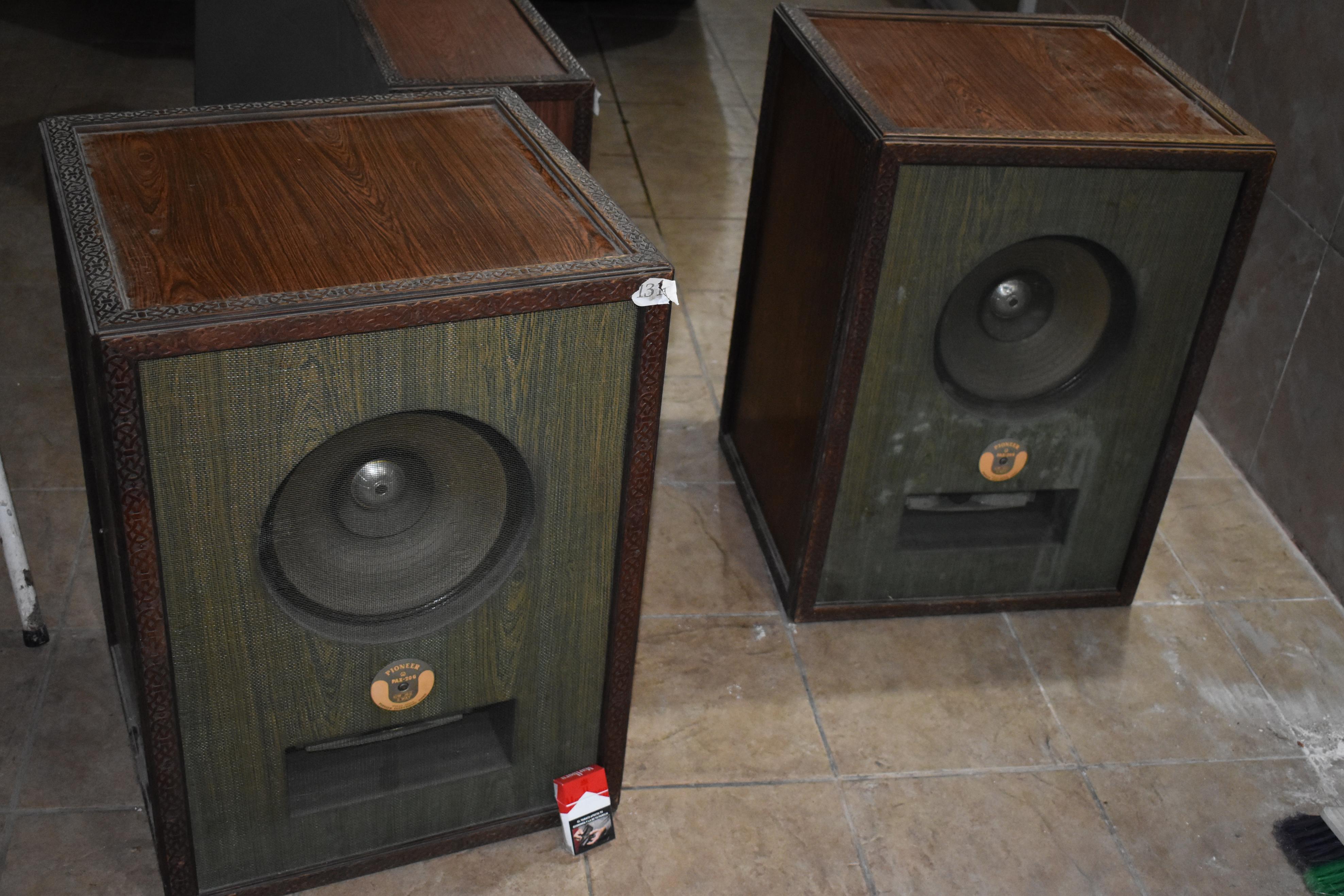

FR= Full-range, A single full range driver designed to cover all the frequencies.
These drivers have come a long way for awhile now...I have a 1963? vintage Leea brand 1222XE twelve-inch full-range as my mains now.
I was thinking for you a pair of Visaton BG20 eight inchers, $40 USD each , in a 124.6 liter enclosure might do the trick.

Upon closely looking, I thought the metal dust cap was damaged & wrinkled, turns out, it is intricately embossed with ribbing & the Leea logo.
