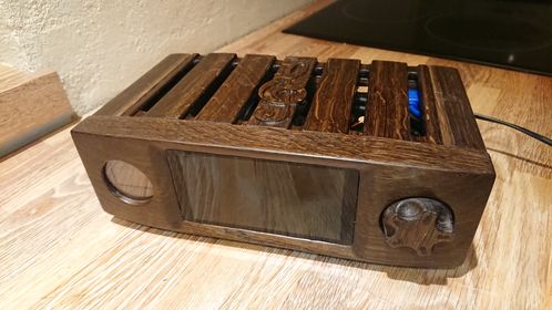

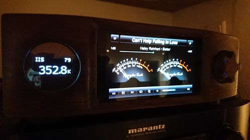

So far I have completed step 1 building a RPI based streamer/DAC/preamp based on Audiophonis modules, a oled screen, oak from my granmothers old table, my cnc router and many hours. Pictures attached.

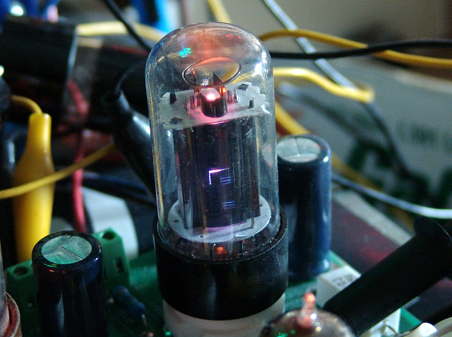

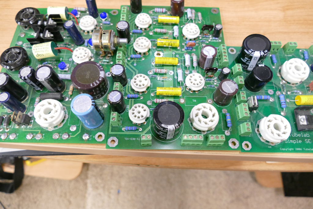

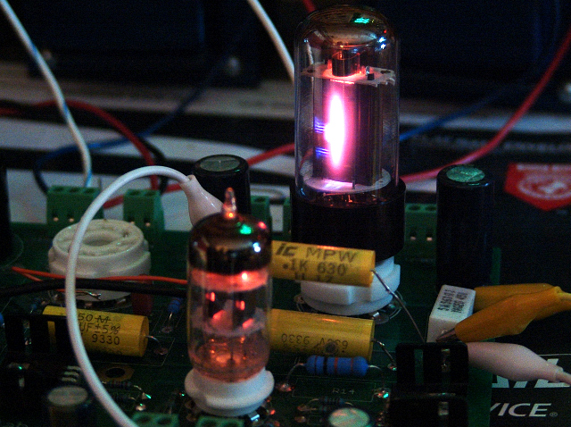

IMO, Octal sockets on printed circuit boards (PCBs) are a bad idea. The forces associated with Octal tube insertion/removal easily crack the substrate and/or damage traces.

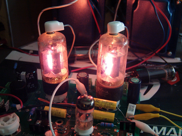

That was true 50 to 60 years ago. Today, a properly designed and well made PC board will not fail with octal, compactron, miniature, or even 4 pin 300B sockets in it. Traces to the tube sockets should be 50 to 100 mils wide and large annular rings should be used during layout.
I have been selling these PC boards for 15 years and have never seen a PC board failure at the sockets. These three have served as some of my test boards. They get used for experiments, some of which don't end so well. The SSE has seen many blown electrolytic caps. It gets cleaned with alcohol, and reused. The TSE is Tubelab board #1, the first ever commercially fabbed Tubelab PC board. It served as a test mule for several years early on. All are between 11 and 15 years old, and have seen lots of tube insertions.
The sockets will fail long before the board will. The SSE board in the picture has had at least 3 sets of output tube sockets. It can be seen here undergoing some "extreme duty testing" almost 12 yeas ago.
A pair of cheap "NOS" tubes sold to me by AES were obviously well used when I got them, so I decided to subject them to some extreme testing. Yes, you can get 15 watts from a 6BQ6GT in SE....for about 10 minutes.
These 6V6GTA's were from of a NOS sealed bulk packed box of 100 that I personally picked up at a NASA auction in Florida 12 years ago. About 25% were bad, with milky or missing getters. Most that remain today have since gone gassy. I "tested" some of the gassy tubes in my trusty SSE board 12 years ago. A runaway led to a vented cathode bypass cap, which was replaced with the 100 volt caps that are still in the board today.
PC boards from the past were indeed pretty bad, especially the brown phenolic stuff from the 1960's. Todays FR-4 will take all you can throw at it without issue. Extreme heat can darken or discolor the board, but that is usually not harmful. I recommend that hot parts like 5 watt cathode resistors be spaced 1/4 to 1/2 inch off the board for proper air flow.
The tube sockets are best replaced by cutting the old one out with a sharp pair of cutters, cutting each pin at the base of the socket. Then remove the pins from the board, one at a time. Clean out each hole with solder wick, and put in a new socket.
You can heat-damage today’s FR4 boards enough to make them partially conducting - eventually. It takes some doing, not just a little discoloration. You pretty much have to turn it *black* - and that takes multi-hundred or thousand watt solid state amp with shorted output transistors. And some resulting fire from 5 watt emitter resistors dissipating several hundred watts. They can conduct much more current than a runaway tube, and the power supplies used can deliver 50 or 100 amps into a short. Tube amp transformers can’t deliver that kind of current.
Boards from yesteryear would get partially conducting if they just look a little “cooked”. And traces peeled off just recapping, let alone replacing dead output transistors. Especially so if the board got cooked. I wonder if that’s why a lot of compaction horizontal sweep tubes are only rated at 200 or 220 C bulb temp rather than the 250 for audio tubes, and dissipation numbers were typically lower for a given size plate. They used those old phenolic PC boards back in the day, and the whole TV had to be reliable and serviceable.

Tubelab Universal Driver Board, 2015 version
Follow the link in the first post for a detailed blow by blow design effort from opposite ends of the world.......it is a long but informative thread.....and, no you don't have to use 6L6GC's.
I have stuck anything from tiny 50C5 radio tubes to big transmitting tubes into my test amp....no 6L6GC's though. I trust the design well enough to stick some priceless NOS JAN GE 6550A's in it and crank them up:

As for the PCB, i have noticed that Belton octal PCB sockets are quite reliable. I am working on a 6SN7 KT88 PP board right now if you want the eagle files for that.
