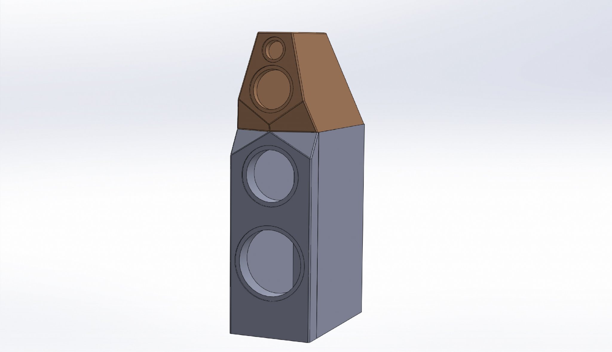

Here is a shape concept worked up for this speaker. I will go into the cabinet design later. But now I am seeking ideas for where to look for a great sounding easy to crossover driver for a reasonable cost.
Speakers I am planning to use:
Tweeter: Morel high end tweeter. these are never used tweeters I have had for some time. I forget the model number.
Upper mid bass: Audax hm170c
Lower mid bass: undecided 8-9 inch driver
Bass driver: Dayton RSS265HF-8 10" Reference HF Subwoofer 8 Ohm
Here is the shape concept for this design. The bass module is 14 inches wide and about 24 inches deep. The head module is a separate cabinet and the goal is to cast the head module out of epoxy granite with rough uneven surfaces on the interior and integrated braces. Possibly some kind of internal reinforcement inside the EG casting. Maybe welded rebar if magnetic induction will not be a problem.
The bottom cabinet is a combination of UHPC for the baffle and a special sandwich of MDF and polyeurathane for the main cabinet. It will be heavy. Probably over 300 pounds. Bass unit baffle alone weighs about 90 pounds.

My experience after over 40 years of DIY is that it will be very difficult to get things done with a 4 way passive crossover.
You will have to work with a decent measurement system and import the stuff in some kind of simulation software like VituixCAD 2.
Here you can assess the behavior of the system in the frequency domain also off axis without spending a large amount of money only for all variations of coils capacitors and resistors in a passive crossover.
May be a step by step approach could work - start with the passive crossover between tweeter and high mid range drive unit, but there is a high probability that the low midrange high midrange crossover will affect the high midrange crossover behavior for the high midrange drive unit.
Hezz, I consider your concept a little flawed. Instead, 2 of the Dayton 10" units in parallel, then Audax HM 170, and tweeter. Stay away from very low woofer x/o points. This way you will profit from higher sensitivity and more straightforward, simpler x/o design.

Passive? You're on your own. Active? MiniDSP 4x10HD.
If your heart is set on an 8-9, then maybe the SB NRX23. Personally, I'd be going for a 10 or 12 and a pair of 12s (proper sub drivers not midbasses) on the sides push push.

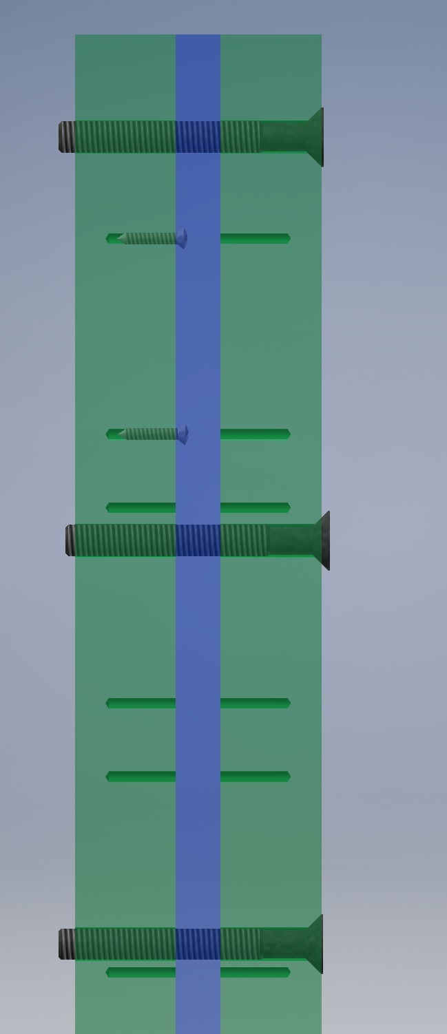

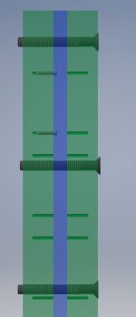

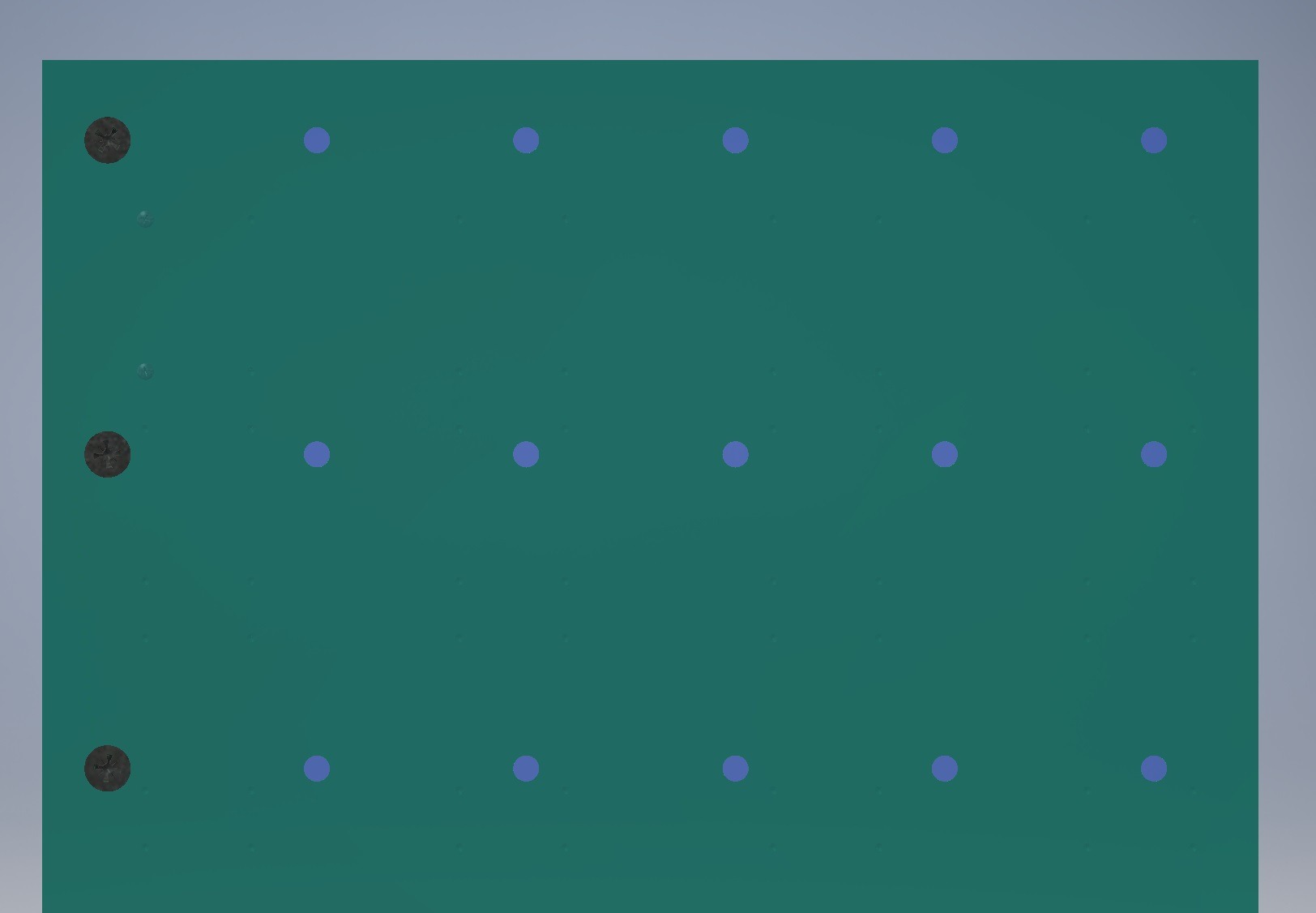

So here is my idea for improving the sound dampening qualities of DIY speaker cabinets made with primarily MDF. I have mocked up a section of side speaker wall to illustrate. please imagine screws and bolts similar to the ones shown in all of the holes.
The speaker cabinet is essentially built as an envelope design with spacing between the inner and outer MDF panels. They are rigidly held together to strengthen and stiffen each other and held apart by a large quantity of bolts that are threaded to maintain the spacing. The spacing of the bolts will be close and vary a little bit to spead out the resonant nodes. Unusual patterns can also be used. But in this mockup they are spaced evenly to make easier to model.
On the inside of both panels are many small screws partially driven into the MDF so that the heads protrude but do not touch the opposing MDF panel.
After the all of the small screws are put in place the inner cabinet is placed within the outer one and then the larger bolts are placed to bolt all of the inner and outer cabinets rigidly together. Then high hysteresis pourable polyurethane that has strong bonding properties is poured between the MDF panels to fill the space between.
Analysis: The larger bolts make the total wall system more rigid and the close placing of the bolts drives the panels into producing higher frequency modes in each section of the wall panel. These are higher frequency and high Q resonant modes. These high Q modes are easier to damp than lower frequency low Q modes. All of this is done with basic tools that the DIY'er can do. This is a kind of hybrid constrained layer damping. The inner screws are just grabbing points for the poly to wrap and cling to which should increase bonding between the poly and the MDF.
Tests have shown that thick fillings of pliable material between two equal mass panels do not reduce vibration much at all. But in this situation we have added structural elements (bolts) that will cause tension between the panels as the middle layer vibrates. Thus driving the middle layer into more stress and losing energy by heat release.

You want to avoid using bolts like you are thinking of. They will just act as a bridge that transfers all of the energy to the out side of the cabinet. Different people here on the forum have tried any number of different combinations of materials trying to find that prefect combination with varying degrees of success. The general idea is to add mass to the panels and or bracing to stiffen them. Another way is to combine different materials in a panel sandwich. That's usually two ridged surfaces with something more mailable like a layer of cork glued in between but not attached with bolts. The whole idea is to decouple the inside from the outside and using bolts does the exact opposite.

A CLD construction does rely on the shear movements between the two outer layers, leading to friction/energy conversion in the constrained damping layer. Bolts will reduce the amplitude, but will also effect the friction in the constrained layer because the shear is reduced. So in essence this setup will not be as 'lossy' as a traditional CLD build (higher Q).
The gains on applying CLD to bass enclosures can be disputed anyway. Sound transmission in loudspeaker enclosures tends to peak at mid frequencies (500-1500Hz), depending on the usual parameters size, stiffness, weight and friction losses. So for a sub up to 200Hz they are more not than often of concern. And besides, the room response likely will be dominant by far: you won't notice the enclosure resonating.

Thanks for your comments. I agree that at least for the bass enclosure and the low bass total rigidity is more important. I have seen a few empirical tests of CLD and the only ones that worked very well were certain kinds of thin center layers and equal mass outer layers. The big problem is that the area from 80-500 Hz is perhaps the most important range for music and if only a small amount of resonance control could be enacted in this range it would be helpful.
I have never seen a test on a panel that is designed like this one and it would be interesting to design one to see how well it performs in a test and what it's waterfall chart looks like.

Please undersand that I am not trying to forgo lots of internal bracing. Lots of internal bracing is necessary for any attempt at the highest quality speaker cabinet. I am just trying to push the boundry of what can be attained with the typical two layers of MDF. I don't know if this would work. I have not followed speaker building much for a couple of years but I have never seen anyone build a cabinet like this and combine it with lots of internal bracing.
If you have any links to any speaker builders on the internet that have done something like this and you have the links and you could post them. I would be much interested in looking at the results.
