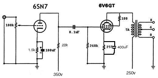

6V6 as a triode sounds very good. I am not sure if you will have enough power with 91dB speakers and SE though. Maybe, depends on your listening habits.

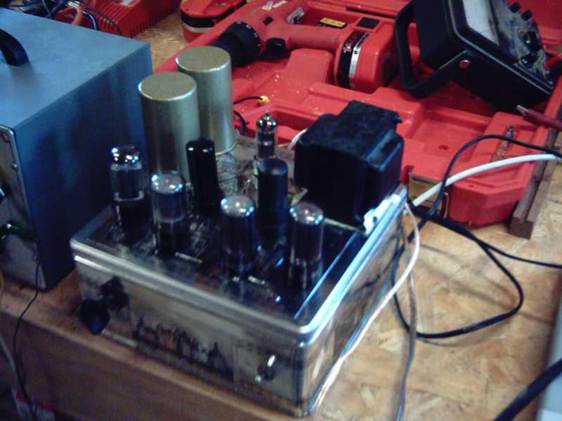

The first scratch built amp I did is an adaptation of a schematic from a 1953 book by the name of "Practical Amplifier Diagrams". Lots of fun and sounds great. I used some found toroids as the output transformers, a power transformer salvaged from a $20 ebay amp and a 6CA4 from the same amp as the rectifier. Tubes are 6N7 and 6V6 and it is push pull. A couple of polypro/oil caps, a surplus buy choke and some miscellaneous parts. Total cost probably around $50. I can redraw my old schematic to an as built if you are interested in seeing it.
I built it in a Castles of Europe motif tin, hence it's name, "The Crackerbox"
Michael

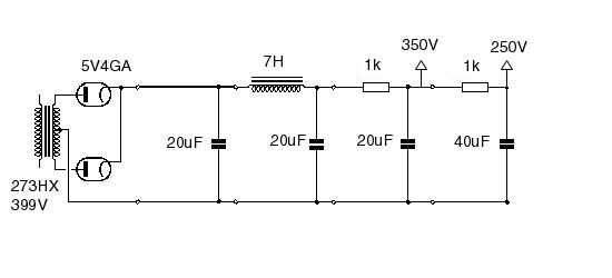

here are the schematics for the slightly altered 6v6 amp. i have less efficient speakers than you (88db i think) and it is pretty much the exact volume i wanted. i usually listen around 70% - 80% which is just loud enough to make it hard to hear someone talking in the room. i do live in a tiny apartment though...
