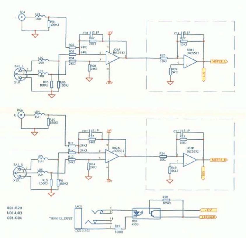

Check this meter circuit. I know it´s from a MAA-406, but I can´t imagine, that they would have changed this much.
The main thing is, that there´s a trimpot on the meter circuit. This is used to adjust the meter sensitivity/output for the incoming signal. You have to rig up a test circuit, if you want it to be accurate. If it´s only a question of "the looks", just adjust one to match the other.

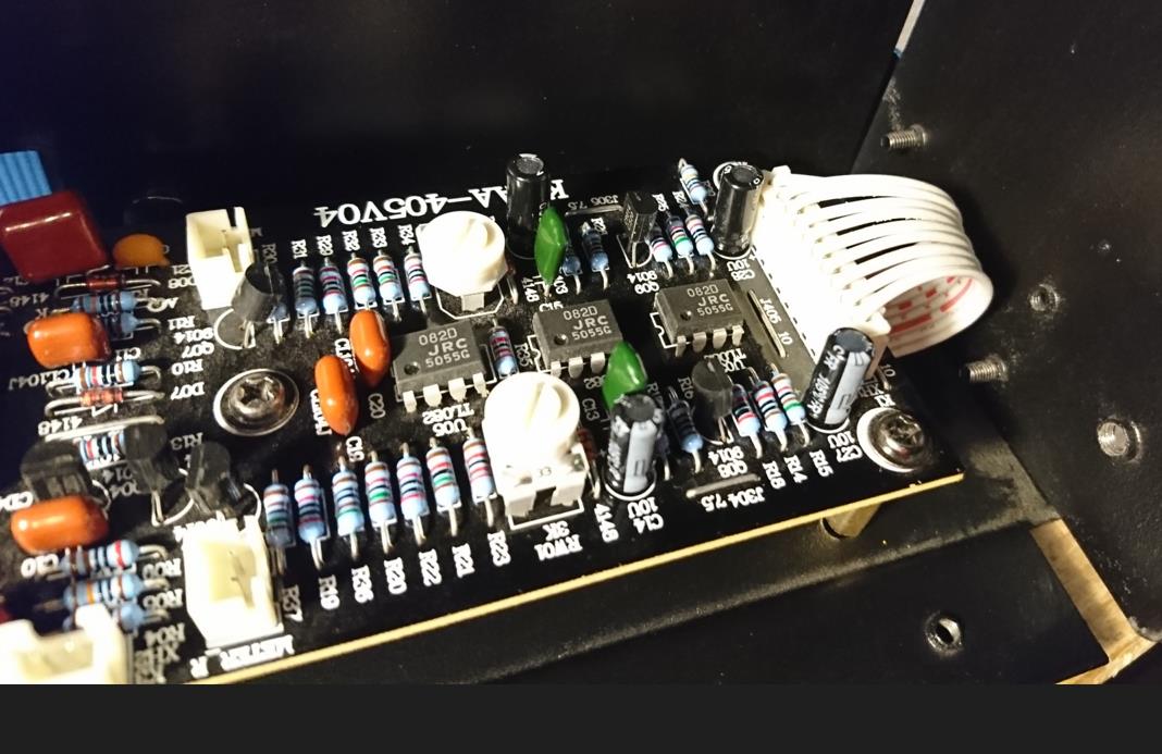

I did some repairs to a pair of these (without schematics). If I remember correctly, the circuit for the meter is in the front 'box'. If you remove the front plexi-glass with the meter, it should be on the right side. I think I remember seeing a potentiometer there.. Try it if you feel like experimenting..

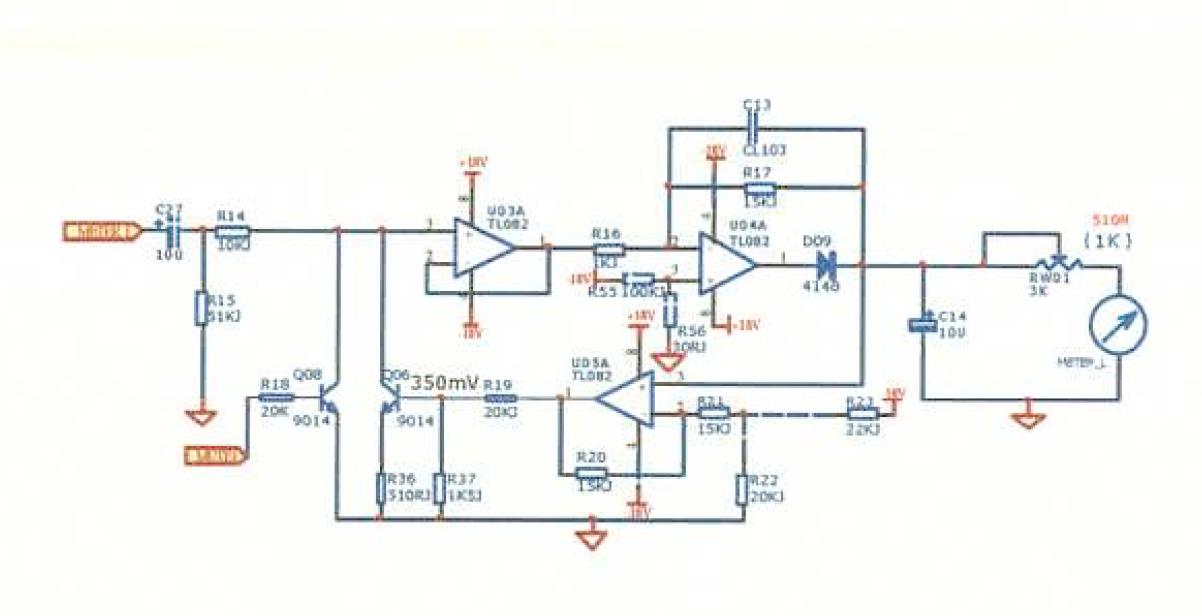

Well, to increase sensitivity you are really just changing the gain of the meter circuit or attenuation of the sampling point. Simple in concept, but you need then to protect the parts from excessive voltage when in high sensitivity mode, also not hard to do. You'll probably want to use a switch unless you go for more complexity to make it auto-ranging. The othe roption is to use a TA7318P type log meter amp IC where it will cover the entire range. Look at something like a Luxman M-02 for an idea of that circuit.

Yes, you would have to attenuate the input, or change the circuit as what exists would clip at higher input levels to reduce sensitivity (but it is set to lower sensitivity now). To increase sensitivity you would look at R55 and R56 I think (then it will clip at higher levels probably). U03A is just a buffer and U05A seems to provide modified feedback. I didn't get right into the circuit deeply. But if you want to have a set and forget display, a log meter amp like the TA7318P might be the way to go. Otherwise you are dealing with a switch, or automatic ranging solution for what is really juts an output activity monitor really. Of course the meter face would have to indicate a log reading, so there is pain as well.
What I see happening is to modify the R55 and R56 values, then a switched attenuator on the input. I say this because I don't know if the circuit would be unstable with wires running from the existing input attenuator or not. You just never know even though it should be stable if you want to try that first.
