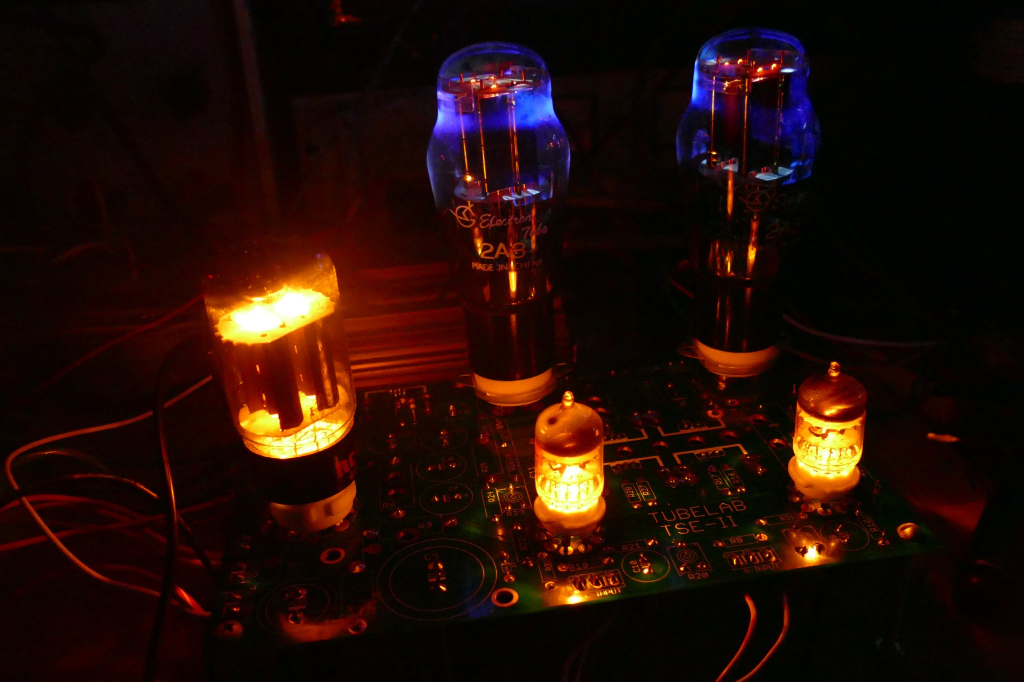

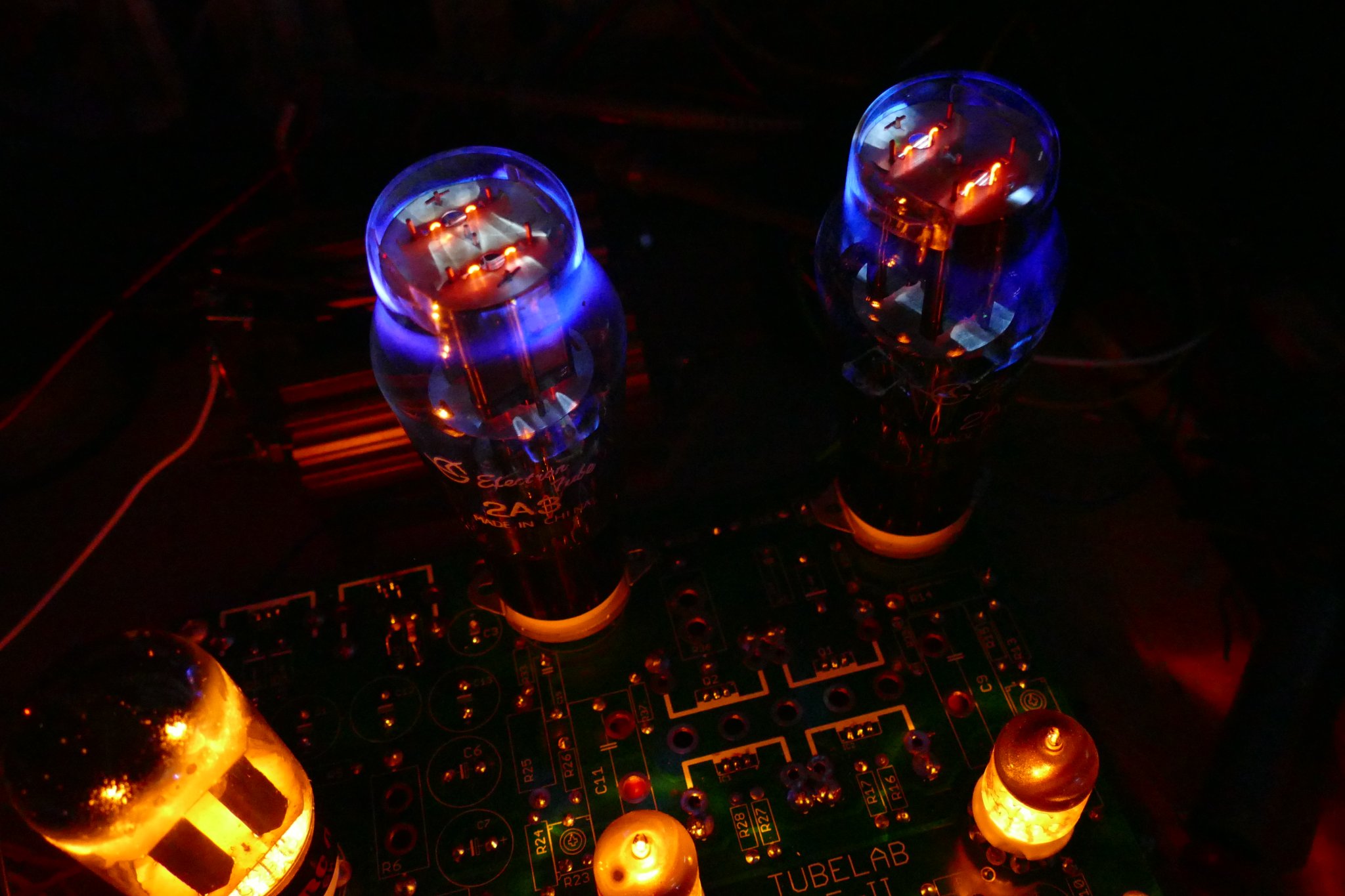

Ever see a DHT glowing blue on the glass. Someone we might know just turned up the juice on a pair of 10 year old Shuguang 2A3's. These are running at 380 volts and 70 mA with a 3000 ohm OPT. The amp is a TSE-II with no modifications other than a Hammond 372HX power transformer. The OPT's were the same Transcendar 3K ohm units used in a 300B amp. The amp doesn't see much use, but the tubes have been in it for over 10 years.
