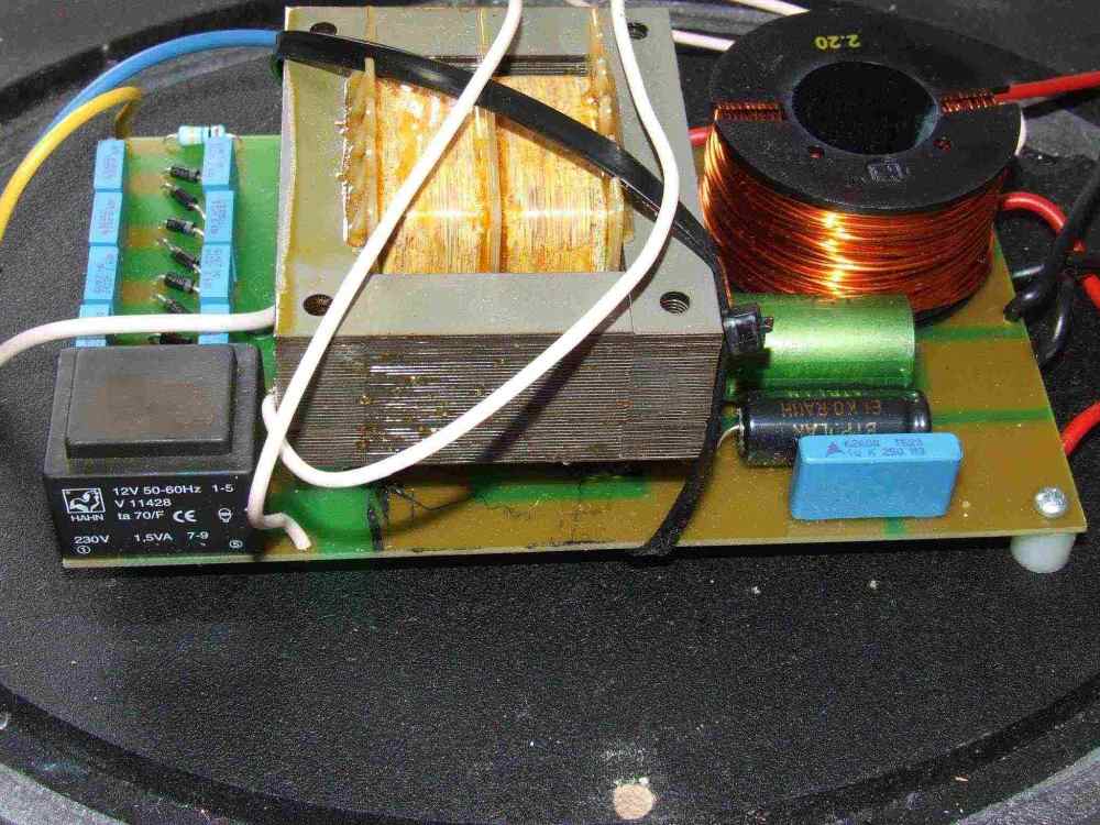

Incidentally, Final appear to have a made a considerable change to the step-up transformer at some point during production, from a large heavy one (S/N 2000 30617), to a much smaller and lighter encapsulated one (S.N 2000 30684).
Perhaps we can narrow down the point at which the change was made with the more serial numbers from other forum members who own 0.3s. I have attached a picture of the heavier (earlier) one.
Tim.

That's the same trannie as mine.
What serial number, please?
I assume you are asking about the cross-over values.
The bass section consists of a 2.2mH inductor followed by a conjugate filter which consists of a 1.25Ohm (IIRC) resistor and a 220uF cap (I have reworked this part of the cross-over on a different pair for a more even response up to the cross-over point).
The treble section consists of 33uF (bipolar) bypassed with 1uF, seen in the front right of the pic.
TimA.
