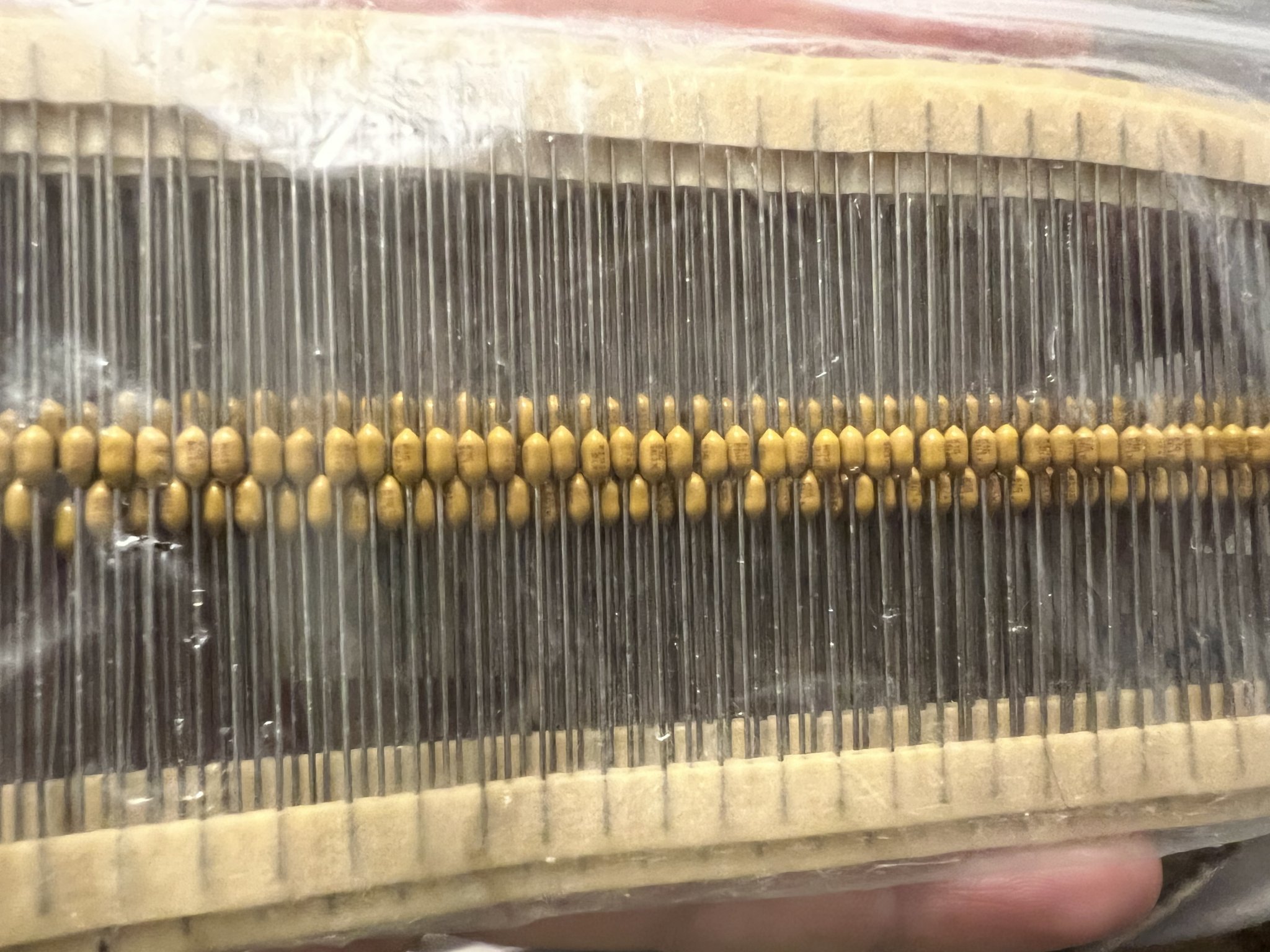

I have a whole bunch of these ceramic 560pF 100v capacitors, two in series would yield me 280pF 200v. That’s pretty darn close to the 270pF. Or would it be best to use the silver mica?

I usually use mica for this kind of thing, but MKP (metallized polypropylene should be just as good here. It's AF, not RF. The general rule is use anything but a cheap ceramic disc cap (even if the original design had one -- upgrade it). Others can surely correct me if I'm mistaken.
Awesome info, I’ll keep looking, otherwise use the 330pF silver mica I have.I usually use mica for this kind of thing, but MKP (metallized polypropylene should be just as good here. It's AF, not RF. The general rule is use anything but a cheap ceramic disc cap (even if the original design had one -- upgrade it). Others can surely correct me if I'm mistaken.
Dan
They are to prevent oscillation, but not “snubbers”. They are basic lag compensation and the pF value should be respected. 280 pF is close enough, with 330 the open loop pole will be lower and you lose HF capability and compromise slew rate. 220 and you may risk oscillation. I tend to use micas in those positions because of the voltage swing, and the couple ohms of ESR isn’t the end of the world. Especially with the resistor in series.
