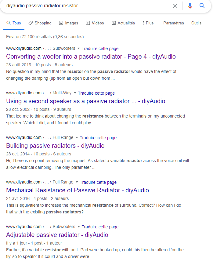

Please bear with me here all. I have a pair of JBL 2269 I want to build a pair of subs with. From what I've gathered here and elsewhere is that BR and PR designs can be made to behave identically in terms of final result with a given driver, in this case the 2269.
I've discovered that shorting the driver's + and - connections with a piece of wire causes the vc to seize in the gap. This can help protect it during transport. So I'm wondering if the strength of this counter force can be varied by using a resistor instead of a wire? Further, if a variable resistor with an L-Pad were hooked up, could this then be altered 'on the fly' so to speak? If it could and a driver were substituted for a PR incorporating this system and applied to a BR box instead of a port, could the tuning be tailored for best response in a particular room with the L-Pad while listening?
If this is possible, the substitute driver/PR would not need to be an identical match to the driver making sound, and therefore cost effective, right?

My real question here is if this could work, could this method then be useful in tuning the sub to precisely match the requirements of the room for best performance? Does the room have any influence in dictating the best tuning of a BR cab? Does not electronic room correction effectively alter the tuning?

You ask about precise tuning. Adjustment of the quantity of O/P is facilitated by the adjustable R placed across the passives terminals, but the frequency at which the passive operates will remain the same.
The quantity adjustment may allow better room matching, but won't affect eigentone frequencies separately from other frequencies. Peaks and troughs will all be affected, increased or decreased.
Even though the R does 'stiffen' the compliance of the passive, I don't think it changes the resonant frequency, and it results in a loss of energy converted to heat in the R.
An ABR is quite a wide band device, more so than a port.
Think you are absolutely right .... bit stupid of me .... resistors do not change frequency, they dampen 😉
