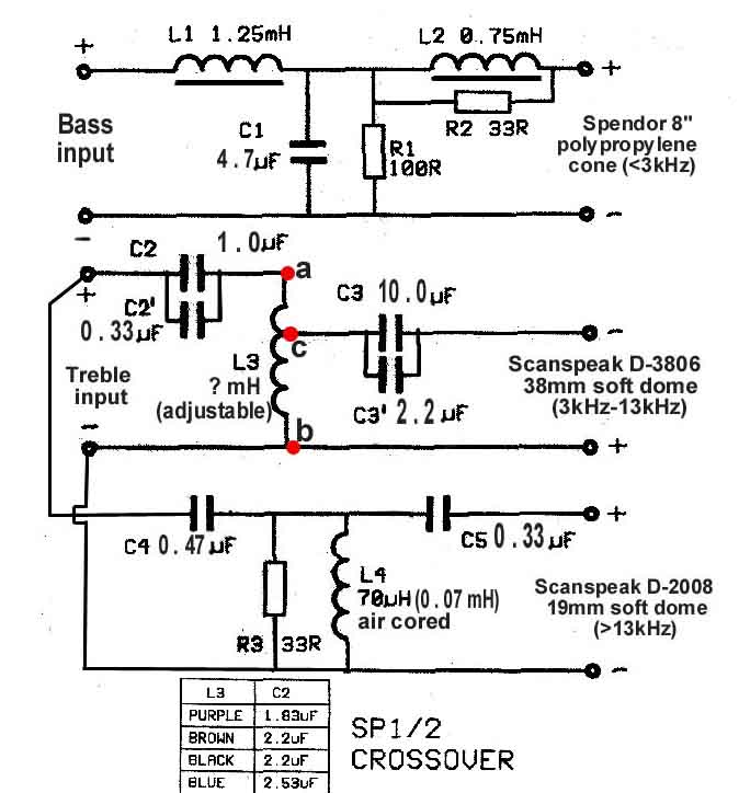

Hi all
This is the schematic of the crossover of my Spendor SP-1/2E loudspeakers. I’m going to build a new crossover with better parts to compare with the original, maintaining all the same values. I’m sure the sound quality will improve but, if not, I always can reinstall the original and only hardwire the drivers with a better cable.
The capacitors will be ClarityCap SA in L & R matched pairs (a little more expensive than Solen but, according to many opinions, much better sounding). I know that there is a problem when replacing bipolar electrolytics in the mid-treble section with film caps that pass more signal, but, as the original capacitors are already film caps (polyester), I think the ESR of the new polypropylene ones will be very similar, and the HF output will maintain its original balance with the LF.
The resistors will be1% non-inductive wirewound Mills MRA-12 and all the four inductors air-cored Solen or Goertz (I don’t know yet) with the same L and DCR values as the originals. I believe Spendor uses an adjustable inductor (L3 in the picture), and not resistors, to set the signal level to the main HF driver and to achieve a L & R pair matching within 1 dB, even if there are slight differences in the responses of each individual Scanspeak D-3806 units. The C2 capacitor value is also modified according the table (however, in my case the value is 1.0 + 0.33= 1.33uF). My doubt is how to measure this L3 adjustable inductor and which air-cored coil or coils to use it its place, so these are my questions:

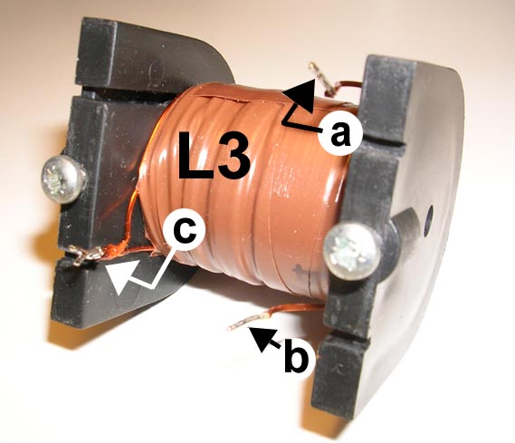

1) Is the adjustable L3 inductor like having two inductors, the wire between “a” and “c” in series with signal and the wire between “c” and “b” in parallel? (please, see the schematic and the photo attached to this post)
2) If so, I’d have to measure L and DCR between points “a” and “c” and “c” and “b”?
3) To replace L3 is it necessary to use two inductors of these L and DCR values, one in series between C2 and C3 and the other from point “c” to (-) input?
This is the main doubt I have in this upgrading project although, in any case, I could use in it the original standard L3 coil. However, I’d be very grateful if you could help me in sorting this problem.
Thanks in advance

Although I am not familiar with this particular inductor, from what you say here I think that you have got this quite right where your suggested connections are concerned.
I am uncertain quite what is 'adjustable' about the inductor, itself, as those adjustable inductors which I have made for myself have had several different 'taps' on the coils, so that one can vary the inductance of the 2 'legs' of this circuit.
In this case, from what is shown here you are right in that to replicate the effect of this dual arrangement as closely as possible using 2 separate inductors, you should try to match both legs for inductance and DCR. If you can then locate them (in use) with one inductor sitting right next to the other (oriented as this original 'dual' device is now) you should be very close to the original performance here, as moving the 2 inductors apart will have some small effect on their inductances in my experience due to inductive-coupling between the 2 parts.

L3 is a classic autotransformer achieving simultaneous crossover and attenuation functions in the one component.It's a time honoured tradition with the BBC speaker designs dating back to the 60's and one that Spendor and Harbeth often used in their BBC derived models.Some believe it is subjectively superior to conventional inductor/resistor high pass filters.
The autotransformer as such is not adjustable in this circuit- it doesn't have additional tappings.However by selecting the value of the input side capacitor C2 Spendor was able to match the crossover to different D3806 tweeter sensitivities.These were colour coded after measurement(purple,brown etc)and the appropriate value of C2 (1.83-2.53 uF)selected from the chart to achieve close matching at the crossover point.It would be difficult to duplicate this arrangement using conventional inductors. The crossover frequency and attenuation level would most likely end up quite different to the original design intentions.
eanee's contribution here is very useful, and he appears to be familiar with Spencer Hughes' designs, which is something I earlier admitted I am not.
It also clarifies why I suggested that this isn't exactly an "adjustable" inductor, but I assumed that this term came from Spendor as it was shown on the schematic. Normally, anything adjustable in this context would be made in the manner I suggested, with multiple taps.
These helpful comments also reinforce my views that you might not end up with a very satisfactory result when replacing this device with separate inductors, mainly for the reasons I referred to before. Depending on just how the windings are arranged on this autoformer (which I am familiar with in audio amplitude/volume controls, but not in speakers) there will be some inevitable 'interaction' between the two parts making up the device, and, knowing Spendor's reputation, this will have been carefully 'exploited' in the whole scheme of things to end up with the desired sonic results.
