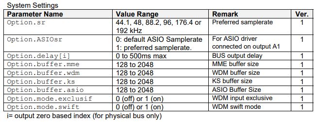

Is there a way to adjust system wide audio buffer size using DirectSound in Win10?
[System Audio]->EAPO (equalizer APO) ->USB asynch DAC
ASIO drivers support larger buffers that can avoid audio dropouts, but I'm hoping there's a way to do this (3rd party utility, generic USB audio driver?) when using directsound. It probably has to be USB driver based since the dropouts occur when the DAC buffer underflows.

Have you tried VB-Audio's Voicemeeter (BANANA) ? It integrates with EqualizerAPO (if you mean this software by acronym "EAPO").
No kidding. 🙂 Thanks for the great suggestion, I had no idea Voicemeeter supported adjustable buffers. I'll have to give it a shot.
