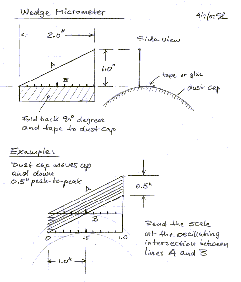

As for the woofer, it rumbles very well, especially being powered by the Crown MacroTech 5000vz. However, I was able to overload it by turning the volume a bit too high. 34 mm one way excursion my ***!
The excursion is there... Measure it...
These ain't like some junk mainstream speakers T/S Params are
not "guessed" at.
