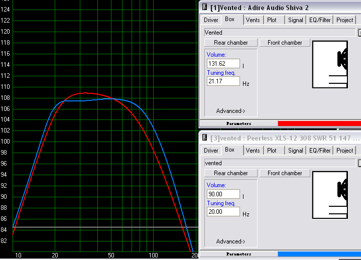

IMO the XLS is better value than the Shiva in Australia. Contrary to popular belief it can work quite well in a vented box and achieve SPL and extension to match the Shiva. The following plot shows the XLS (blue) vs the Shiva. The XLS has a smaller box (90L which is large for this driver) than the Shiva which is in a 130L box.
XLS you can get for $220 in Australia compared to $300 for the Shiva.
The downside is that the XLS needs more power, but this is due to the smaller box, such is the nature of tradeoffs.
Note: I realised after making this chart that the Shiva was shown without using all of its excursion. With 250 watts it has a little more output than shown ~ 2.5db more, while being about the same at 20 Hz. The XLS is using 350w in that chart.
Note 2) I don't necessarily recommond this exact size for XLS, it's just a quick indication of this driver as a viable alternative. As far as I'm aware, the XLS has lower distortion in the mid to upper bass, which is where distortion perception is apparently more acute. The XLS is also better quality construction.
