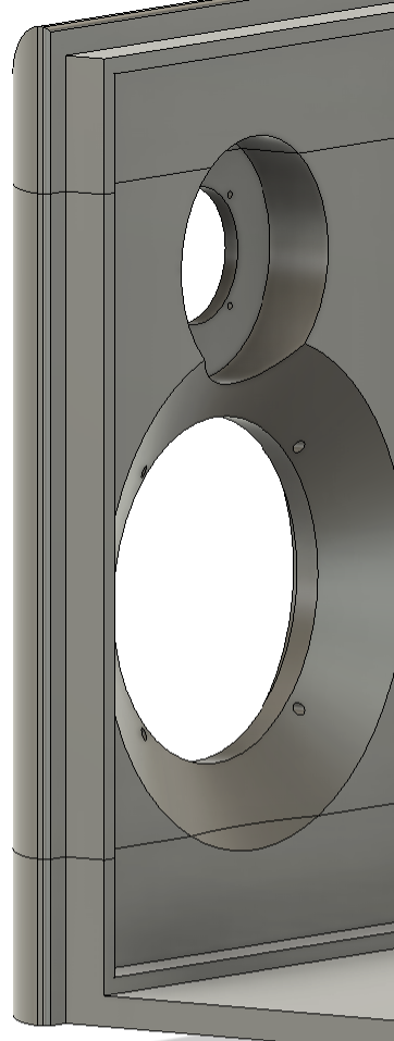

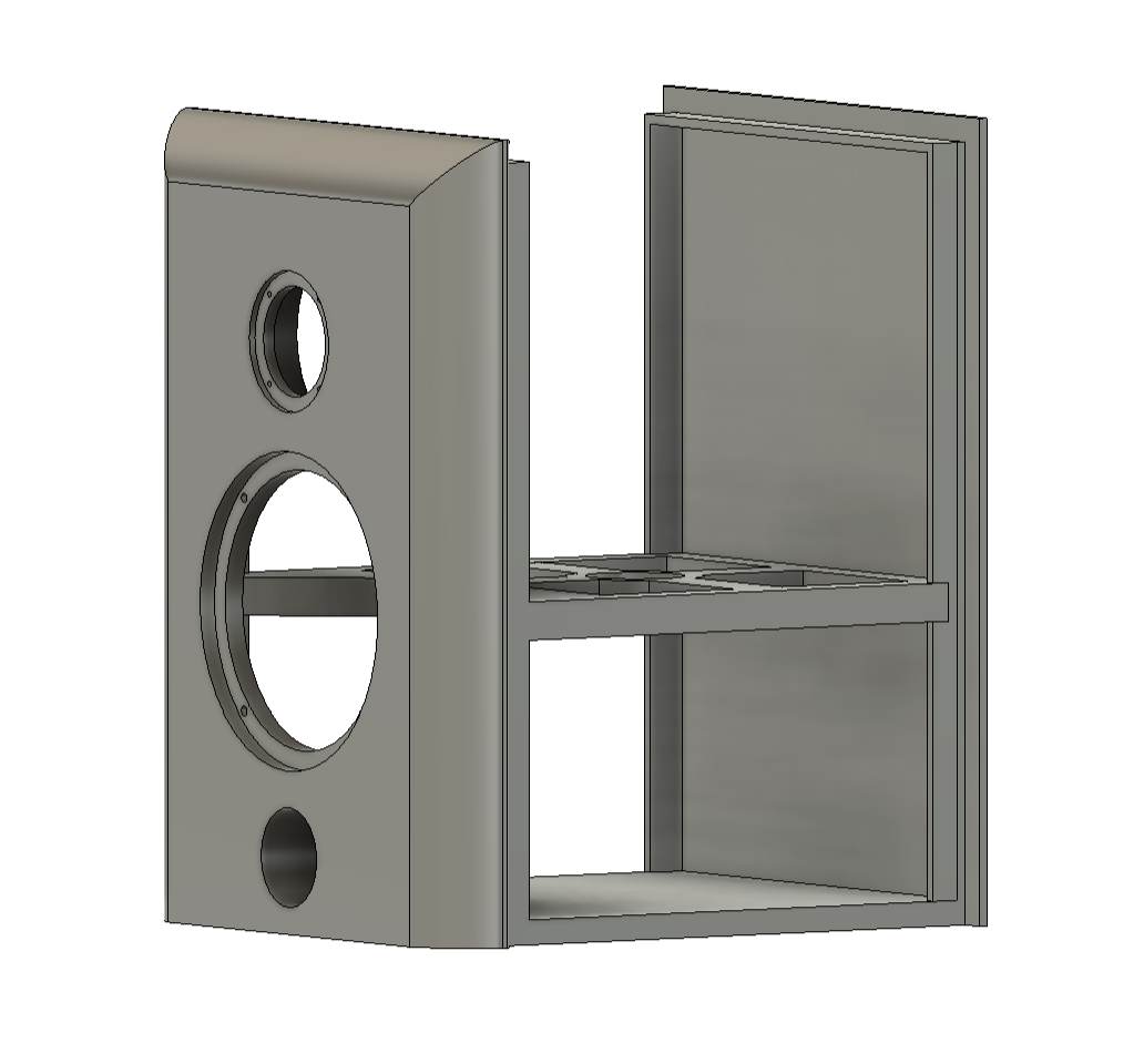

The drawing in the attachment shows the baffle with the rabbet joint. The wood side panels will be adhered to the baffle on the end grain and to 20mm of the inside face. The wood I'm using for the first pair is 1/2 inch prefinished BB.
Construction adhesive should be strong enough but I would prefer something thinner. Epoxy glue? Maybe there's something I'm not aware of?

Since it’s the end grain, you either want an expanding glue like PU (gorilla) or slow setting epoxy that has time to penetrate. With epoxy you would normally pursue a two stage gluing process: first coat both sides with straight epoxy, wait, then mix in some filler and coat again before assembling. Whether PU glue will adhere to your 3d printed part is best determined through testing on some expendable part made from the same filament. PU glue is cheaper and easier to handle than epoxy, but it cannot fill gaps. Also, PU streaks can only be removed mechanically because nothing that you would want to handle dissolves this stuff. Epoxy can be wiped off with alcohol or white spirit while still wet. PU glue needs clamping, for epoxy you only need to secure the pieces until cured.

There are available on the net lists of plastic materials and the ease of use of adhesives with those.
Cross match with acoustic proprties, then make the part.
Some common plastics are notorious for poor sticking of anything.
I would recomend ABS, suitable for adhesion, and contains synthetic rubber, so decent acoustic properties.

Thanks. I'm quickly losing interest in printing speakers after 24hrs to print one baffle for a trial run - I split up the body to fit in my printer. The speaker is about 250x290x420mm and the Elegoo Neptune max has enough print volume to print the entire piece but the print time is over 7days. Also finish work would needed to make the front baffle look nicer..
Thanks for suggestions. I'll probably build one pair with the 3d printed baffles but then I'll be done with it, then stick with all wood only..

Why not use acrylic for the baffle? cast acrylic is denser and better suited for a baffle than filament. Use the printer for the dispersion profile and to achieve the flush mount look. Same look with similar sonics but much less print time since the bulk is already there.

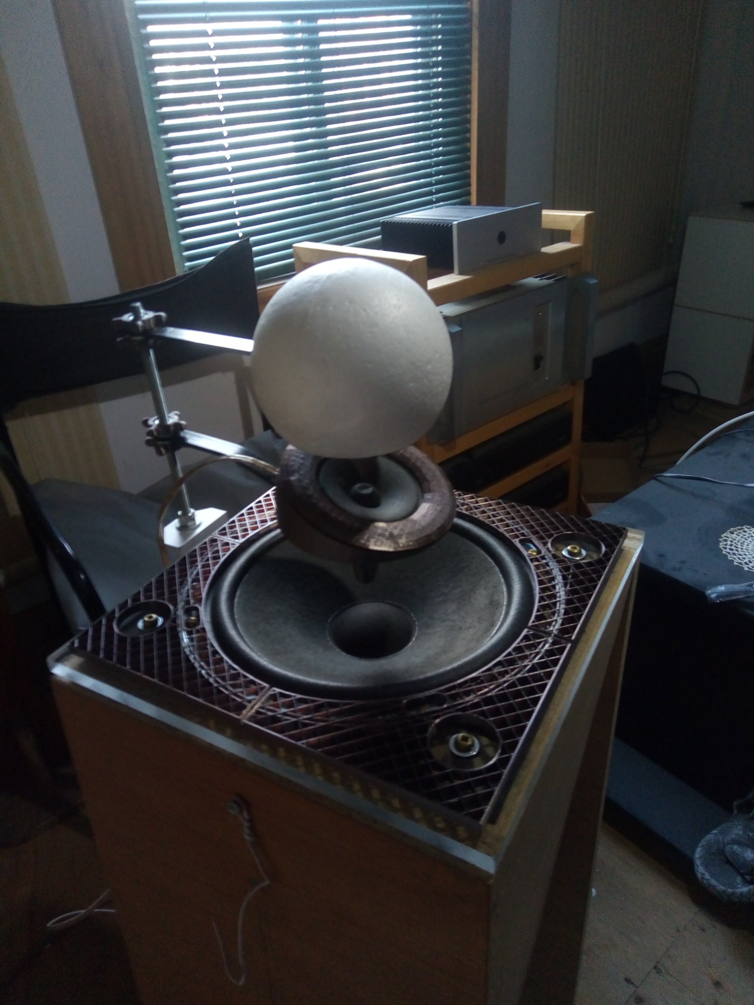

For the adhesive, I'd use melamine PVA. Stuff is designed to stick to glossy, non-porous materials, and of course, wood. Dries flexible, like a stiff silicone. Like all PVAs, it shrinks as it dries so you'll want to add a 2nd coat (especially to the end grain) before mating the 2 pieces. I guarantee you won't be able to separate them after bonding and curing.
Picture below is different from what you're doing but similar enough to post here. It's an omni in a folded Voigt pipe. Baffle is 10mm acrylic covered with a 6mm diffuser 3d printed with 10% infill, no top or bottom. Driver is adhered with the PVA mentioned above to ensure total damping of the pressed steel rim. Baffle itself is isolated from the wood enclosure using foam weather stripping and is held down with screws, metal and rubber washers to minimise mechanical coupling.

Prepped surfaces and plain old 2 part epoxy.
