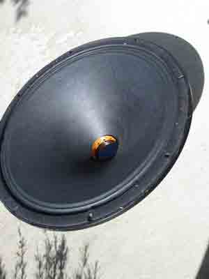

Hello,
I am replacing the original aluminum dust cap in an old Altec 600B driver (paper cone) with a felt one I acquired locally. I cut away the aluminum cap and left a small rim at the original glue line as you can see here:
The nice fellow I got the dust cap from suggested that I use Elmer's glue, but I thought I might ask here to see if anyone had another suggestion (I don't know how well I can expect Elmer's to adhere to the old adhesive/aluminum rim).
I know I've seen online companies sell repackaged "special" glue for this purpose, but I would imagine an appropriate adhesive is generally available without buying it from a speaker company. Maybe gorilla glue?
Thanks for any suggestions you can offer me on this.

I'm posting a followup to this message. I did a test of some wood glue on the old aluminum dust cap, and I was able to peel it off after it dried.
After doing some research online, I came across a suggestion to use an adhesive called "E-6000", so I will pick some of that up locally today and do a little test with that product.

You know, Joe, I wouldn't have thought people would run a driver without a dust cap, but after doing some reading about drivers on this site it seems that there are people who do just that! Apparently, some high-end guitar amp speakers make an attempt to approach this by using the thin "screen" type dust caps.
In any case, since this was all I have right now, I stuck it on with the E6000 product, and it is still curing (takes a few days to fully set up).

Aye, it was indeed a very thin piece of aluminum, which was likely what lead to it's demise (it had a tear in it). I harvested this driver from an old Baldwin organ tone cabinet, where the speaker was on the top, pointing up. The grill cloth was torn, so I'm guessing someone used the cabinet as a table at some point, and the inevitable occurred.
I am going to use this for a low-watt guitar amp I am building, so hopefully the felt cone will still work (my ear is not trained to be very discerning in these matters).

Hey thanks Joe, I appreciate it. It didn't turn out looking very good, but this was my first time cutting into a speaker, and I learned a lot.
I was pretty nervous about the procedure, but now that I've gotten my feet wet it really isn't all that difficult, and if I decide in the future to play around with the driver it won't be too hard to cut out this dust cap and play around with other options.
I like the "set" of the E6000 adhesive, as it is really thick and stays in place without running. I still have to let it set up for a few more days before I plug it in, but here is how it turned out:
It's not going to win any beauty contests, but I'm happy enough with the results.

That is not what I was thinking by a felt dustcap. That is more like a standard paper dustcap.
Either way, should be fine, especially for guitar use. The 600B is a stout speaker and won't easily break up into a buzzsaw tone like an old small magnet Jensen, but it will sound good.
Hey thanks Joe, I appreciate it! You're probably right about the cap being paper, I was thinking it was felt that had been treated to be really stiff, but it's probably way too stiff to be felt.
It might not be optimal, but it's going to sound a lot better than the noise that the aluminum one made with the little tear in it!

Hey thanks Gerald, I appreciate that!
It did indeed sound horrible with the little tear in the original aluminum cap. When I heard that noise, I was convinced that it was the voice coil rubbing inside and tearing itself to pieces; that was a few years ago and I pretty much gave it up as a lost cause.
I fired the speaker up earlier this evening to test, connected to a Stromberg-Carlson AU-34 PA amp, and it sounded GREAT! No more horrible noise; it sounded just like a speaker should.
