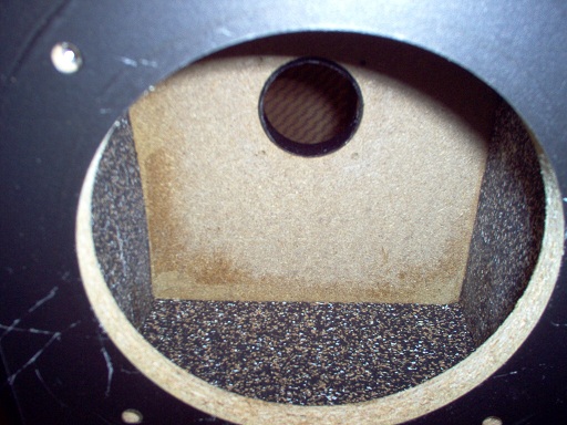

You can improve cabinets with panel damping by sticking rubbery stuff to the side and top panels:
http://www.diyaudio.com/forums/multi-way/223174-interesting-read-i-found-lossy-cabinet-designs-harbeth.html#post3234256
Volume damping is all about the fluffy lighter stuff. TBH, it only does something above 3kHz. With reflex, eggcrate lining foam is a good thing too. Works much the same.
