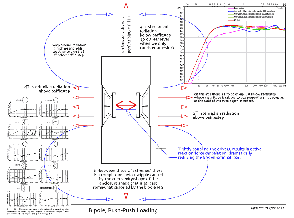

Very heavy drivers forward and back movement can cause a lightweight cabinet to shake, and that shaking may be out of phase with the driver's output. If the weight is sufficient to stop the cabinet movement, it can increase output level and smooth the frequency response.I have some plate steel sitting around doing nothing. I could add it to the bottom of the cabinet but does that actually make a difference?
Adding mass won't hurt anything, but probably won't have much effect either.
OK, seems like it isn't worth my time at this point. If anything, I can weld up some stupid heavy stands later that will mount to the bottom and add some character, and weight, to the build
In principle it's called Conservation of Momentum (mass*velocity) and m1*v1=m2*v2. So if a cone of mass m1 moves (impulse) at velocity v1 against an infinitely rigid cabinet of mass m2, that cabinet will move at v2. If the mass m2 of the cabinet is increased by 2, then its reaction to the same cone movement is reduced by 1/2...
Heavy as in the moving mass. And this will be a woofer. The elegant way to deal with this is active reaction force cancelation, ie push-push driver mounting.
Adding weight could be counterproductive in that more mass without added stiffness coulod move panelresonances to where they can be excited.
