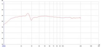

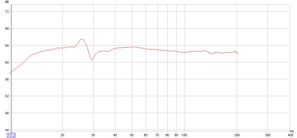

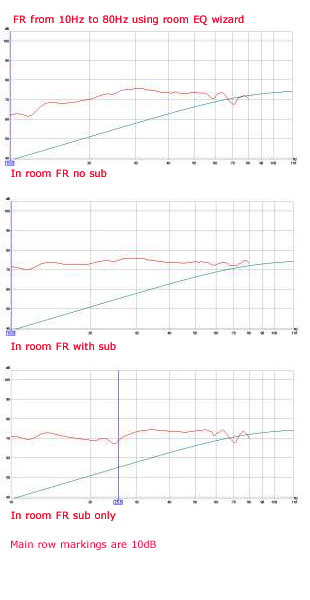

I have attached the FR graphs I did yesterday (and posted into the wrong thread...🙄 )
The current sub doesn't do the reproduction any favours - it's crossed at 90 but and the new sub (s) would be crossed lower down so be less likely to mess up imaging. The thing my speakers do really well is accurate imaging so that's a primary consideration. I would have thought that stereo subs would be better for imaging but I expect it's more complicated than that.

Crossing at 90Hz is far too high if your mains go down as low as you claim they do. A single sub will be fine crossed below 60Hz, I'd say higher than 60Hz is possible without too much bother either, but there are other uses that will dispute that.
I can't really make out the scale numbers on the graphs to comment.

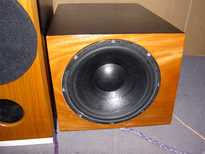

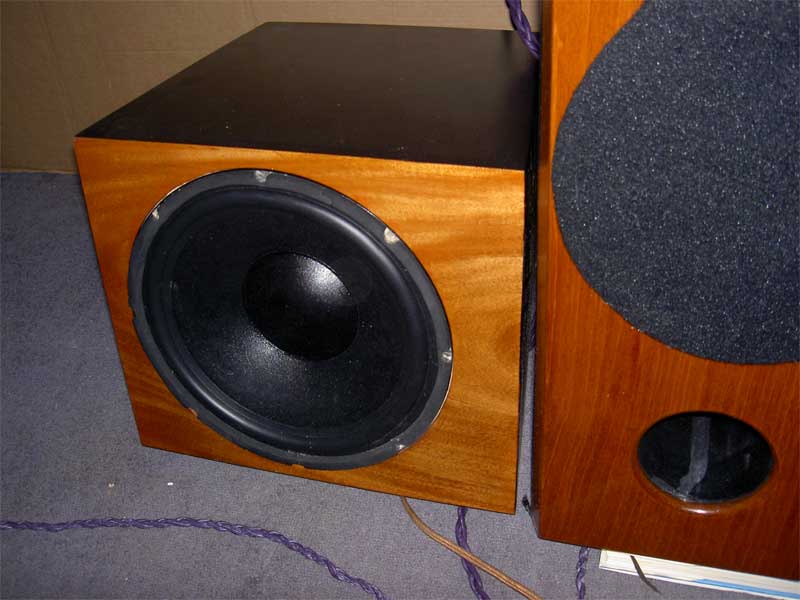

So, I knocked up a couple of subs using the wharfedale 12s from my HT sub (it was bare MDF and didn't really warrant finishing)
I'm running them from a 60w PA amp which is fine for their location.
I'm using a variable electronic crossover from a car which is wired into the HF line input from my preamp (bi-amped speakers)
They sound OK actually, fairly warm but the box needs a bit more structural damping - I may cover the boxes with 10mm cork sheet.
I did a design I have used in cars before - a very small box, heavy stuffing and a rear port (tuned to 30Hz). The boxes have 2 angled sides and angled internal bracing.
I still have to make the gaskets which is why there is a small gap round the speaker cutout.
My first go at veneering too 🙂
