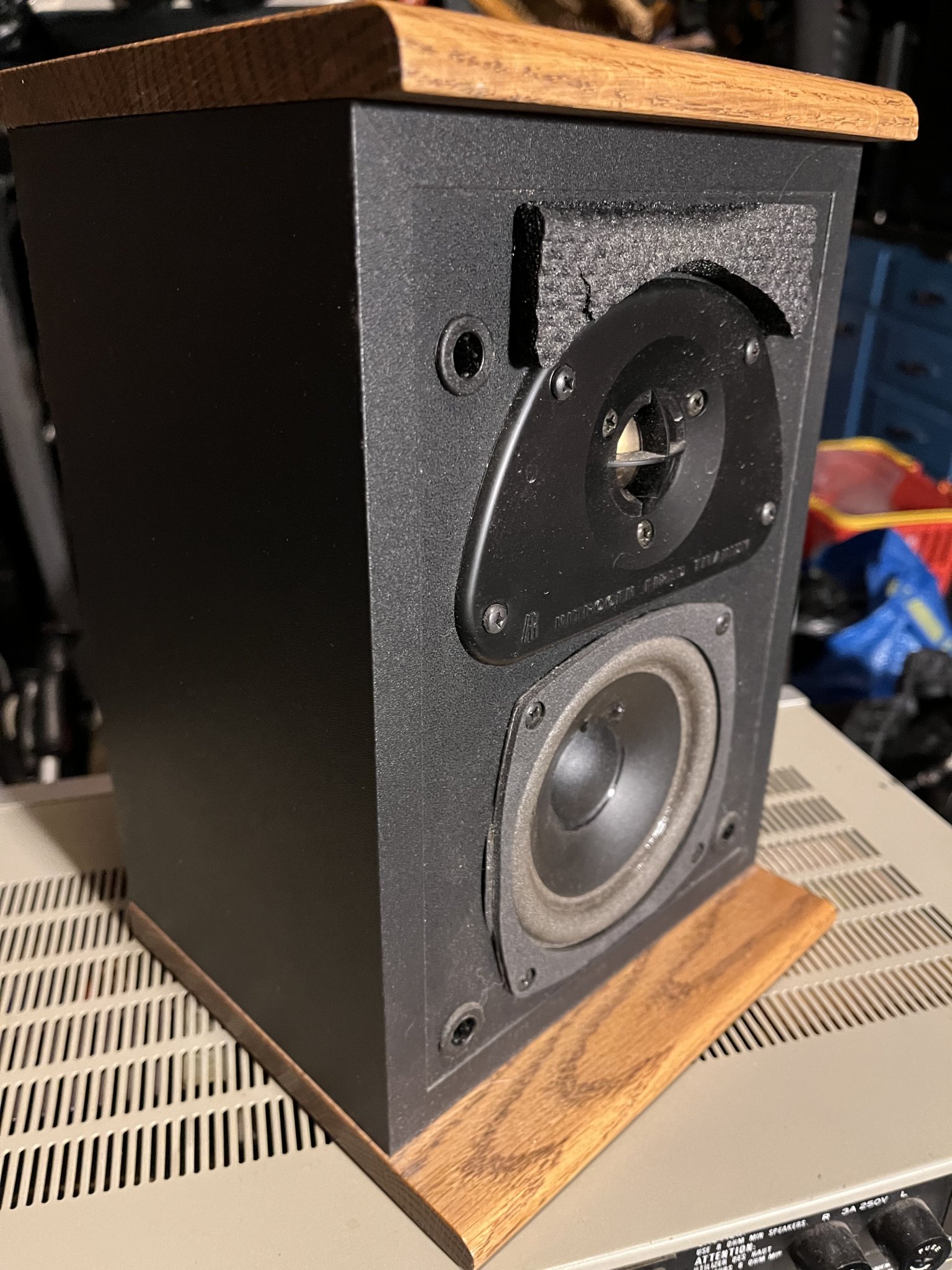

I have a pair of Acoustic Research bookshelf speakers with voice coil rub so am going to replace the drivers using speakers from a set of Definitive Technology 5.1 speakers. However, the AR cabs are sealed and twice the size of the DT satellites. The satellites also have a single passive radiator the same size as their driver in each. I’d like to add the PR to the larger cabinets. Most research that I’ve done shows PRs being twice the size of the driver, so should I add 2 to each cabinet?
I haven’t checked the specs in the speakers, but where’s the fun in replacing with the same on this page? I like the idea of PR or 2 (which is different than a port or vent) and since I don’t have any measuring equipment or experience yet, this will just be by ear. I’ll compare the new builds to these pictures as reference. I’ll also try without the sub for full signal test.

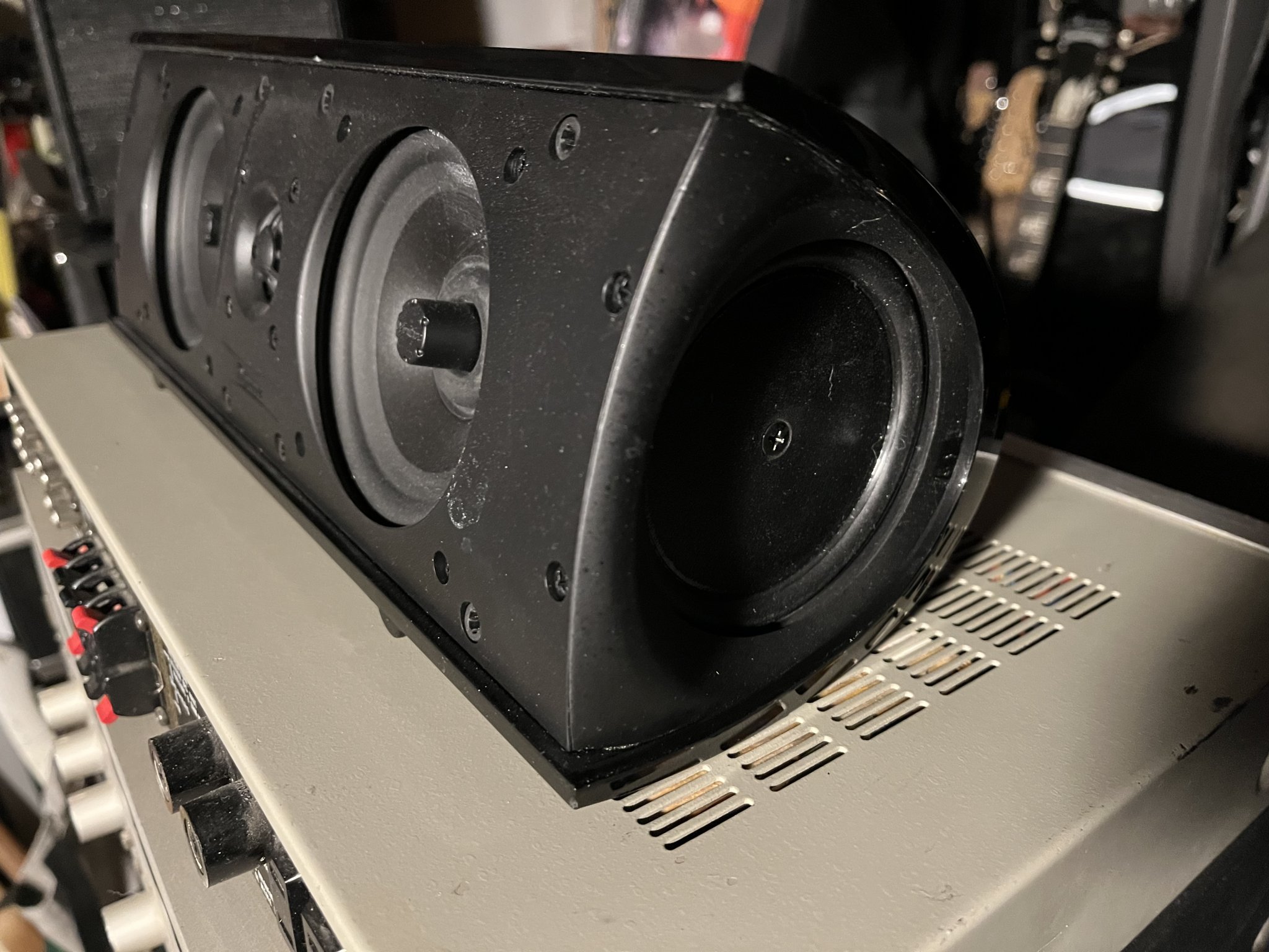

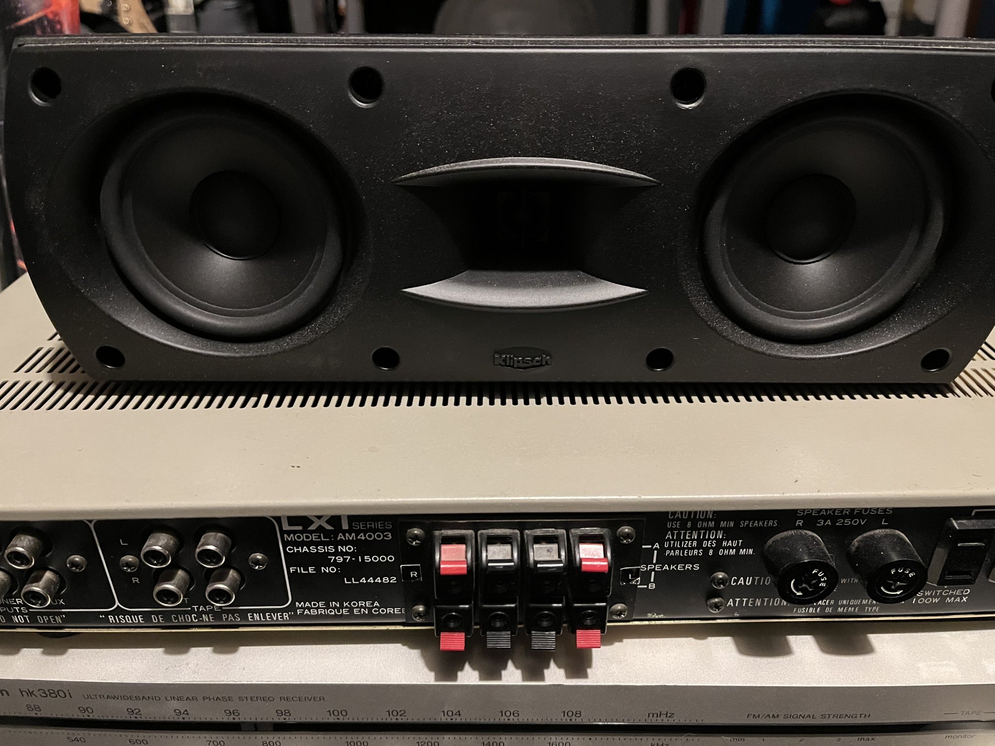

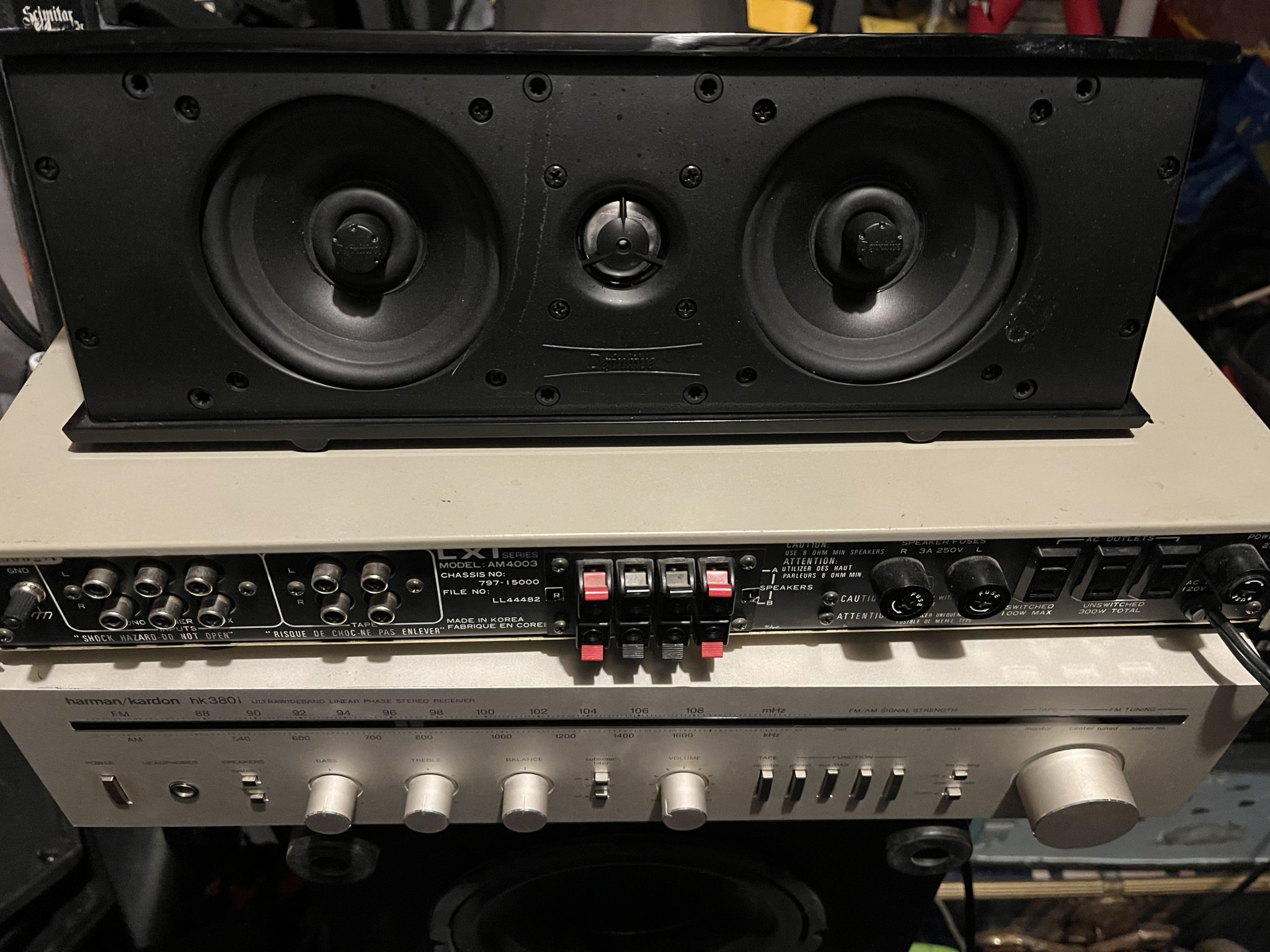

These are my speakers. The AR cabinet is larger than the single driver satellite speaker. I’m going to scavenge the centre channel speaker as it has 2 drivers and 2 PRs but the cab they’re coming out of is smaller and the rest of the satellites are half the size with a PR firing up. So I’ll be putting at least 1 PR in each of the larger AR cabs with the scavenged driver.
So first I’ll try it without the PR, just the driver, then I’ll add 1 PR to just the left speaker, then I’ll add the second PR. So my only real dilemma was, do I put the PRs on one side asymmetrically or do I put one on each for a balanced look? But I just found a Klipsch 5.1 system with the same size drivers that are sealed, so I could bypass this PR issue all together, but where’s the fun in that
