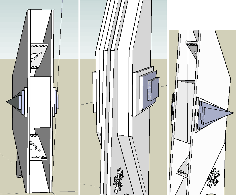

MDF is a poor starting point, find some quality plywood. Adding something like an Al skin, if used with the right glue should inprove performance. It should also be done inside from a structural point of view and like the first 2 pictures not end up going the wrong way.
The key here is that these materials (ie thin) increase the number of plies in the plywood you are using, increasing stiffness (at least in theory)

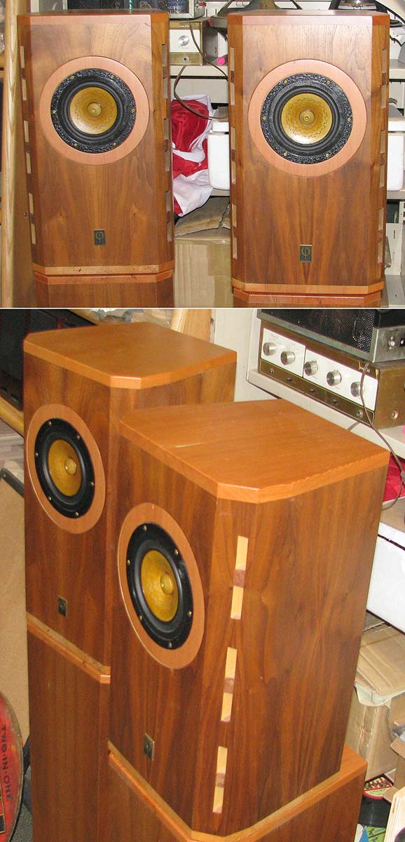

Despina another one to do aproper drawing of… simpleReflex, properly dran up. The first gives a better chance to adjust damoping to room and taste, and would be y personal pick (except that ego would push me more towards here:

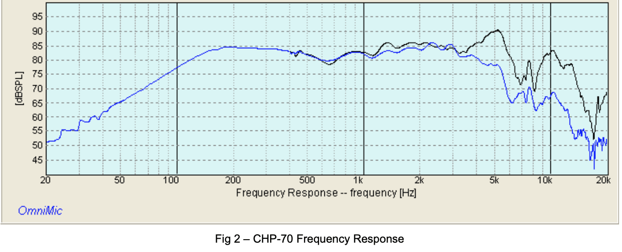

While the last bit can certainly be true, note that the CHP-70.2 has a top end mant to be vintage but they only managed to have a driver down 10 dB above 5kHz, with a significant rise just before the plunge. Most people miss the top, but those that do not love the driver. They do not have the same bass potential as A10p. It fits in smaller boxes.
Coincidentally i have 1 pair left CHP-70.2eN that both does the no top end trick and the reveal if what proceedsis not great trick .

As long as the bit of bighr just before the cliff hits a nerve. But that can fairly easily be partially smoothed. Its about a 6 dB bump before a plunge, it is the abrupt change that can be disconcerting. The article i pinched that from (attached) is quite insightful. The CHBW-70 is 5dB steeper.very simila but that pluhge is about. The blue bit is his measurement with a passive added to it.

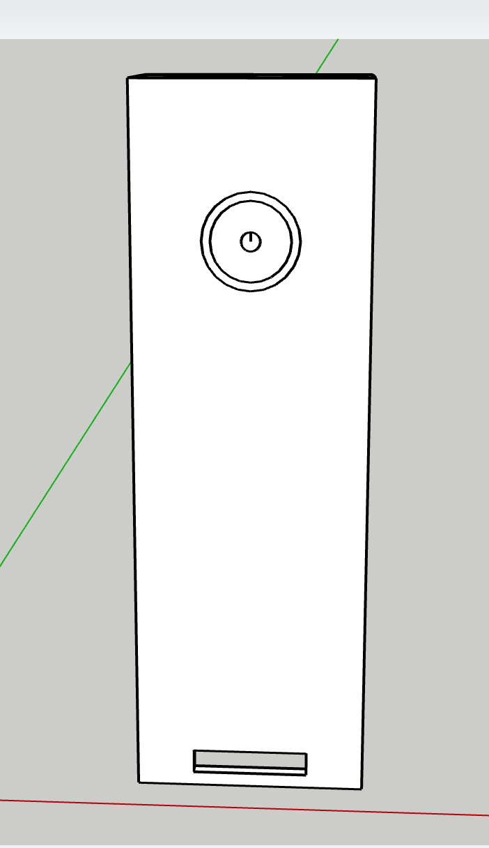

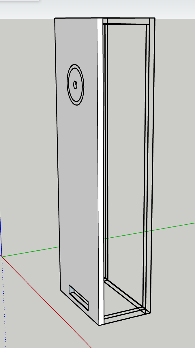

On the basis of your last message, I just had a play around. Figured the pensil turned sideways – with the driver and the outlet on what was the side face rather than the front – might give some nice proportions. I know increasing the baffle width will mean diffraction of a wider frequency range, but I'm thinking that might be compensated for by the already diminished highs on the driver?
I mocked it up in sketchup. Would be great to hear what you think?
