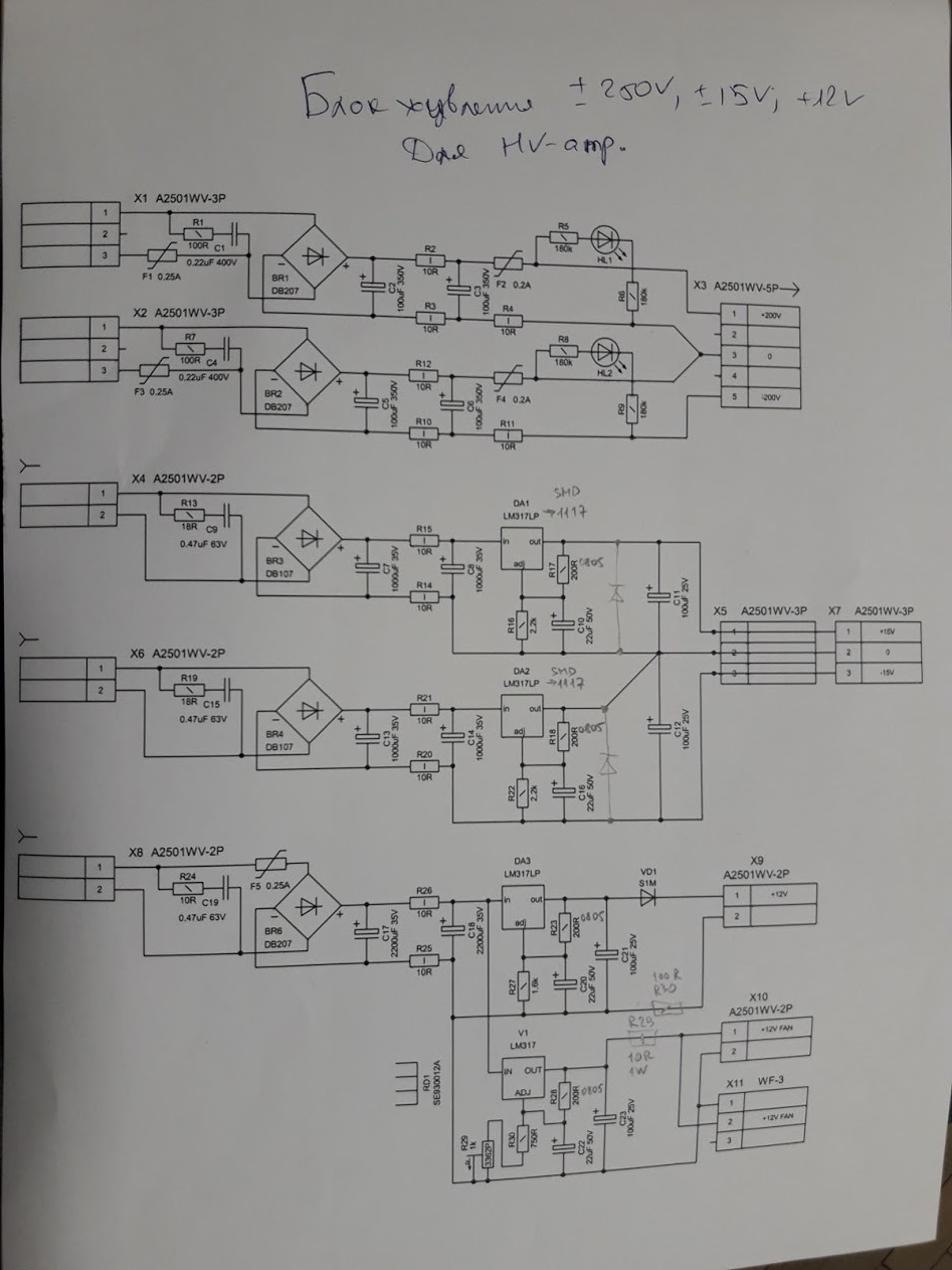

I agree with previous - it isn't just a "without them" problem. I am 99% sure it is design (construction) problem and so on.
Almost all my designs are "without them" - I prefer to use RC-snubbers in rectifiers instead of, and I haven't had such a problem.
So, such a soldering iron is a good multi-functional unit to perform reliability and general design tests, so keep it and use widely. 🙂
Here is an example of one of my rectifier boards (for soviet Г3-118 low-distortion generator):
You can see orange 0.560 uF x 63V film caps, but they are at the input of rectifiers. And there are SMD-resistors under the circuit board connected in series with them.
