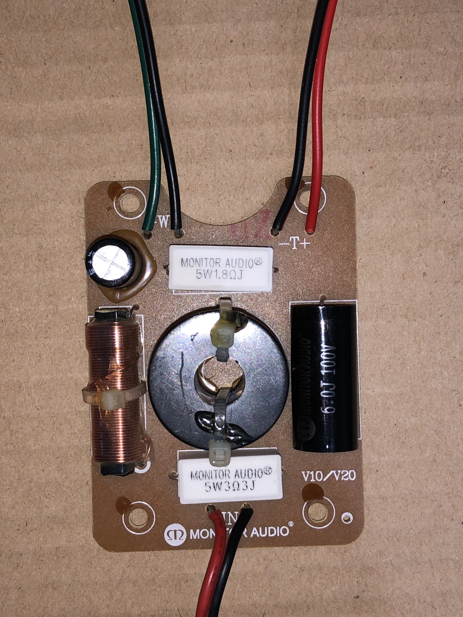

I am going to build some new enclosures for my Monitor Audio Vectors V10 and V20 speakers
I have 2 of the Vector V20 centre speakers and would like to combine them into one. Can I just wire them in parallel on the crossover or will I need to change some components?

I have added the pictures of the Woofer, Tweeter and Crossover.

The xover would need to change the values due to the different ohm load and if they were designed properly to start with changing the enclosure will effect it as well... pretty much need to completely redesign the xover.
For the amount of hassle your going to go through to redesign completely I dont think your going to gain much extra by doing this, Id sell what you have and invest in a better/bigger center speaker... may build a kit one or something if your keen on DIYíng it
You can halve the inductance and resistance values and double the capacitance.
The drivers will interact with each other, this can make unexpected changes.
Thanks for your replies guys. It seems it will be more of a ball ache trying to achieve what I want to do without having the correct testing equipment and knowing values etc. I have sent Monitor Audio an email to see what they say. They are pretty good at getting back with information as I have found in the past. I could probably wire both the speakers in parallel or series as my receiver can handle 4-16 ohms.

The halving and doubling is exact enough that you can just go ahead and do it. It's the idea of running multiple tweeters and similar effects that are uncertain but I'm sure for the average person it's perfectly acceptable.

I am looking at now running them in series as opposed to parallel. From my understanding, correct me if I am wrong. 16ohms is better than 4ohms as the amp doesn't have to work as hard. The receiver can run 4-16ohms.

Yes, lower current is usually lower distortion, IF you have sufficient voltage for the desired wattage.

To be honest the real reason I want to do this is so I don't have a speaker knocking about not being used (bit OCD). I want to make wooden enclosures instead of having the original plastic enclosures, so they look better and hopefully sound better. The wooden enclosures will have virtually the same internal volume so they will still be in design spec and shouldn't degrade the sound.
There is that I suppose. I built a custom wooden enclosure for the V20 centre a while ago (which sounded great). I spoke to one of the technical guys at Monitor Audio to get the internal volume so built it from that. I think it was 7.5 litres.You are asuming they used an optimal box design for performance not for marketing. 😈
