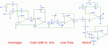

I am thinking of adding in a Sub output coming from my gainclone amplifier. Do I simply sum the L and R inputs with a simple opamp circuit?

Use a mixer with Low pass filter
There are lots of Mixer designs on the net. They use summing into an opamp. Just add a low pass filter network on the front end of the mixer and voila you have your mono LOW only output for a Sub amp. For example (but not inluding the lowpass stuff)

I want to sum the channels so taht I get both L and R coming out of the single sub
The notch is because of the resonance that occours due to the 'D' from the front radiating area to the back. It will create a peak at 290 Hz with the enclosure that I am using.

PaulHilgeman said:I want to sum the channels so taht I get both L and R coming out of the single sub

Yes, what you need is a circuit that mixes both channels and puts a low pass filter to leave out everything that is not los frequency.
You do that before going into the power amp, of course, and you use just one amp as I think you know, and you do this crossover after the preamp or source output.
Why do you want to create a peak?

Low pass pole at 100 hz or lower for Sub
Make the pole of your Low pass filter at 100 Hz or lower for a sub and then you will have no problems at 290 Hz. It will simply not be there. 290 Hz is not in the realm of sub-bass. Hell its not even bass really. It s low midrange. Kill it.

Yes, that is true, but this is only a 12dB/ octave low pass XO. If you cross out at 100Hz, that dosnt mean that everything above there is just gone. So if there is a 6dB peak at 290Hz, it will only be about 8 or 9 dB below reference due to the 12dB/octave 100hz XO.
That is why I need the notch.
