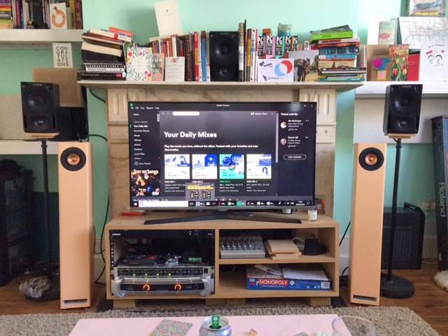

Hi all,
I've recently built a couple of Woden Designs Sasquatch full range with some great help and support from Dave, Chris and Scott:
http://www.diyaudio.com/forums/full-range/317942-alpair-6m-cyburgs-needle-br-design.html
These sound good but I still need to tweak. What I planned for these drivers was versatility so I could use them for a few projects (mains, surrounds and multi way - MLTL and BR). One I'd like to try is to use this as mid bass and add a tweeter to get a wider stereo stage.
I'm thinking about ribbon tweeters and don't have too much to spend. About £150. I have a Behringer active crossover rack unit which I will use for the crossover before I progress to making as passive crossover.
Which tweeters would pair well with this driver? I have found two that look like likely candidates but I am new to multi range so I am not aware of the immediate pitfalls of driver selection. If there is an article someone can recommend then great. If someone can shed a bit of light even better.
Fountek Ribbon NeoCD 3.5H Size 110x98mm
Monacor RBT-35SR Size 110x98mm
I plan to place them on top of the Alpairs MLTL in free air. Would there be an issue with this?
Any advice would be great, thanks!

HI, thanks for your input. Sorry, I should have been more explicit. I intend to use these drivers to learn various different methods of speaker design. Also, I really like the Alpairs but they don't make for good listening for more than 1 person so I thought adding a tweeter would make things wider.
I would like to learn how crossovers and tweeter integration works.
I have tried several positions for the MLTLs and the position in the photos is not the best one I have found so I am confident I have got them in the best position for imaging.

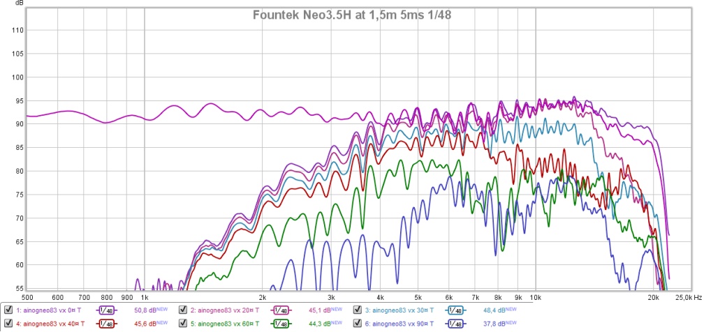

I have used the Fountek 3.5H version myself. It has nice sound but dispersion is so narrow that it is good only for the person in the spot.
Matching horizontal off-axis sound radiation is very important when designing multi-way speakers. Vertical lobing because of separation is overrated in my experience. With LR4 xo around 4-6kHz you must play only that xo ferquency sine to hear it! Most 20.000$+ hifi-speakers break the rule as well!
Dsp is a good toy for this kind of prototyping and testing. But you must do measurements to set acoustic responses and delay right. With delay setting you can point the vertical interference null a bit downwards, then it is very hard to notice! This applies to any kind of speaker systems!
Don't just measure, listen to different settings too! Then you wil learn how a specific measured response sounds. Making deliberate "mistakes" is also good for learnig to identify problems by listening.

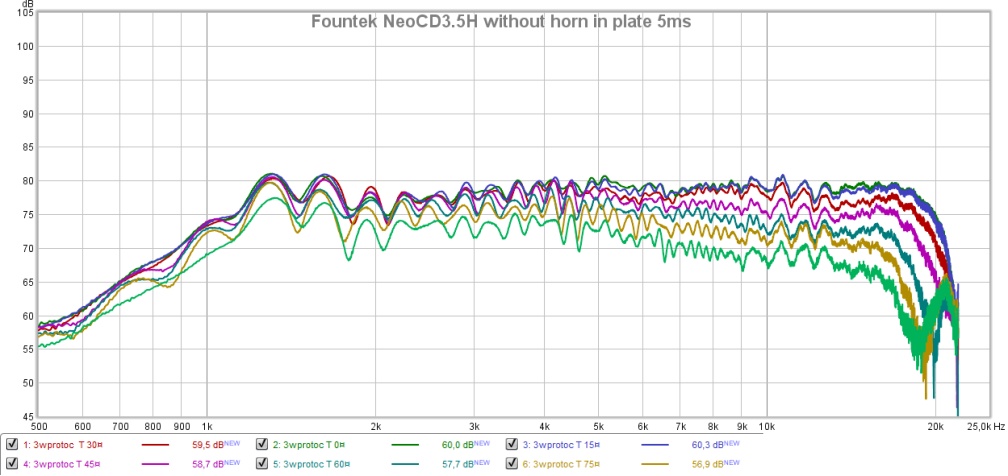

I took the 3.5H horn off and presto - very wide lateral dispersion! Vertical stays practically the same.
For minimal c-c distance and high xo, 3/4" neodyme tweeters that come without a flange/plate are the best. An example
Dayton Audio ND20FA-6 3/4" Soft Dome Neodymium Tweeter
My measurements of Fountek NeoCD3.5H outdoor in a narrow baffle with xo and indoor without the horn in a normal baffle (less distance) Both 5ms.
