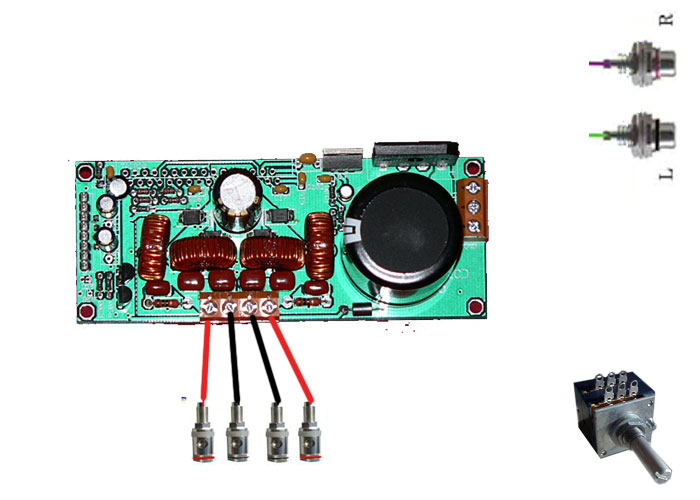

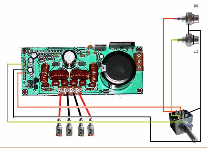

J jwb009 Member Joined 2005 2006-10-24 2:03 am #1 2006-10-24 2:03 am #1 If someone could tell me what to plug where to hook a pot up to my amp6 that would be great. I think I have it figured out, but I don't want to blow anything. I made a sweet picture, so if someone could add some lines, i'd appreciate it. Thanks Attachments amp6.jpg 57.7 KB · Views: 250 Pano Moderator Joined 2004 Paid Member 2006-10-24 1:23 pm #2 2006-10-24 1:23 pm #2 this should help Attachments amp-6 wires.jpg 47 KB · Views: 268 J jwb009 Member Joined 2005 2006-10-24 2:33 pm #3 2006-10-24 2:33 pm #3 That's awesome. A huge help for visual learners, as myself. Thanks! Status Not open for further replies. Share: Facebook X (Twitter) LinkedIn Reddit Pinterest Tumblr WhatsApp Email Link
