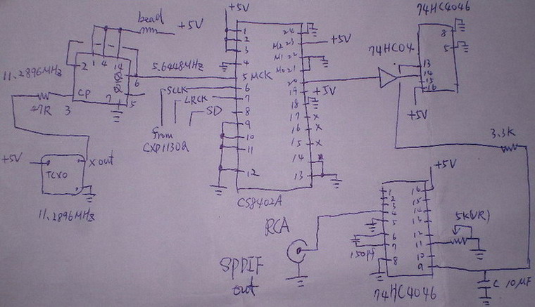

S sam8888ysl Member Joined 2005 2009-01-16 4:14 am #1 2009-01-16 4:14 am #1 add digital output from cdp(onkyo dx1500) with cs8402A its my first time use cs8402A and other cheaps the schemic as below any advise thanks Sam Attachments imgp0003.jpg 94.3 KB · Views: 75
