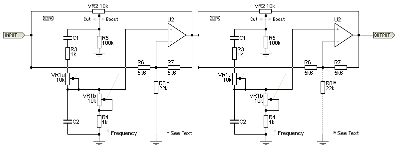

Rod Elliott's project 150 shows schematic for a single band parametric equaliser.
Parametric EQ
How does one add another band to it?
Thanks,
WA
And you'll need a 2-gang pot for the cut/boost VR2, and a 4-gang pot for the frequency VR1.
Alternatively you could replace the piggy-backed 10k linear pot for the frequency with
a single 10k log per channel, thus only needing a dual log 10k pot for frequency for two channels.
