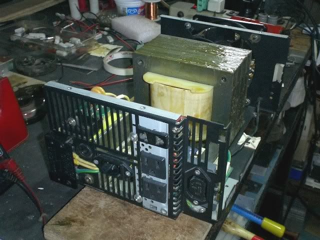

ps: why not try an isolation transformer on the power line to the offending equipment (i.e the PC).

Re: [b]isolation transformer [/b]
Nice one!
Cheers
ps: I have a digital multitester just like that one... 🙂
Tony said:like this one.😀
Nice one!
Cheers
