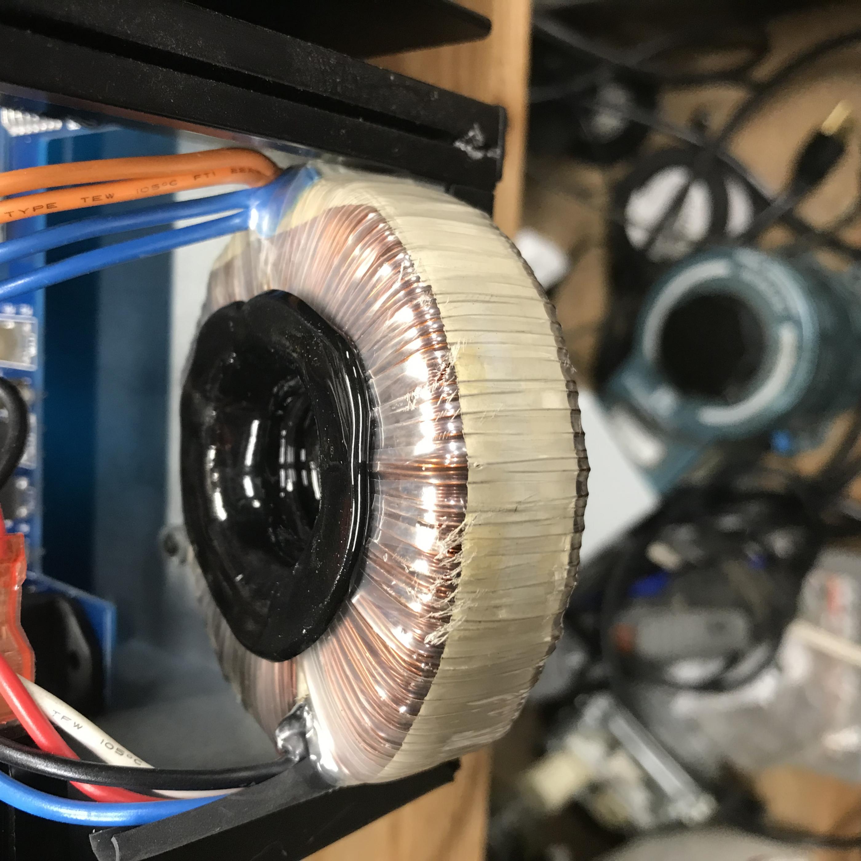

Hello. I have a GTP 750 that probably has a blown power transformer. It blows a fuse with secondary disconnected. Looks like it has dual windings one powering a 12 volt and 5 volt output. The other much higher around 60 volts.
It looks like the original might be a custom unit.

Looks like 62VDC and 12VDC supplies (it's hard to read the 62VDC).
So 12VDC/1.4 needs 8.5VAC, or maybe 10VAC.
And 62VDC/1.4 needs 44VAC, or maybe 48VAC.
Just buy two transformers, each the same physical size as the original,
one for each voltage. That will give VA to spare.

Thanks that gives me a starting point. Probably 500ma should do it. Looks like it might have gotten warm
