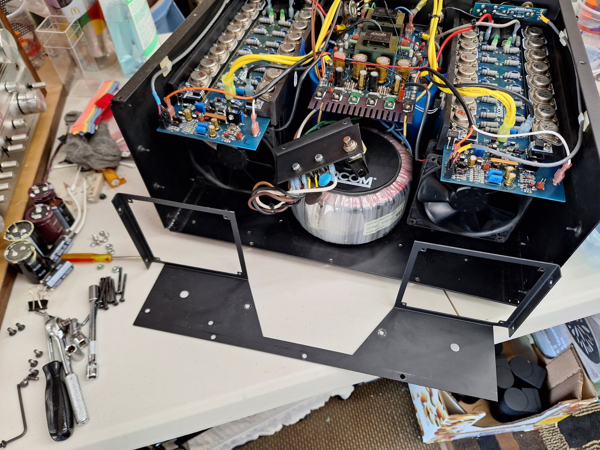

Hello! I am repairing an Adcom GFA5800 amp which has a thermistor mounted to each heat sink to drive the fan. The problem is that one of the leads broke off flush with the part. This side of the amp calls for a 40C part. How would I go about finding a sub for this part? I looked on DIGI-KEY but didn’t see a spec for 40C. Any help would be much appreciated!
Man, I've been doing some searching, and finding a PTC thermistor at 40C with around 140 ohms at 25C is very hard to find, not to mention mounting options. What would be the best approach for a substitute? Could the thermistor be replaced with a normally closed thermo switch? Attached is the schematic the part in question is TH1.
