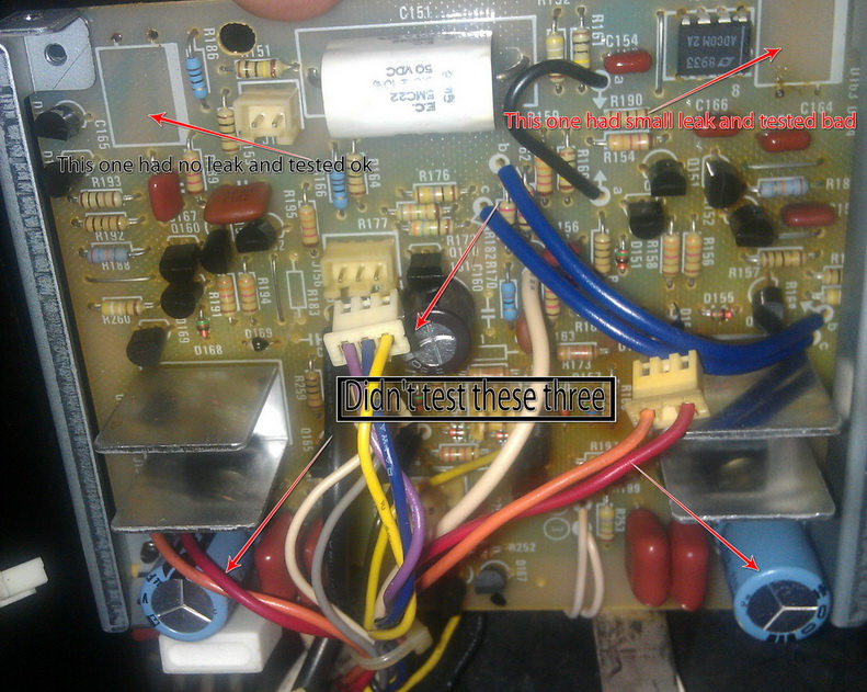

just to be clear, here's a picture with arrows pointing at all the caps on the input board- the two that are missing, I pulled out and tested
Inspection revealed ONE leaky cap- that tested bad, just to be safe -
is everyone basically agreeing that it is just better to replace all the caps - I mean, "all the ones that I have red arrows pointing at?" or just the brown ones?

Yes, just replace all of those. I would also replace all of the other small electrolytic caps, everywhere in the amp, while you're at it.
I would use caps rated for 105 degC instead of 85 degC. Type of caps shouldn't matter too much. I think someone said Panasonic FA would be fine. I'll probably use something like Nichicon UHE series, from mouser.com.
They should not blow up regularly; maybe every twenty or thirty years or so, they will need replacing.
I don't think that replacing the caps alone should require resetting any adjustments.
The main thing is to measure the DC Voltage across each set of speaker terminals. It should go to < 0.030 Volts (30 mV) within ten seconds or so after power on. If it doesn't, then you will need to clean the boards and components per the previously-linked thread.
