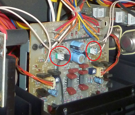

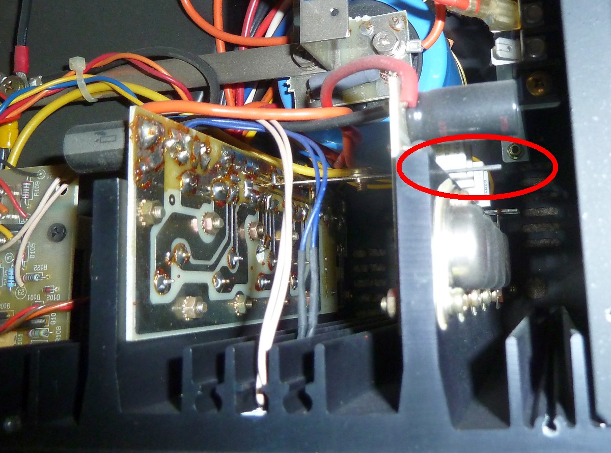

Now back to the test points.
Are these highlighted in red the test points?
If yes, do I test on two pins of the same part or across?
NO
The test points you identified are for adjusting the bias. The problem you are having (I thought) is DC at the output (the speaker jacks). There should be minimal DC voltage there (my guess is less than 20-40 mV).

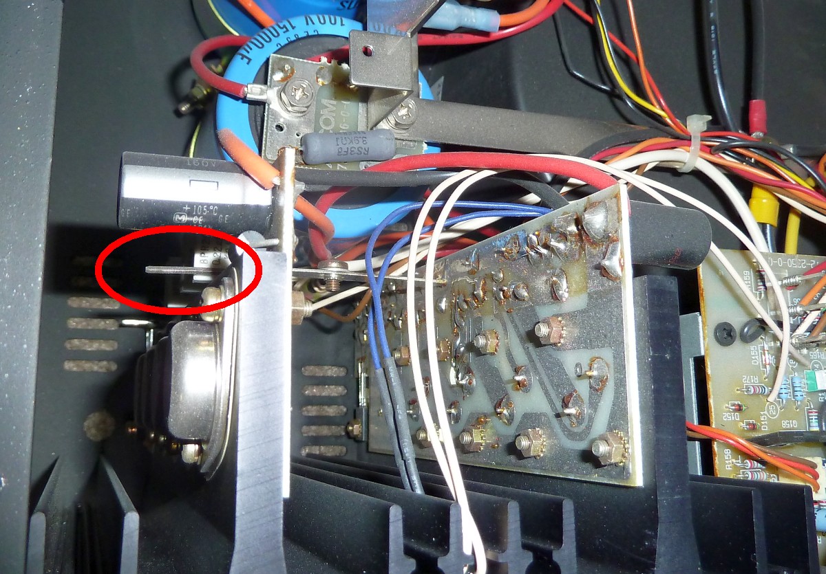

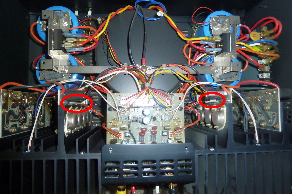

BTW, I found the test points. They are small metal bars on the vertical boards.
However, setting bias is so weird.
When I adjust the resistor, it changes value but automatically comes back to around zero soon after when no input is connected.
On right channel, it doesn't even do anything. Left channel changes value but resets to zero. 😕
Then I connected input signal and played a track and bias went up and down depending upon the music, around 14 to 18mV.
So basically, can't adjust bias.
Also checked DC voltage and it was close to 0 fluctuating sometimes to .001 when speakers were hooked up so I guess it's good.
I read this amp doesn't have speaker protection so that's something to read next. May be external DC protection is the way to go.
Here are the test points for reference highlighted in red circle.
However, they are not numbered TP201, TP301, TP251 and TP351 as mentioned in the service manual.
The numbers were J### something.

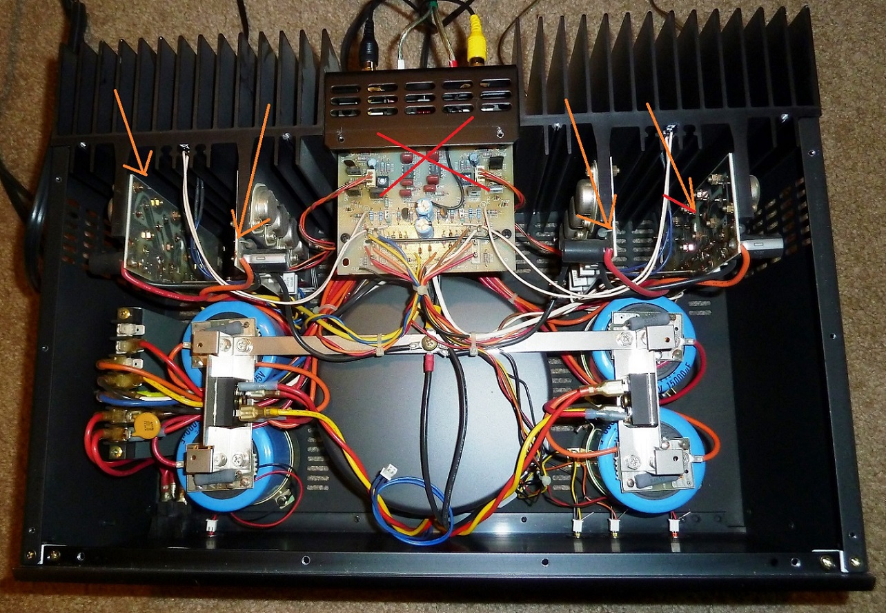

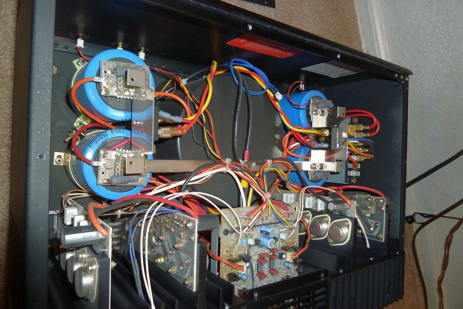

They want a sizable input signal (66 watts). Use a tone generator (or recorded tone on a CD). Dial it up using the relation: Power = Volts^2/R. "R" is the power resistor (and it will get hot). The amp must be warmed up before testing the bias. Follow those instructions carefully. Adjusting those pots will alter the bias and you should be able to read this at the test points.
Please note that the traces on the Left and right circuit boards look different. The ones on the left look like thay have gotten very hot in their previous life (compare to the right side). That hodge podge of different fuses, suggest this amp has a bad history.
The traces are different as their arrangement is different in each channel.
The outer right board is same as the inner left board and vice versa.
Same board uses same colored wire.

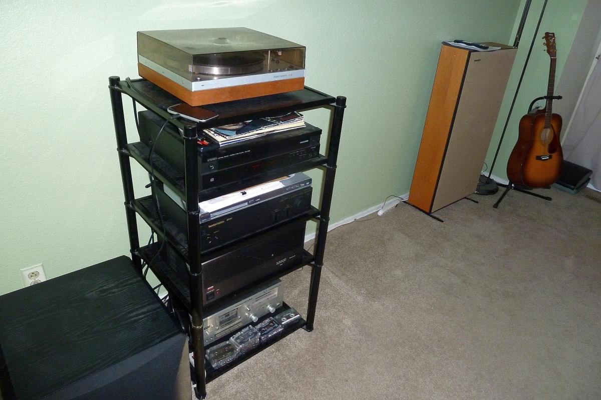

Here is the setup in my living room:
Philips 312 Turntable.
Yamaha CD Player (I have a Nakamichi CD player somewhere in the basement that'll replace it soon).
Harman Kardon Signature Series AP2500 Pre-amplifier.
Adcom GFA-555 II Amplifier.
Marantz 3000 Cassette Player.
Boston Acoustics A400 Speakers.
Definitive Technology PF15TL+ subwoofer.

I have not tested the Bias but it's more or less exactly in the middle as it was before I adjusted it.
I'm guessing it may be off by few mV's in the two channels but that shouldn't hurt right?
Fuses are there to prevent fires, but they don't always even do that. The silicon fuses are usually quicker than the wire fuse. Speaker cones flying across the room can happen long before the fuse blows. Surprise! That's a big honking amp and it can do some damage.
Bias being low will cause lots of distortion. Being a bit high not so much. Too high can lead to stability issues. You find them easily when it sounds funny and by the time you walk over to it, the heat sink is too hot to touch and the outputs will fry when your hand is about a foot away from the power switch. This I know first hand, thank you CM Labs.
DC offset on the speaker terminals should by under 50mV or so. Things do drift with years. You may want to add some way to adjust the offset, by pot or add DC servo.
I can't remember, did the series II have one of Nelson's automatic opto-coupled bias adjustment setups? Series one used his driver current sense, but I don't know what changed.
I have no idea if they have automatic bias adjustment.
May be someone here can answer.
I don't have expensive speakers so main issue is fire hazard so I'll make sure to turn everything off when I'm not around them.
