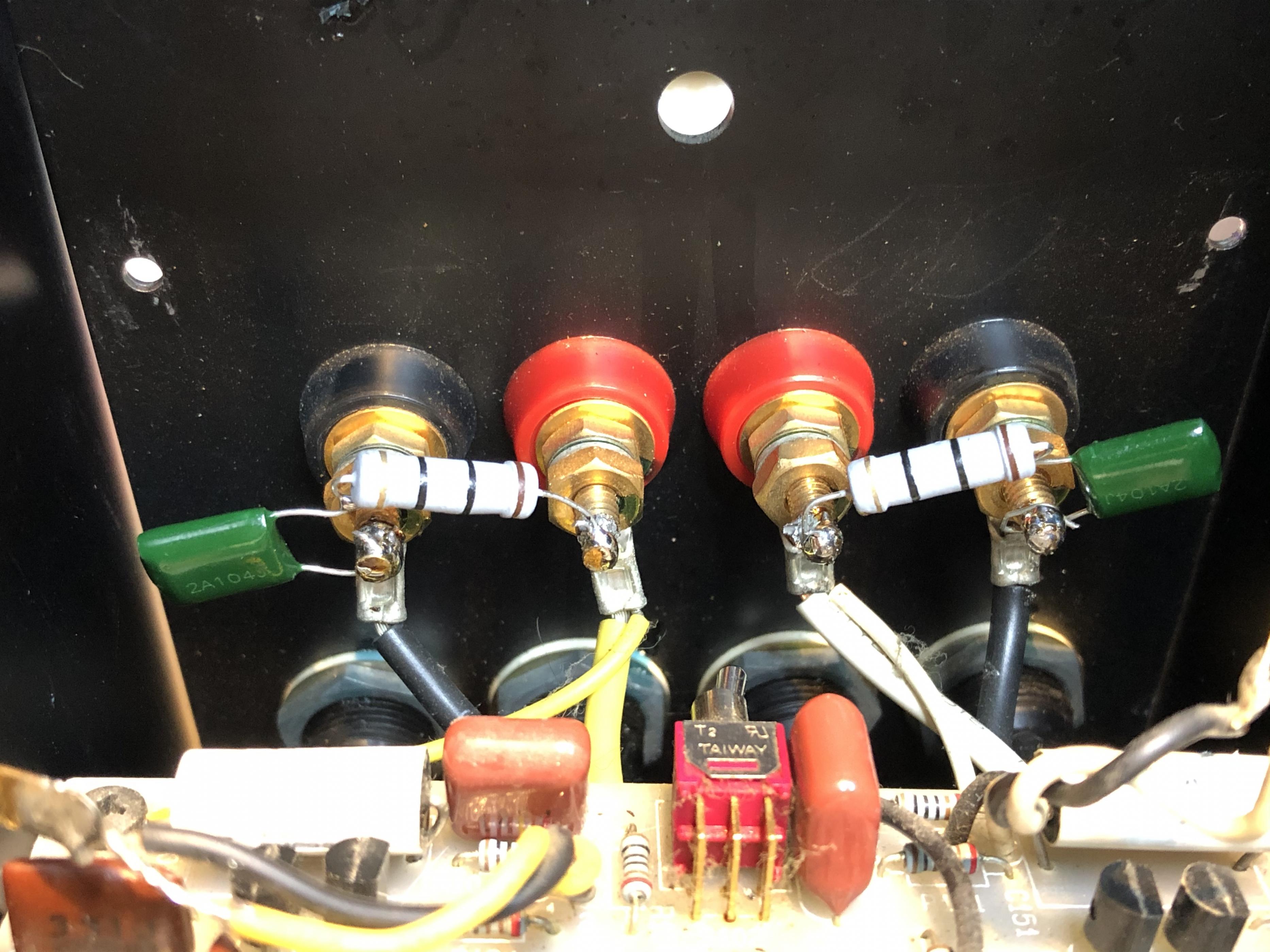

Finally
I finally got back to this project this past week!
Yeah it's been a while, a few pieces of test equipment got in the way of repairing the amp.
It wasn't as bad as I thought. Once I took the amp apart it was obvious.
The resistors in the zobel network on the output terminals burned up. Resistors
R901 (left channel) & R951 (right channel) were pretty well toasted.
Both resistors are 10 ohm 2 watt.
R901 tested at 17k, this channel had the worst oscillation.
R951 tested at 350 ohms, this channel mostly worked.
I replaced both resistors and also C901 & C951 (0.1 uF). See pic.
The amp is back to it's normal self. I'm listening to it now.

Determine if it's noise or distortion first. Measure the AC output with no signal, do an FFT if you can.
Thanks Chris, Good idea.

The right channel does have a little higher THD+Noise number than the left channel. Not sure what's up with that. Anyone have any ideas? The right channel was about .025% at 1KHz and 200 Watts @8 ohms. The left was .003% same conditions.
I see that sort of thing sometimes. The most common reason is a bad wire connection(corroded wire crimps) on the internal speaker wires to the output terminals. Try testing distortion before the wires at the board to see if it's better. Also test distortion on the input directly on the board to see if the problem is an input connection. Most of the time it is something simple.
