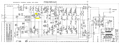

I recently picked up a Adcom GFA-535-II off of Craiglist for $80. I found a service manual for it and have been looking under the hood. I’ve found that the schematic has an error and omission and thought I’d share my findings. I attached the service manual and the schematic extracted from said manual with the errors and omissions highlighted.
The Error
The schematic in the service manual shows to input to the VAS stage coming off of collection the feedback transistor (Q603/Q604) of the LTP. When I first saw this in the service manual schematic I was a bit baffled by the topology. I couldn’t figure out how this could possibly work. I opened up the unit and probed the connections with the continuity setting on my DMM and confirmed the error. The connection should be to the collector of input transistor in the LTP (Q601/Q602 not Q603/604).

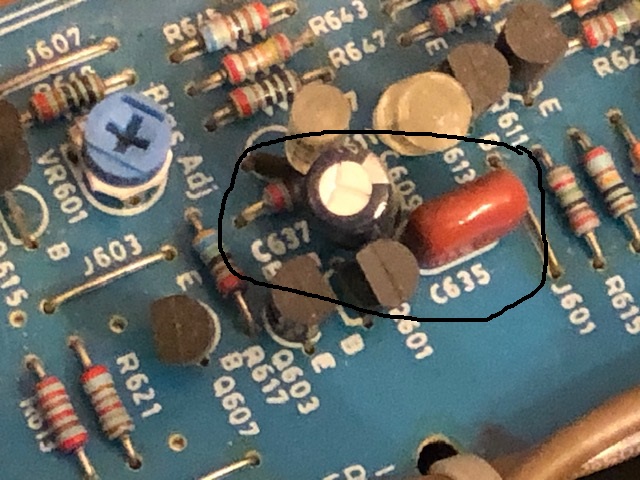

The Omission
The omission is an electrolytic capacitor C637/638 bypassed by film cap C635/636. These are DC blocked caps in the feedback loop. In my unit (Rev-2 of the PCBs), these caps are mounted on the boards with silk screen and are spec’d at:
I understand there are three versions of this situation:
Other Omissions?
One more item to note… The capacitors in the service manual go to C631/632. The omitted capacitors I found started at C635/C636. This suggests that C633/C634 exist somewhere. However, I could not locate them.
That’s all. I hope someone else finds this information useful.
The Error
The Omission
- C635/C636: Film 0.47μF 400V
- C637/C638: Electrolytic 22μF 50V
- Original with no caps
- Caps installed on the underside of the PCB without silkscreen
- Caps installed on the top side with silkscreen (Rev-2 boards)
Other Omissions?
