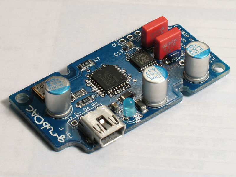

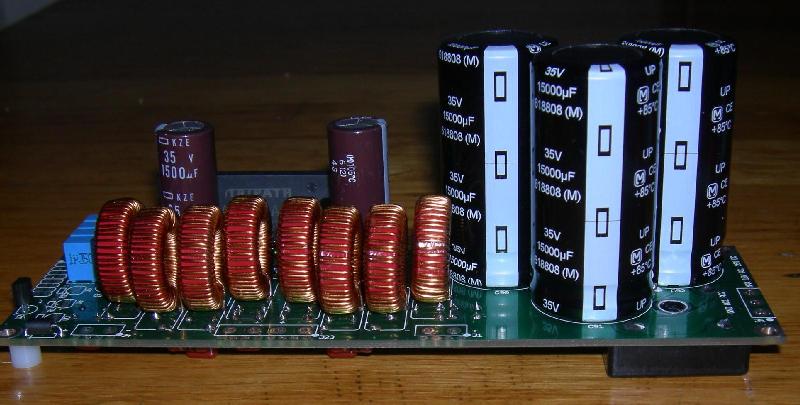

I'm adapting an old APC UPS box to serve as amplifier case and house my 41Hz AMP9-PS. Space is little cramped with the AC transformer and the amp's board being fairly close. If possible I'll even try to fit my GrubDAC later.
Thing is, with space being a little bit cramped and all, how worried should I be about noise/interference from mains and the AC transformer, both being so close to the amp's board and the signal's path. Should I try to shield the mains and the AC transformer from the amp and the signal wires?

I have never personally had a problem with a transformer, however, if you are worried then it would be good practice to put aluminium sheet between the transformer and the rest of the circuitry. 🙂
Tnx, will aluminium sheet suffice?
I half remember something about materials being able to magnetize, being best shielding options... not sure though, just something I think I've hear about...
Aluminum will shield electrostatic field but won't do diddly for magnetic shielding. For that it should be steel or better yet, Mu metal.
