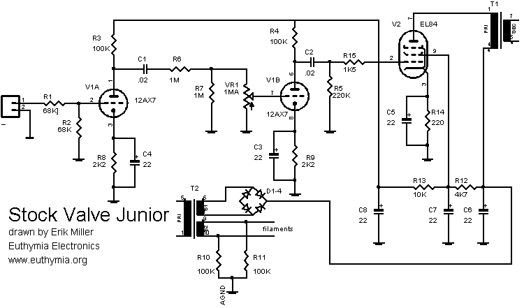

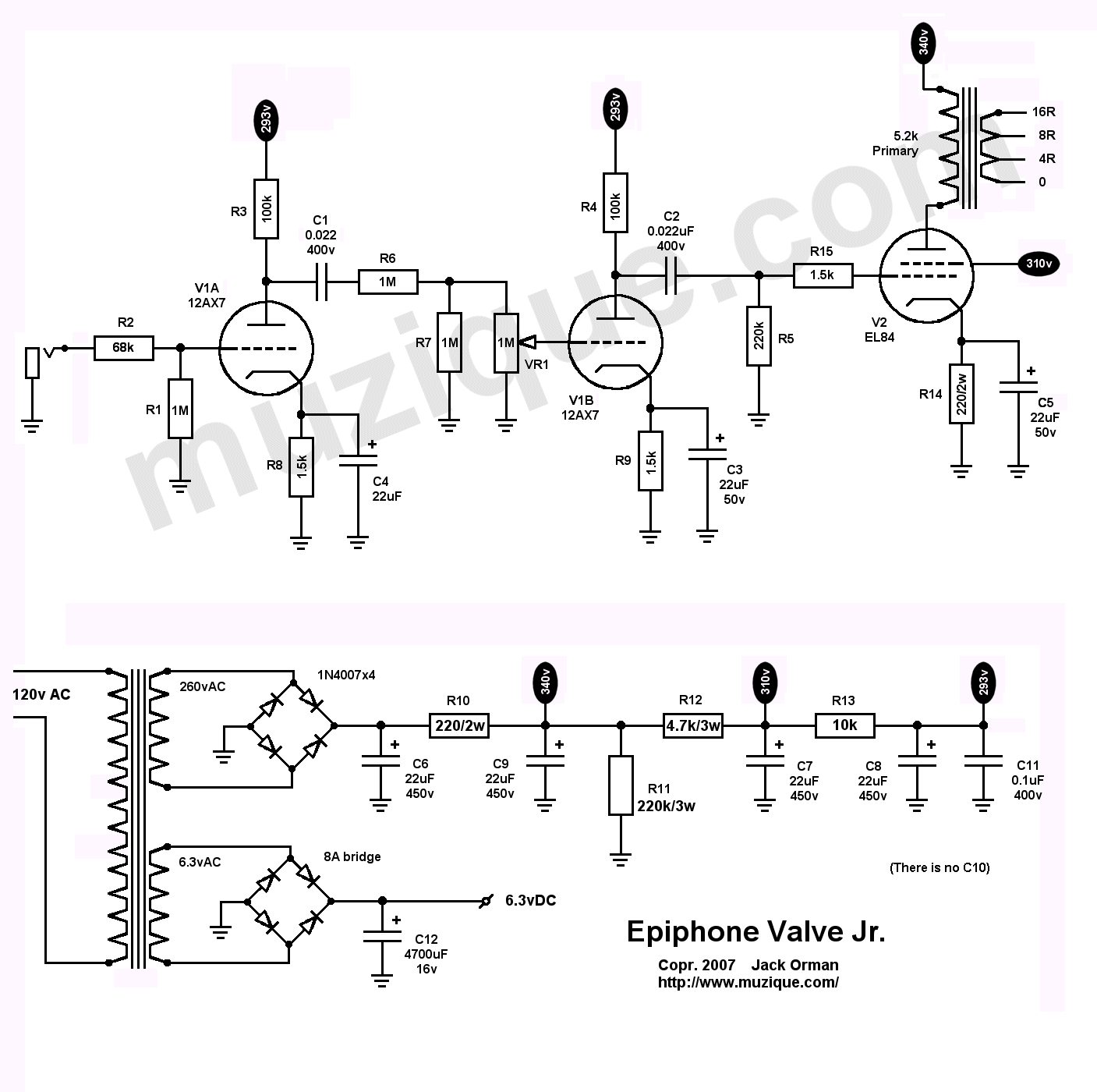

I want to adapt these SE boards for use as a driver stage for a balanced PP power amp. XLR input for the balanced run and Probally just use an imput transformer to act a a phase inverter for non balanced runs.. I have plenty of power tubes, plenty of output transformers, plenty of power transformers. Have some good sized chasis to do mono blocks. the drive ability of this board, should easily drive 8 to 12 power tubes.

On these boards. I might change the value of C1 and C2, since I will be using 160 watt transformers that can do 20hz - 20khz. I think on this board, c1 and c2 were sized to limit bandwidth to 5 watt fly wieght transformers.
What am I doing. I want to reverse engineer an amp like the the C#$@ V12 which uses SE driver boards as a driver stage. The mono version has 12 EL34's, 2 EL84's (as drivers) and at lease 2 12ax7's. So my thought is if I go balanced end to end, and rely on the XLR connection for phase inverting, I'd be half way there. For unblanced connections I could put in an input transformer to invert one leg of the signal.
so you don't need huge gain then. Probably one too many gain stages in these EXCEPT if you use the EL84 in cathode follower mode.
Perhaps single-ended gain 1st stage to single-ended gain 2nd stage to EL84 CF stage to EL34s... (each phase)
