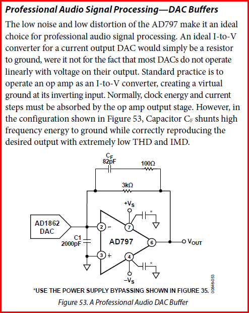

“noise gain compensation” of a decompensated op amp is good with resistive feedback, plenty of design guides, explanations out there
but for DAC I/V with feedback C the “noise gain” feedback becomes a C divider - I worry that a C divider feedback will have additional interactions with the op amp output Z – can still be dealt with if you have some practical info on op amp output Z near the gain intercept, possibly way beyond if local output Q oscillations are possible
Unfortunately maxing out GBW with today’s fast processes put us way beyond the spice macromodel output Z usefulness – sim can’t help us much here if the device designers don’t give use useful output models
We do have the example of Wurcer’s AD797 datasheet app with the input shunt C in a DAV I/V, he adds series R to the feedback C which partially defeats one of the advantages of having the feedback C, and the AD797 stability is known to be a compromise so this may not be a general answer

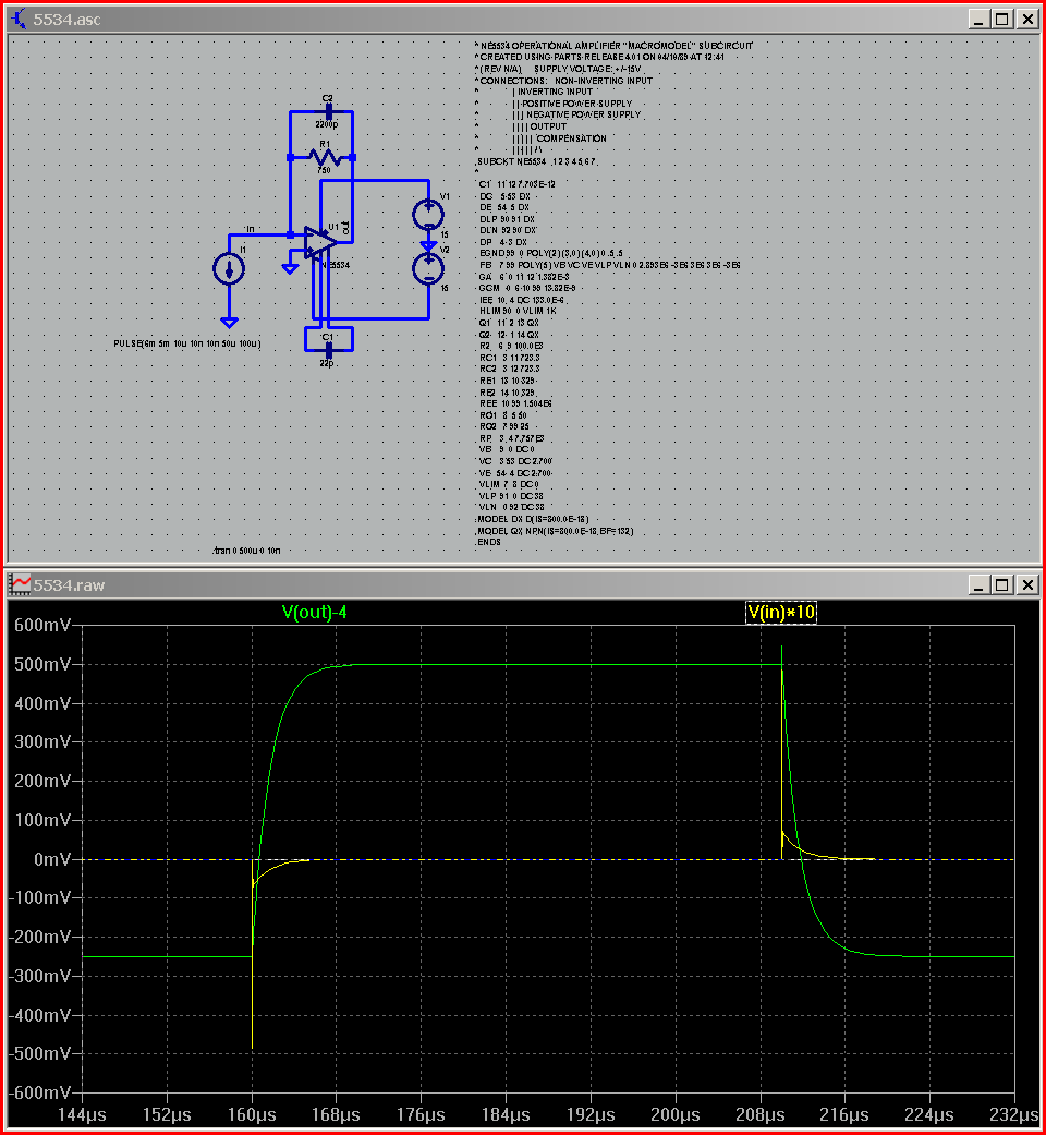

Agree and correct! Simulation does not relate to sound quality, but it tells you about the predicted result of design. Since simulation relies on mathematical formula to calculate, it still exists error. The actual result depends on the prototype and the sound quality depends on topology of circuit design.
The advantage of simulation is to shorten your development leadtime, particularly benefit to you if multiple scenario of designs are selected. Since the predicted data or measured value of low distortion, high skew rate, etc.. do not gurantee good sound quality, the final judgement must be done by practical listening test.

I also downloaded Tina TI in order to simulate NE5534 opamp IV stage but at first attempt I am unsucessful... some errors come up and the software is not as intuative as LT spice.

Also about the cap and resistor in series in the feedback loop.
AD797 in their eval boards and measure extremely well, but as mentioned you must be careful and don't forget the resistor in series with the cap.
What does it do? It looks like something you would see in a current feedback op amp? I'm sure it's filtering something or? What does it exactly do? Will it filter some high frequencies and dissipate them into that resistor in series so it wont affect the output of the opamp?
explanation would be appreciated 🙂

its easy to add other op amp models to Ltspice if that's your only reason to try Tina
The only reason why I want to use Tina TI is to model the IV stage in the PCM1794A datasheet with the NE5534 opamps..... the spice models of the NE5534 are not working well in LTSpice and it cant simulate :/
So I figure that TI's own program can simulate it's own Spice models but I have to learn Tina to do this one thing 🙁

I also get an error that says some of the sort "Node is floating U:99" or something. But every pin is connected 😡
I don't have a problem with TI's NE5534 - did you add the comp pins, add the 22 pF comp C?
.asy symbol with comp pins has to be added where you can find it - edit off the .txt extension
also had extra character at end of TI's model file that I deleted when pasting the text into Ltspice' "Spice directive" box (far right tool bar button)
