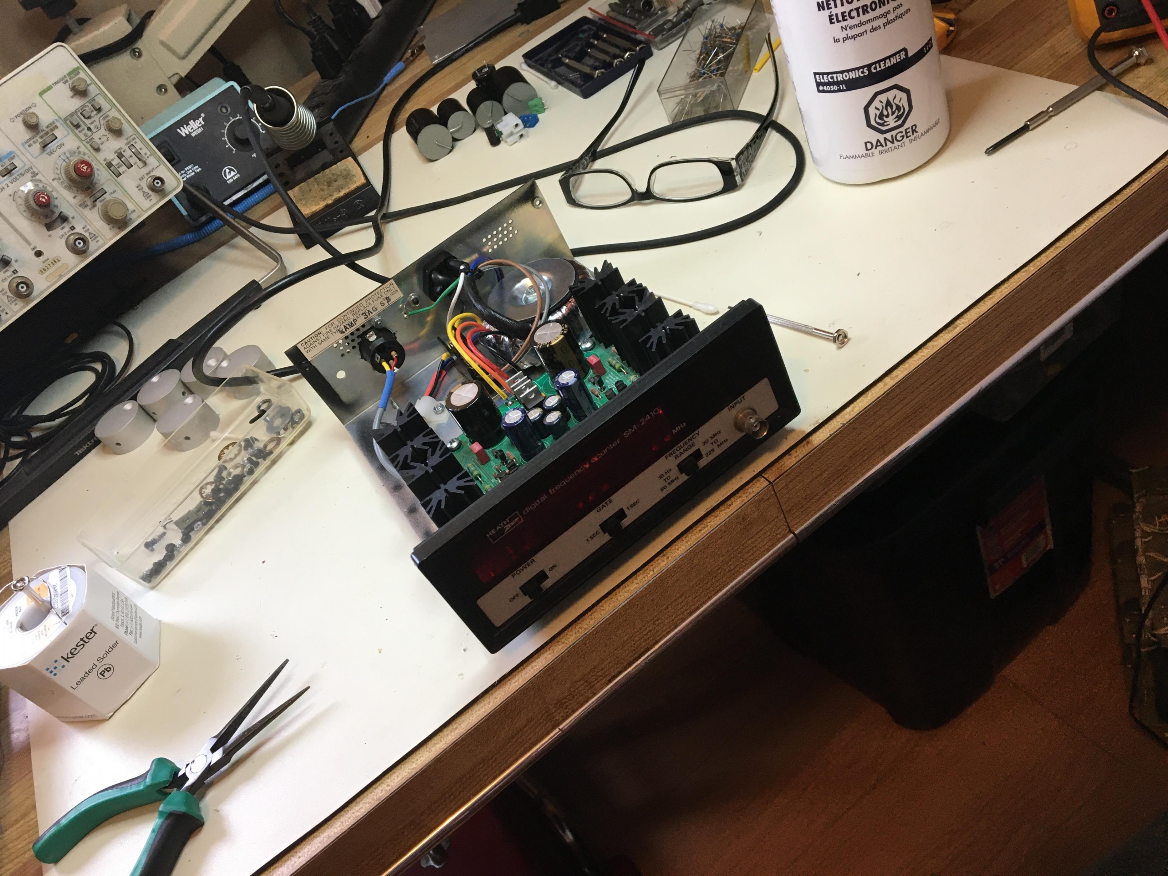

Well I haven't posted for a while so I thought I'd share my latest project of rebuilding an Acurus RL-11. I rebuilt an A-150 a while back and I was looking to find a RL-11 to match it, and honestly I just can't live without remote volume anymore :=) so the RL-11 was my only option in the Acurus line.
So some of the improvements I saw that could be made were in the power supply for the preamp section, maybe improve the circuitry a bit, and the volume control on this unit had seen better days so it needed replacing.

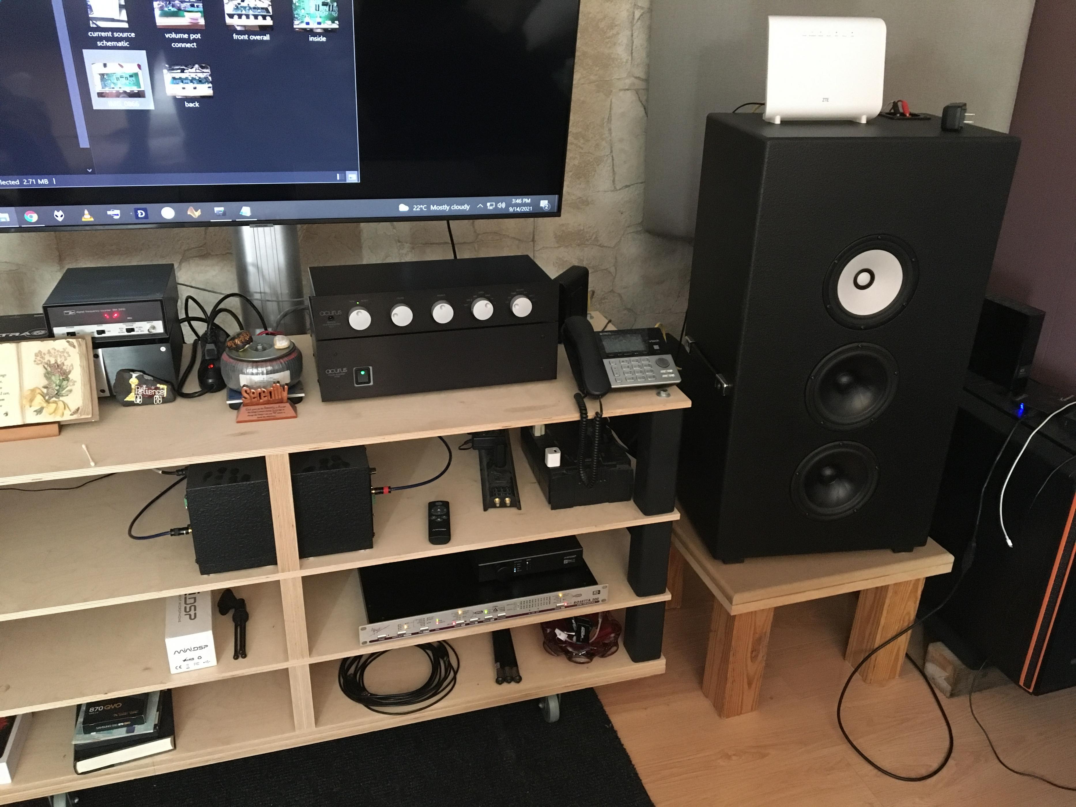

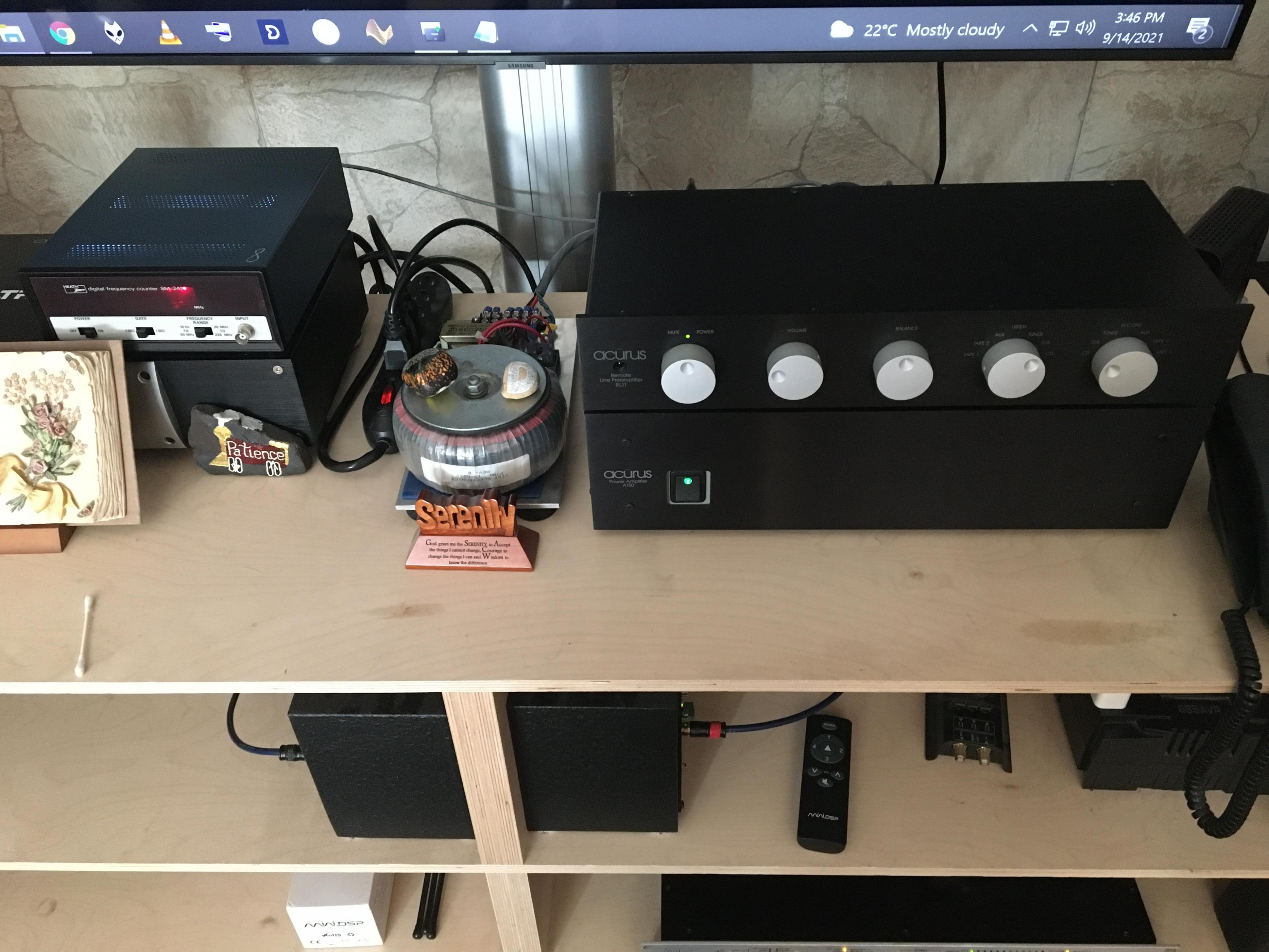

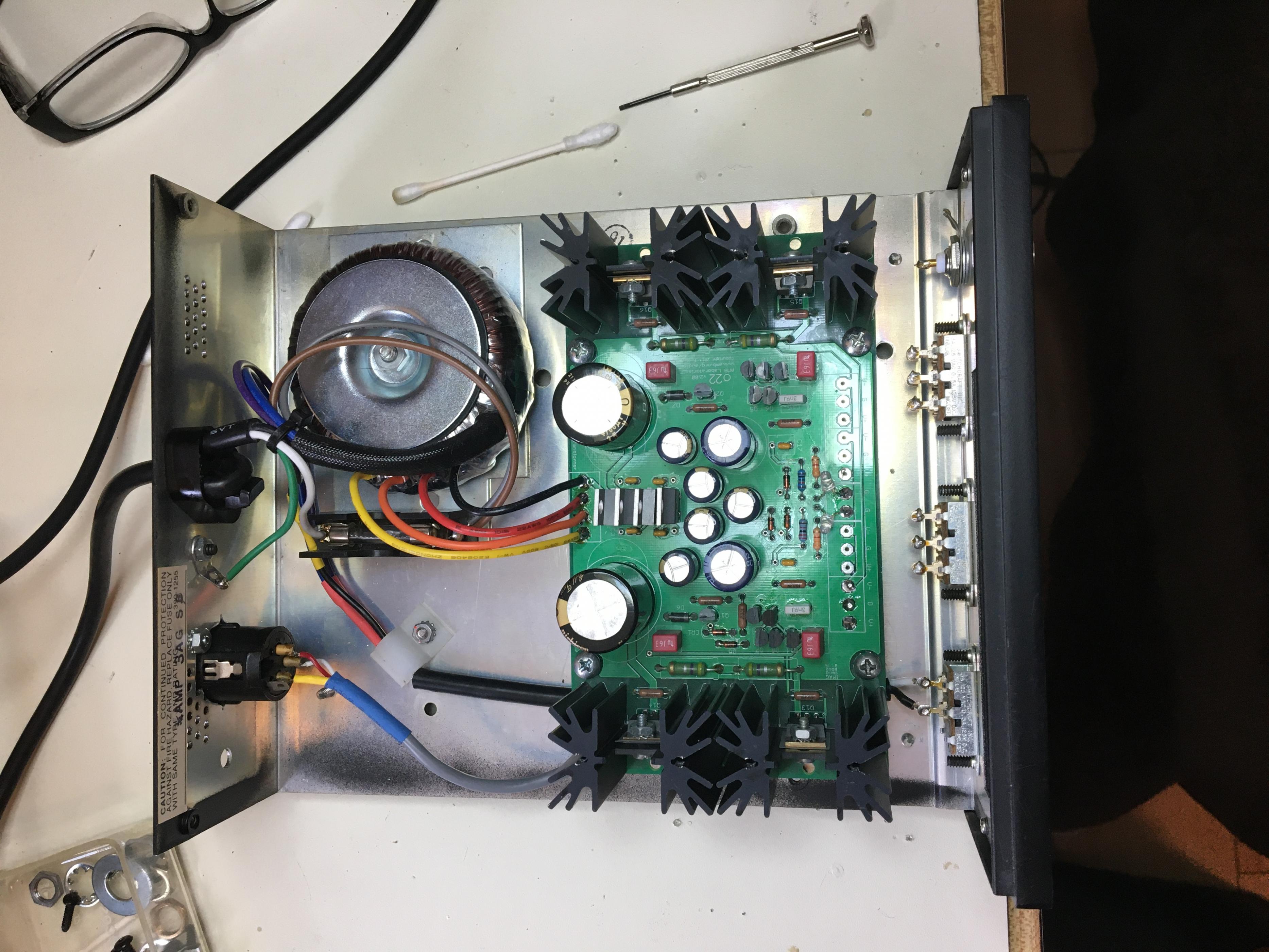

The biggest problem I see with this preamps power supply is that the transformer is undersized, the regulator for the preamp looks pretty good and it is mostly separate from the volume control voltage. The only place where they are tied together is for the relay that ungrounds and mutes the input signal. I had an parallel regulated power supply already so I decided to go a bit overboard on it but I would of been happy with just upgrading the transformer if I didn't already have the supply. So I put the parallel regulator and a 25 VA transformer in a case I had from an old frequency counter and used XLR jacks to connect it to the preamp. I tried to match the old voltage of 17.5-0-17.5 volts as closely as possible.

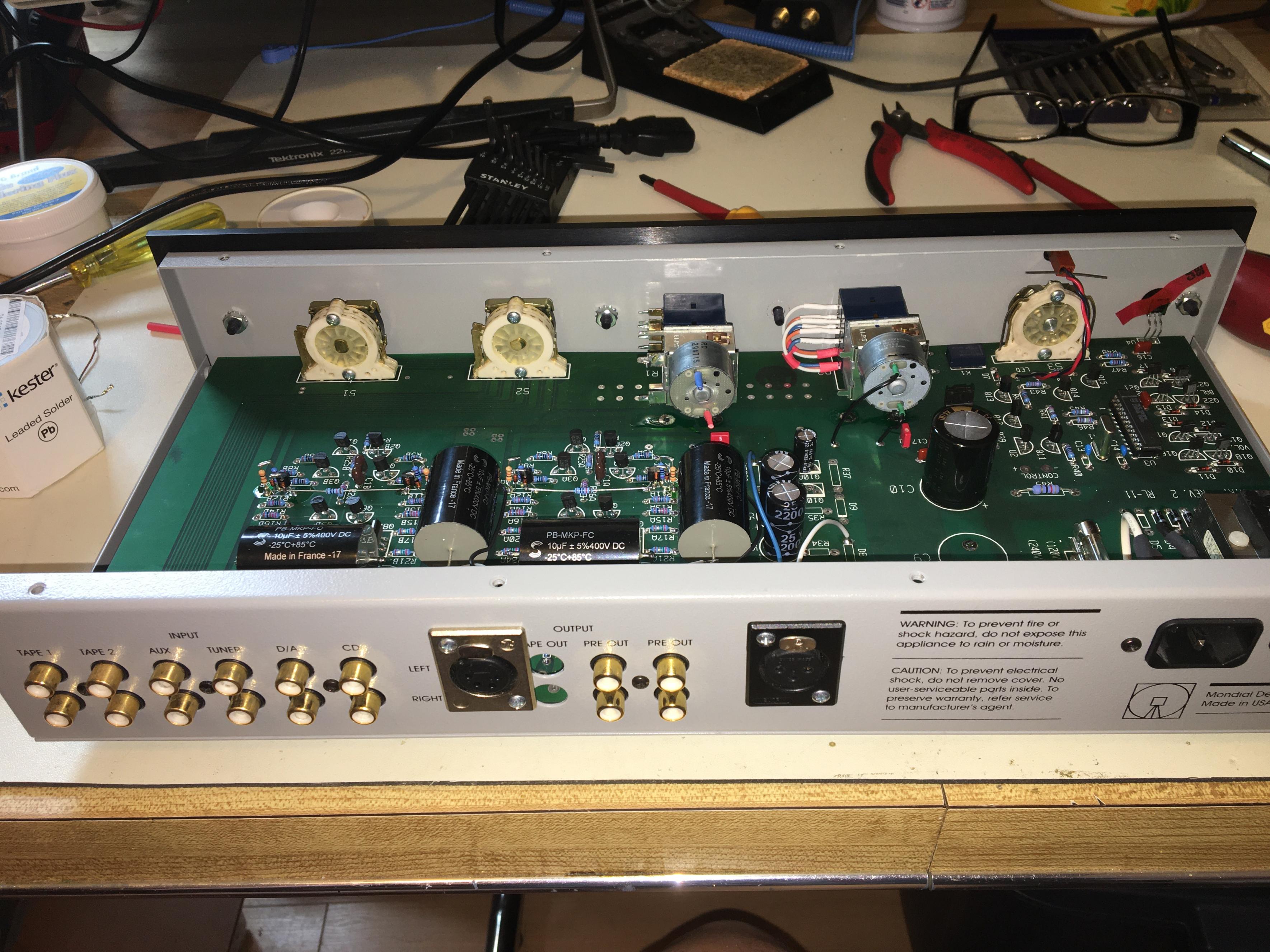

I removed the preamps internal regulator to allow for a few extra filter caps I wanted to add. I added 2200uF electrolytic and 10uF polypropylene caps across each voltage rail and added some .1uF cog caps on the underside of the PCB to each side of the power rails.

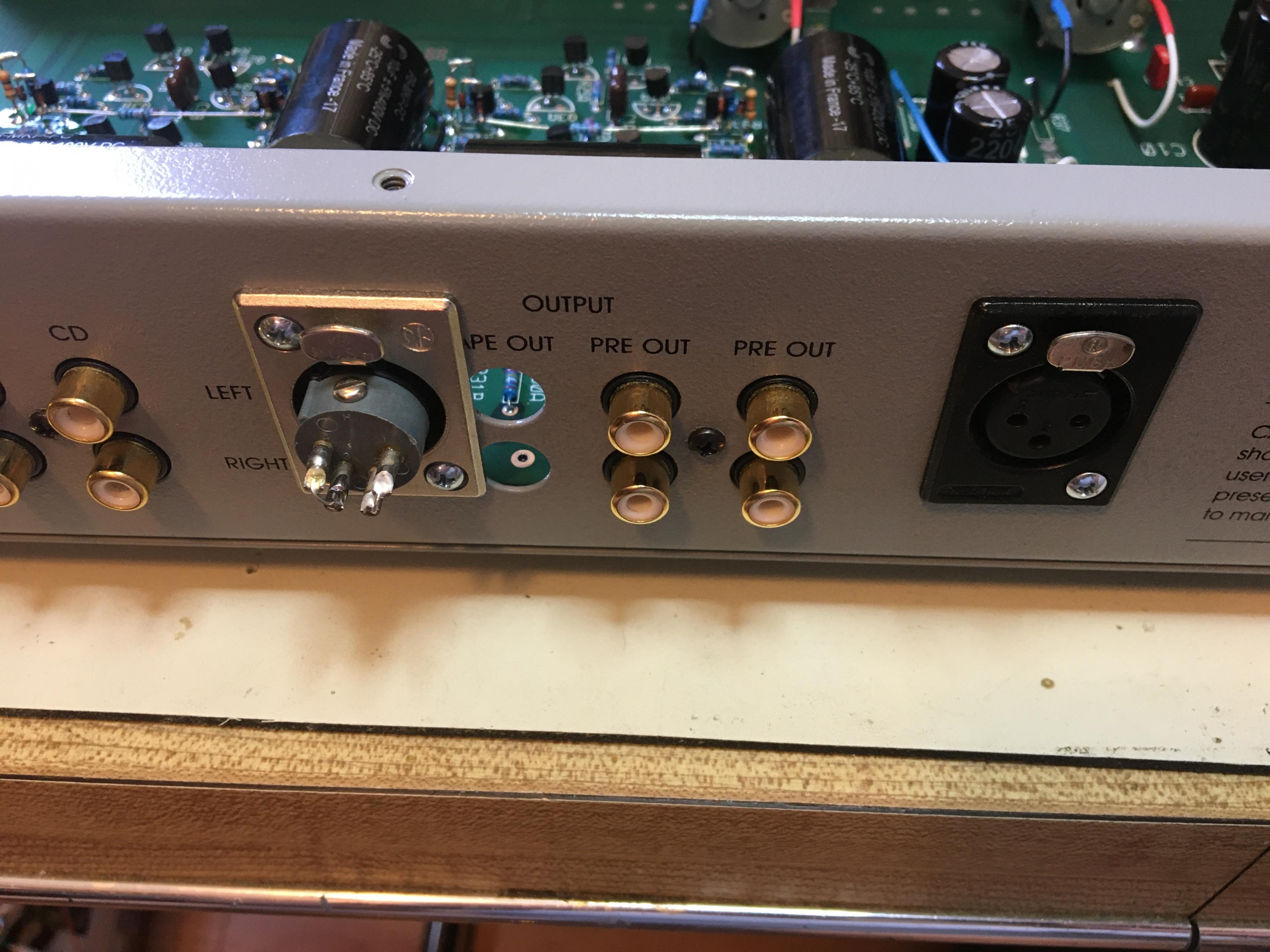

also I wanted to be able to bypass the output capacitors for when my power amp is capacitively coupled. This is a feature I've always wanted on an analog preamp and I had a 4 pole XLR so I used this to create a jumper that could be added or removed based on the power amp I'm using. I also upgraded the output caps to Solen polypropylene.

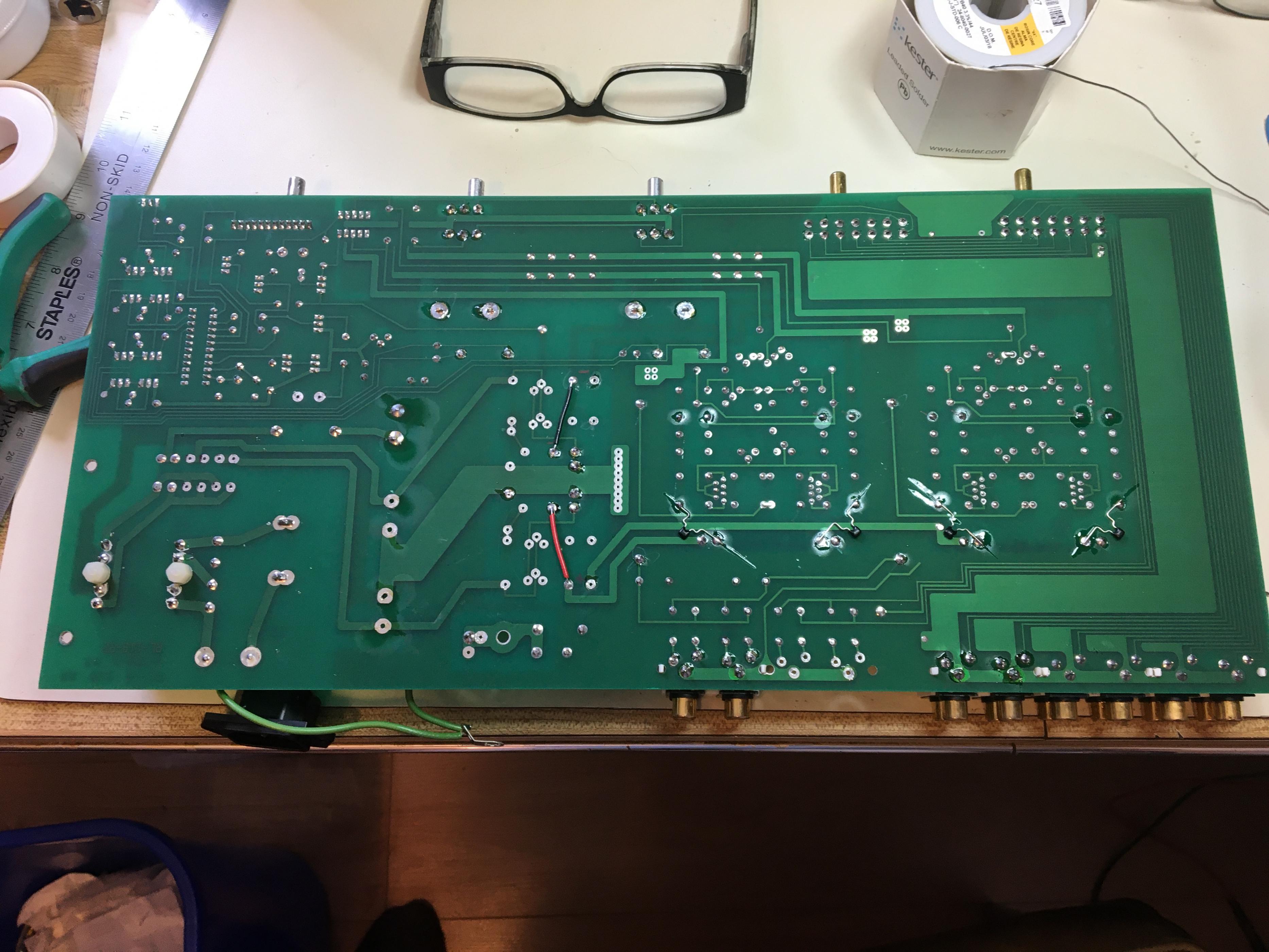

When comparing the RL-11 circuit to some of Mondial's higher end stuff the addition of current sources in place of the emitter resistors on the input differential pair was the most stark improvement I could see. So I found there was 17 volts dropped on the emitter resistor of 61K, this gives about 200 uA. I used BC550, 560 with 1N4148 signal diodes to create the needed current source.
they were a bit tricky to make so they would fit into the space of the resistor but with a bit of practice it worked.

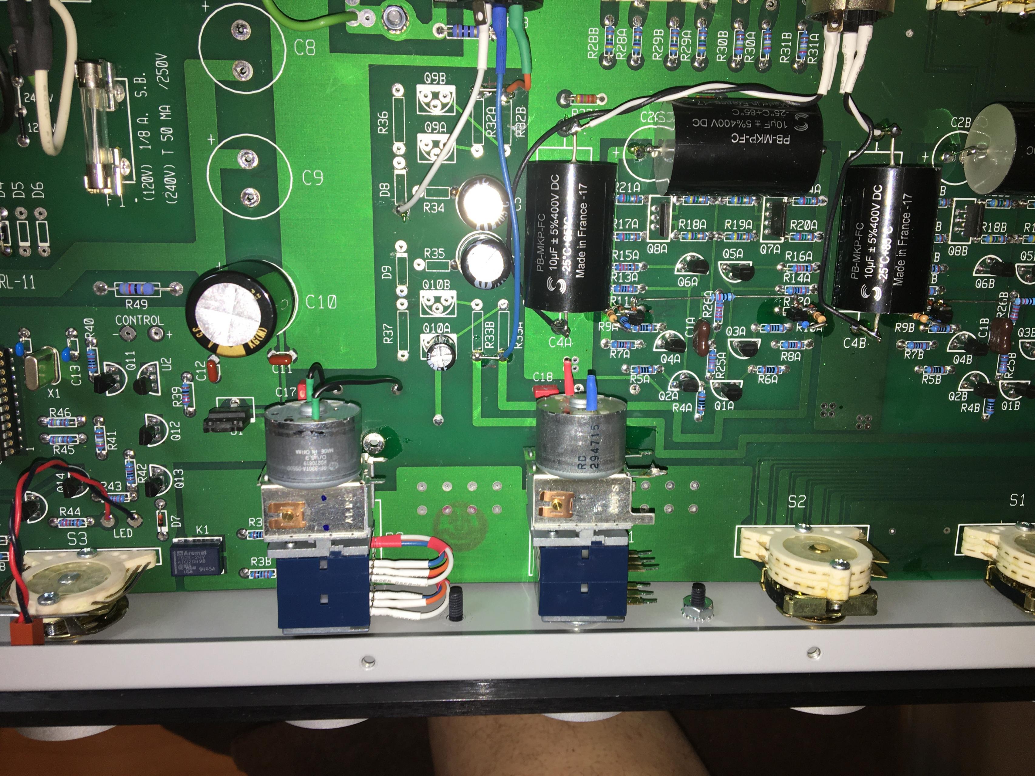

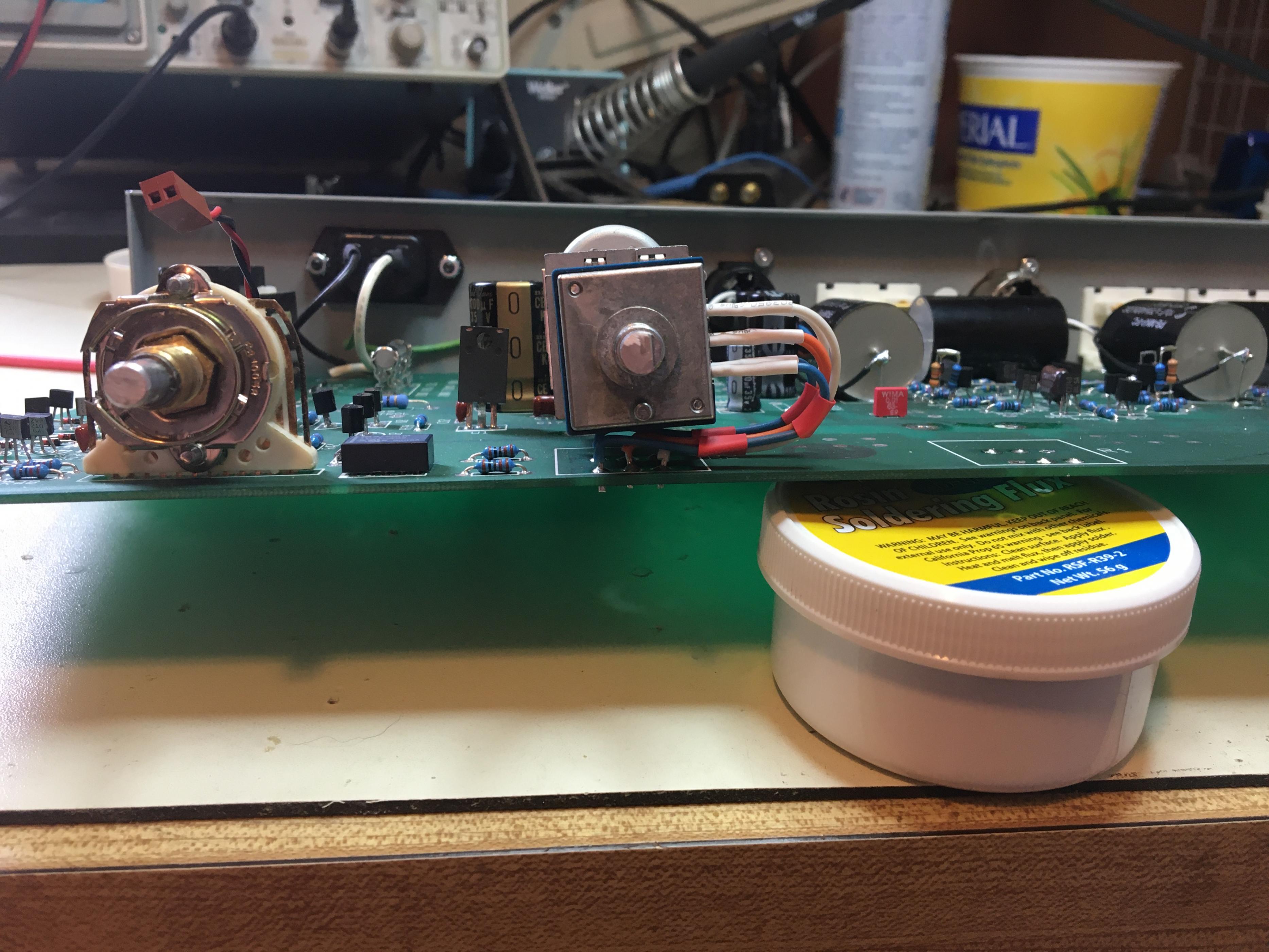

and finally the volume needed to be replaced on this unit. I'm guessing my preamp is over 20 years old and had seen a lot of use. The volume control was grinding pretty good when activated. the problem is that Acurus used a very unique height volume pot and the standard replacement wasn't going to fit if I soldered it directly to the PCB. so I just made a kind of umbilical and turned it on it's side and it seemed to fit quite well. One thing is I disconnected the balance control and bypassed it. I removed the balance pot and did some measurements on it and I'm sorry to say but it's tracking was WAY off. Like thousands of ohms off. So I didn't really need it anyways because I have a room correction processor. so I just bypassed it and turned it sideways so I could still put the knob on the front.
because the balance is bypassed I wanted to still preserve the correct input impedance for this preamp (which is 10 K ohms apr.) So I replaced the 22k existing pot with a 10 k pot. about the only hiccup I ran into when doing this rebuild was at first I didn't realize that the mute relay relied on the negative voltage rail that supplied the preamp section. so when I first fired it up I could measure that everything was good but I could not get any sound. It baffled me until I took a closer look at the relay and saw the tie in to the parts I had pulled, so I just recreated the negative rail in a diminished capacity to satisfy the relays need.
