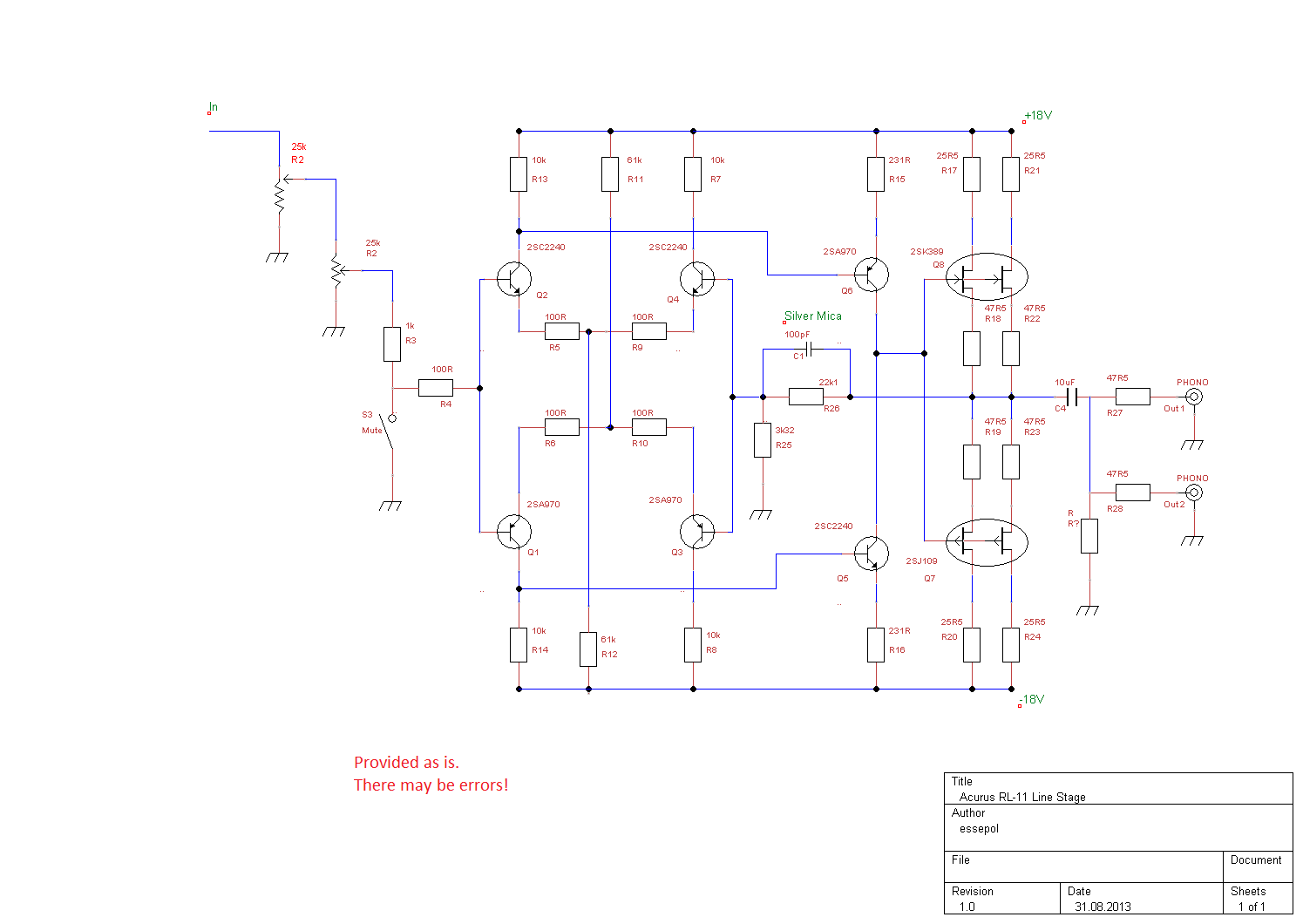

Attached is the schematic for one channel thanks to Martin.
Will some of you experts on here please take a look at it and see what changes you would make to improve the sound?
I've outlined the changes ole' Kenny does above. Perhaps he's talking about replacing Q1 and Q3 with mosfets? Looks like Q2 and Q4 have been removed.

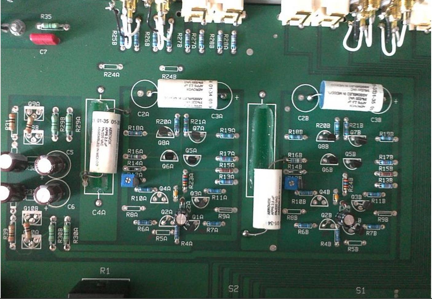

Also attached is an image of the board after his mods.

It seems like he has changed Q3 and Q1, as well as removed Q2 and Q4, removing the symmetrical topology of the input-stage. I think this as well is a fairly drastic mod. It will almost certainly change the sound, but it changes the topology as well, making it essentially another amplifier, from my point of view.

I agree, I'm not really interested in the power supply mods. I'm more interested in the changes to the amplifier section itself.
Looks like R14A,B have also been removed. I assume the trimmer pots are there for biasing the mosfet transistors, but not sure.

Before the mod it looked a lot like a jc-2 with BJT input... From a quick glance he removes the symmetry from input.

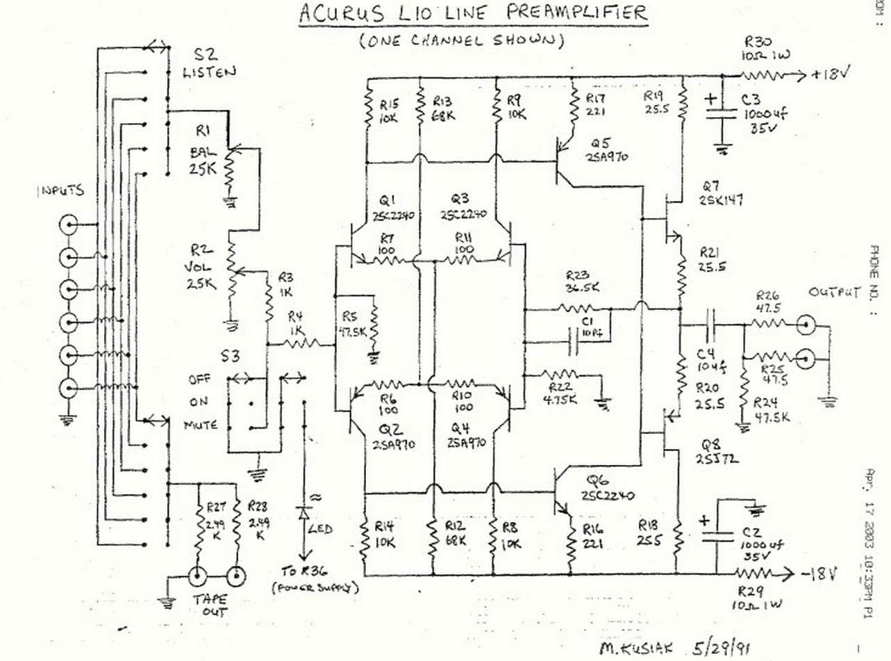

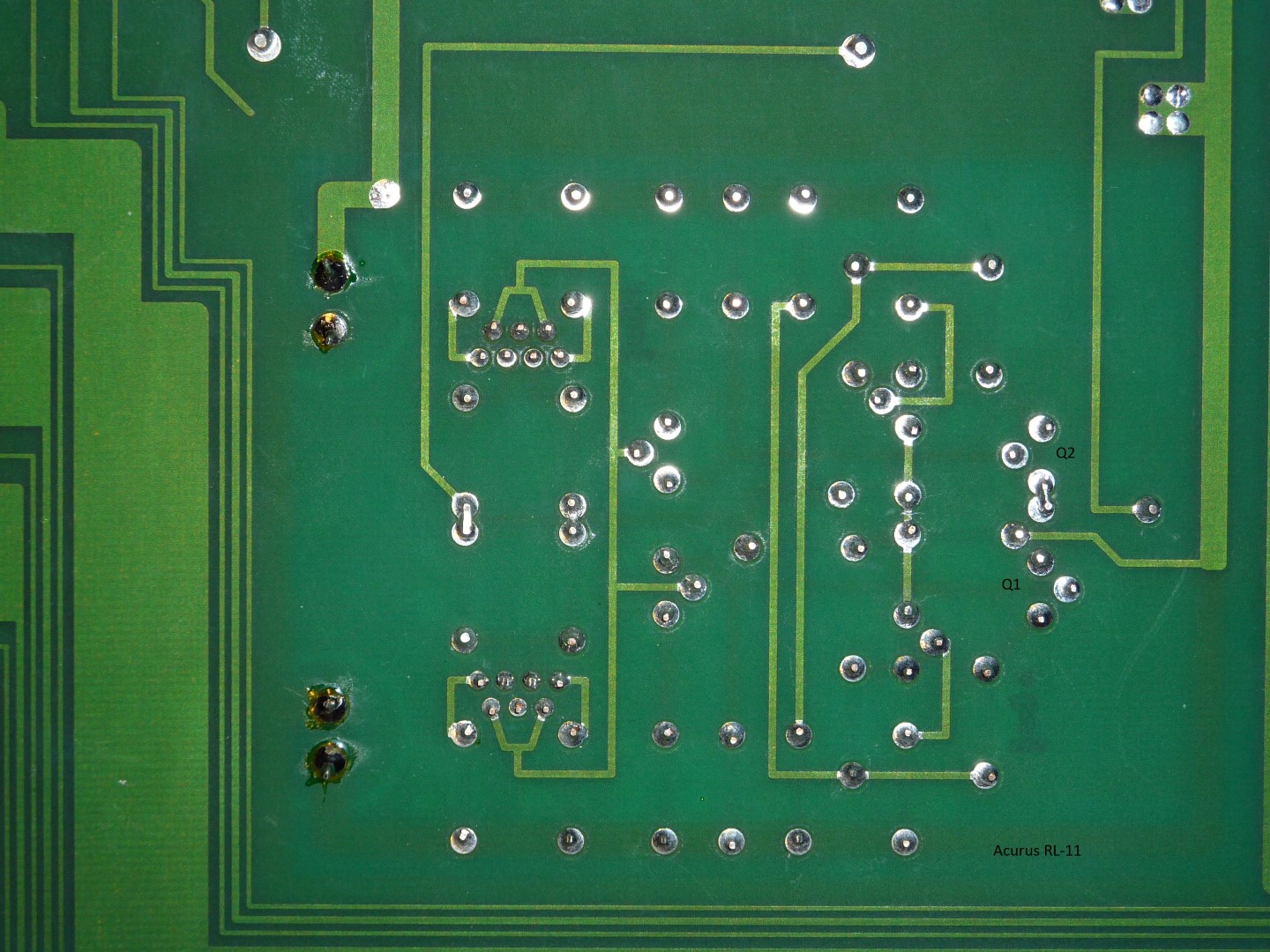

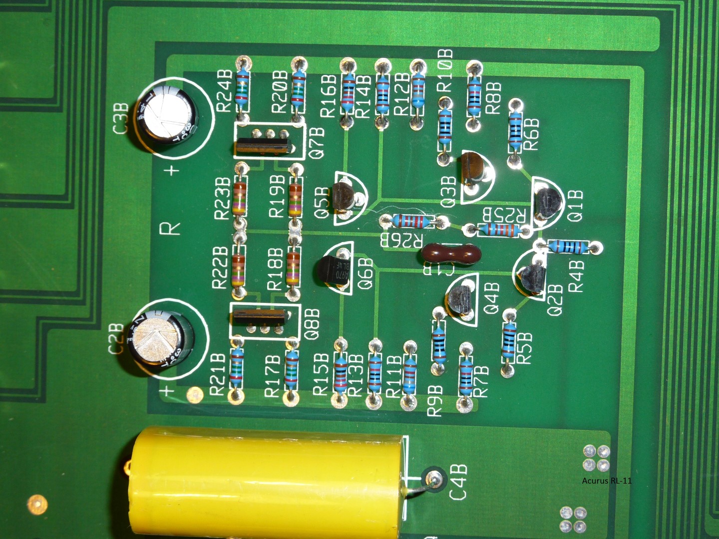

Thank you for the additional photos and Aragon schematic. I understand the RL-11 is supposedly very similar to the L10 except for the RL-11 being remote controllable.
The Aragon I have no personal experience with. If someone here has heard both the Aragon and the Acurus, perhaps they can chime in with how the two compare sonically.

Stumbled across this thread kind of late but thought I'd give my .02. I looked over the mods performed by Ken Ealey and I'm not liking what I see there. As others have stated he eliminated the +/- 18 V discrete regulators and is running full rectified voltage to the line stage DC rails. I have worked on a few of these Acurus pre's and the non-regulated voltage is usually around 29 -30 VDC with a good bit of ripple as one would expect. I would say that he is still CRC filtering the rails but now he only has 2 uF film caps where there used to be 1000 uF E-CAPS right after the 10 ohm 2W RC resistors so there is not a lot of storage after those resistors. It also looks like he removed the 10 uF output coupling caps and shorted those from underneath the board. The small electrolytic at the input to the line stage was also added by and I'm assuming it is a non-polar input coupling cap. I can think of no other purpose for it in that location. The Aragon Pre's used an input coupling cap and had the output directly coupled to the line stage. But they also offered a DC offset adjustment to trim the circuit.
Personally I just cannot see that preamp sounding better than the stock unit!
If it were me, I'd develop a current source for the stock complementary diff input. Then I'd turn my attention to the power supply. The stock transformer is only 5 VA and this pre draws about 3 - 4 VA in operation so the transformer is overloaded in my opinion. A 10 VA toroidal will fit nicely, but you will have to be resourceful and build a small bracket. Then a new larger set of main storage caps to replace the 3,300 uF/35v electrolytics (10mm pin spacing snap-in style) and then add a set of wima film bypass caps across the new E-caps on the backside of the board.
If you are feeling really energetic then the cheap metal films can be replaced with RN60D's. It is time consuming, but I've done it on a few of them. You might as well also replace the 1000 uF E-CAPS on the regulated side of the DC rails.
