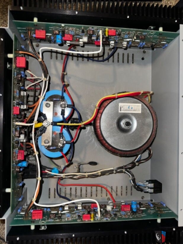

I just purchased an old Acurus 200x3 off Ebay. The unit was dropped, and only 1 channel is working. I was going to repair it when it arrives, but I really only bought it for the chassis. My DIY 2 channel amp is a Rod Elliot P101, I really like the sound and power. If I go the route of building 3 more P101's, What size of toroidal transformer would I get away with? I have a 800va 40 +40 in my 2 channel, that I would switch to the 3 channel if that is large enough. I would then get a 500va for the 2 channel ? The units are mainly for my theatre room and play 30% music also.

I'm guessing that is a clone? It's modular and quite different from the pictures of an actual Acurus I have seen:
Given that it is a clone, I would say what you do with it really depends upon the quality. If dropped probably pretty easy to repair and judge if you like the sound better than what you want to build. I'm not sure on the transformer thing- so hard to find any specs, unless they are printed on the side. Might check, then you will know what you can do with this one at least. I'm guessing they probably sized it right, looks similar in size if not larger than the original design. Looks like you will get enough good bones to really kick off your new build.
Sorry I had posted my P101, 2 channel. The Acurus arrives next week, hopefully. The rails on the Acurus are 85v from the schematic I received. I believe that would make the transformer in the 3 channel 60 + 60 ?. That would put me at the extreme max for my P101 boards.

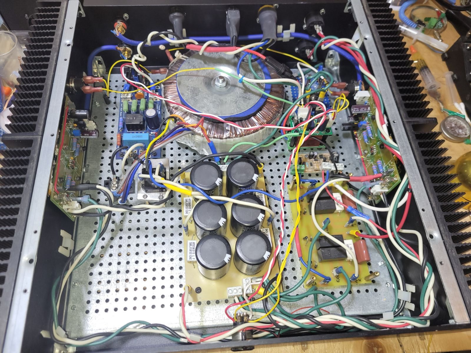

Well, My Acurus 200x3 was lost somewhere in the eBay international hub. I just ordered a Carver av-405 that needs repair, protection light on.
On a positive note, the Carver has 56+- and 42+- rails that will work perfectly with the P101 boards if I can't repair the unit.
