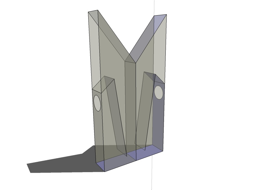

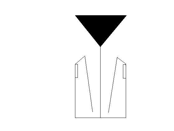

I've been studying all the pictures of the Acuhorn 155 that I can find over the past couple of days. And I think it might look something like this, internally. About as simple as you can get really. Given the relatively light weight for the size, I suspect it's something like this anyway. Two horns, back to back, and separated by a central baffle, with the drivers wired out of phase. I ran a quick MathCad sim on this, assuming the old-type non 'E' FE208Sigma, and aside from a dip at ~150Hz, the FR looked decent enough. Could be as cheap or as expensive to build as the wallet could afford -anything from chipboard to the more expensive types of veneered birch ply or solid wood would be on. Could be a really interesting option if you have the space.
Hi, thanks for the great render! (What was it done in BTW?) Seeing it presented in 3d really does help -I reckon if it isn't that, then it's something very close. Interesting re the positioning too. Sounds favourite for the di/bipole operation.

SketchUp (SU) free from GOOGLE.

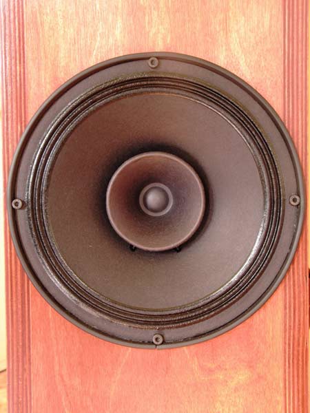

Hi, I have been to a shop to see how the original (non modified) driver of the acuhorns look like.It has a very small magnet and it has a huge frame basket, very strange looking driver since the openings on the frame are relatively small compared to the frame surface.Maybe it is a good driver as a first driver for single-driver experiments.Some DIY-ers from Poland made a similar construction to the Acuhorn's.

Interesting to hear from someone who's seen the original unmodified TVM / Tesla driver. Thanks for that.
I used approximately the original dimensions with the Fostex sim I ran. It's only educated guesswork, but the mouth area was exact, & I'm pretty sure the throat area was very close too. The rest of course is up in the air -you say some Polish DIYers have built something similar? Any details? The internal baffle I assumed for my sim went down further and at a shallower angle, creating a big CC in effect coupled to a short, more rapidly flared horn. Of course, these could just be big, positive tapered pipes, with the internal baffle at a steeper angle, terminating higher up, with no CC and giving a longer horn length, though that would mean the initial horn flare would be pretty straight. Given that each horn actually would have to be pretty shallow (~11in), I can't see there being physically room for anything else to be honest.
I don't think a doubled version of the BIB would work sadly as it relies on the room to complete it's horn mouth, and is designed for corner loading, which wouldn't sit too well with bi or dipole operation. Yes, similarities to the Nessie in some ways. Now, the 175 on the other hand looks to me from the website pictures like it is simply 2 Voigt pipes, back to back (the rear one inverted). I think I can see a front vent near the bottom, and there looks to be another at the top on the back, though the pictures aren't clear at all, and I could be way off the mark. Having said that -it'd work, no question. And very well too, providing the vents were properly designed.
