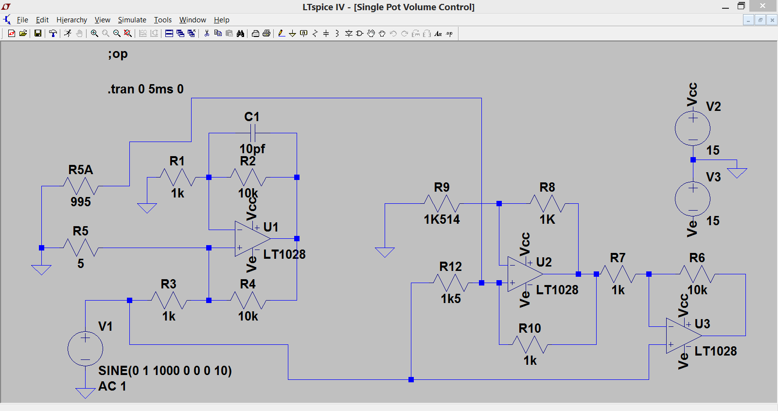

The analog inputs of the professional driver processors need, ideally, a balanced maximal signal of nearly 8 Vrms.
Here is a circuit, inspired by the Baxandall volume control circuit made popular by Douglas Self, which I built with NE5532s and which apparently fulfills these requirements.
The real nice thing with this kind of circuits relies in the fact is that they use a linear potentiometer to get a log response and that their output are intrinsically of low impedance.
In Baxandall-Self's circuit, the pot cursor is buffered by a voltage follower stage which feeds an inverting voltage gain stage.
In the present circuit, the voltage gain is provided by the first stage, and the second stage only reverts its polarity.
So the outputs of the op-amps deliver the same absolute value of voltage but are of opposite polarity, so they are balanced if the series resistors which connect them to the output world are equal.
Distortion may slightly higher than the Self's circuit.
May be the resistor values shown could be slightly higher to reduce the demands in current of the op-amps. A better solution would be to parallel op-amps as shown is Self's "Small Signal Audio Signal" in the aim to get the lowest noise as possible.
Another feature of the circuit is that the output of the first stage can be used as an unbalanced line without bothering of the inverted polarity of the second stage.
Any impairment with this approach ?

Hi, nice idea ! Out of curiosity i simmed it, & THD @ 1kHz was 0.001%. I always thought that the original idea published in, i think WW back in the day, seemed a neat solution. I had a feeling it was JLH that did it though ?
The only "slight" negative to it, is the extra time delay between the + & - outputs. Even though it's very small, & probably won't concern many people, it's worth noting.

There has even been a further development, where a single linear pot controls two channels simultaneously, also in E&WW, IIRC.
I think I remember that one but had no idea how it was implemented.
I'll have to search in my E&WW collection.
Bruno Putzeys balanced preamp with active volgende control from Linear Audio comes to mind. Do you know that?
Sure. Baxandall proposed the same scheme in the article I mentioned, fig. #22 and which Bruno may not be aware of.
In fact it isn't in EWW: it is an idea from the great Steve Woodward:I think I remember that one but had no idea how it was implemented.
One Single-Section Potentiometer Sets The Gain On Two Channels | Components content from Electronic Design
That one has a linear gain control; maybe with little more ingenuity would it be possible to approximate a log law?
This was done around 15 yrs ago... application note from Maxim I think. It works well in theory, in practice the pot needs to be 100.000% perfect and so to the layout. Even an ohm or two of resistance in the wiper contact ruins the performance.
R5 and R5A are the pot.
Then they probably lifted it from Steve: he must be one of the most plundered author in his field....This was done around 15 yrs ago... application note from Maxim I think.
