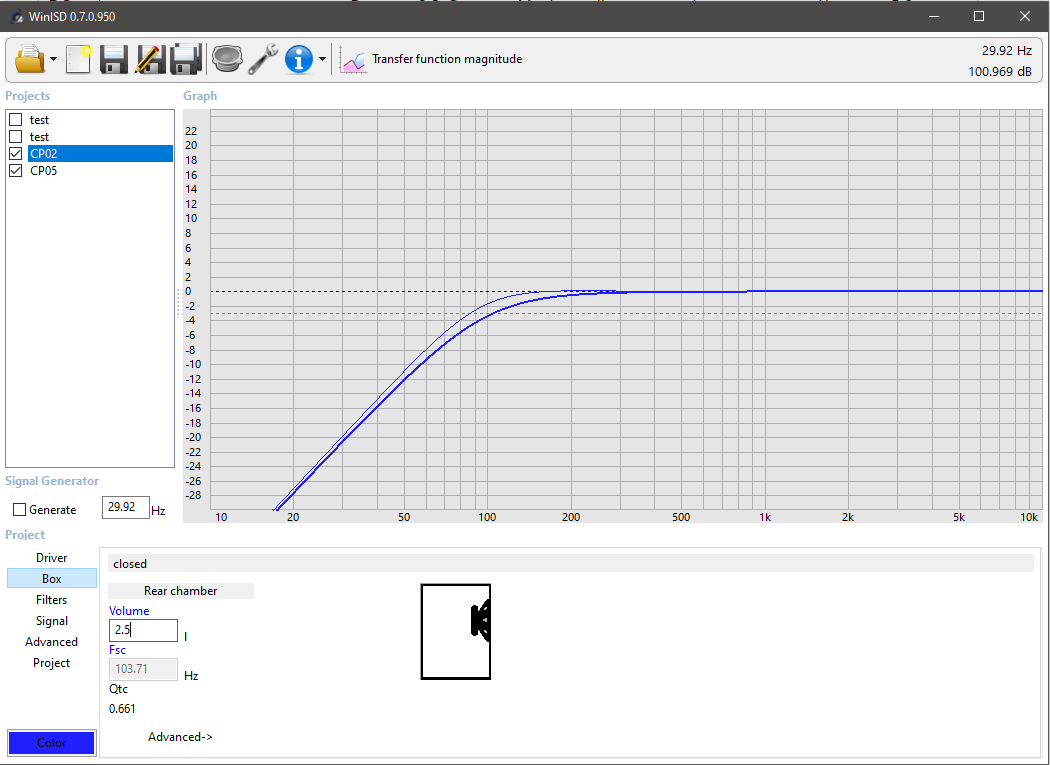

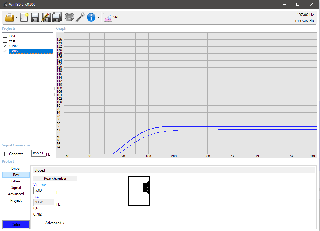

I think it's sds 135 f25 cp 02-04SDS-135F25CP05-04
do you think this one is very different? Also have a look at toutlehautparleur, they will recieve a delivery soon and sell it for nearly half the price...
You need to cross higher, but can use it in half the size of the CP05. This is a quick sim from both...
