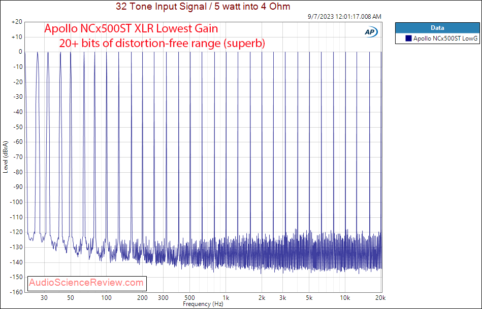

Linn products, famous for using innovative techniques has swapped tda7293 for the better sounding class D tpa3255 in the Selekt dsm series.
The best you can do is to compare for yourself . I did it, and I sold all my class A/B amplifers.

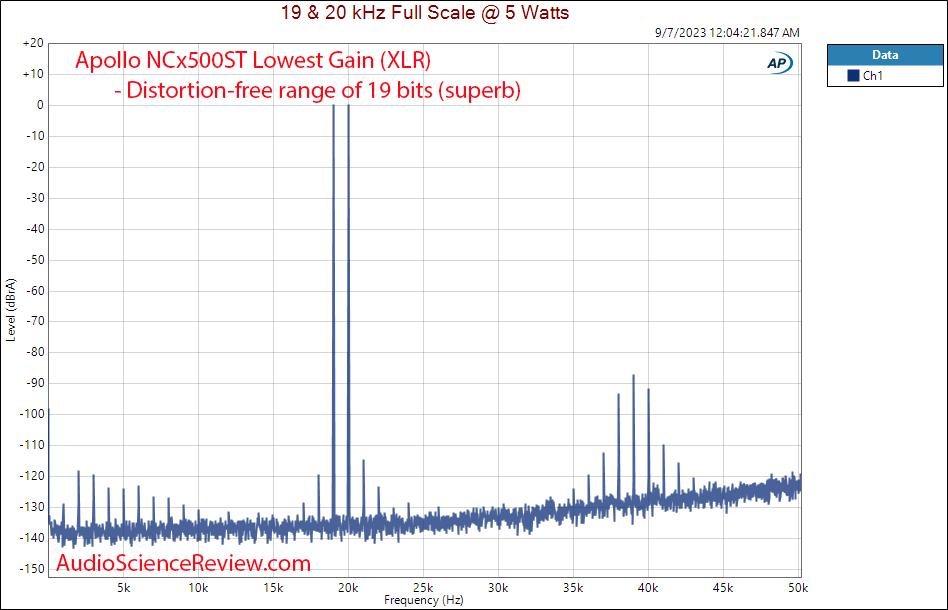

15 years ago , the best class D couldnt be used for high fidelity above 6 kHz.
Nowadays , the best hypex amplifiers has lower distortion at 19/20 kHz intermodulation measurements than the best class A amplifier .
If I were you, I would use class D in every register.
This class D Apollo NCx500ST (Hypex) amplifier outperforms almost all amplifers regardless of price.
https://www.audiosciencereview.com/...ollon-ncx500st-stereo-amplifier-review.47701/

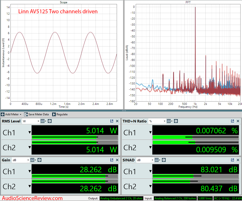

Seems like you have to own a composite amplifier then - don’t wanna be rude , but were are the measurements showing any superiority of a composite implementation ?I've tried almost every TPA3255 board available (Ti's board as well) and I sold all of them on eBay. They couldn't match the performance of my current sharing TDA7293 composite amplifier.
Measurement wise, the raw TDA7293 is very mediocre .
An example here , with good sounding colorations :
https://www.audiosciencereview.com/...linn-av5125-5-channel-amplifier-review.13902/

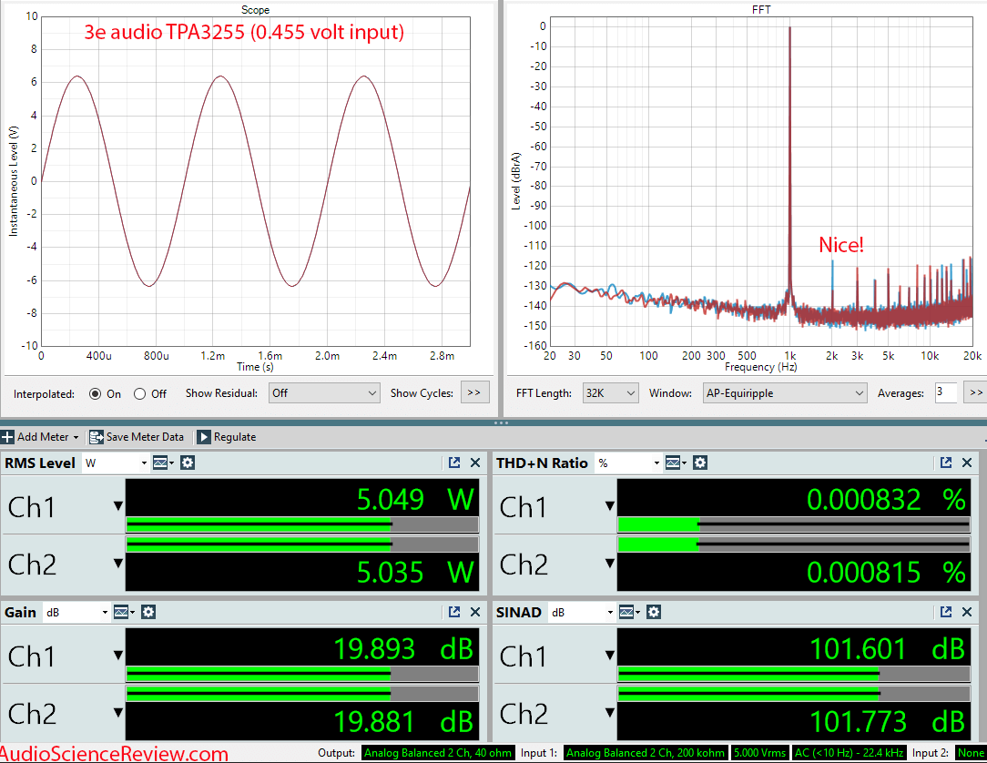

You may be right , would love to be proven wrong . Can you show me a link of ANY measurements of this composite amplifier that you’re talking about that beats a pffb tpa3255 ?If you're having in mind the conventional application of LM3886 or TDA7293, yes you're quite right that some class D amps perform better.
BUT if any of these power chips (LM3886, TDA7293) are included into a composite amplifier, the picture changes completely. In this case the composite amps perform better.
Pricewise composite amps are better choice as well.
Below a good example of modern tpa3255 implementation :
https://www.audiosciencereview.com/...dio-tpa3255-260-2-29a-amplifier-review.50208/

The really good class D amps are all understandably coy about how they do it. My best guess is they're adding an op-amp gain stage, compensating the heck out of it (including putting the filter chokes inside the feedback loop) and closing the loop.This class D Apollo NCx500ST (Hypex) amplifier outperforms almost all amplifers regardless of price.
Apart from that, these ultra-impressive noise floors seem too good to be true. 32 ultra-clean and uniquely adjustable signal generators in parallel sounds expensive. Or are they just using major 3rd intervals; each tone approx. 2^(4/12) times higher than the one below it? Irrational frequency ratios would be more revealing and useful, as it would make the signal properties non-repetitive.
