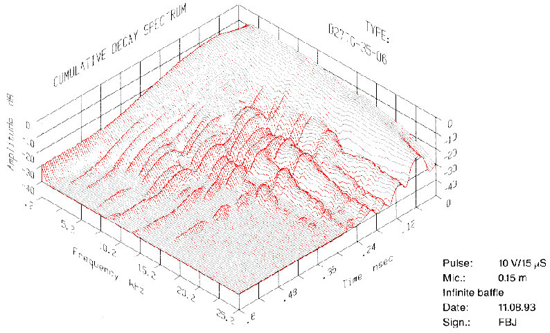

1" silk D27TG-35-06

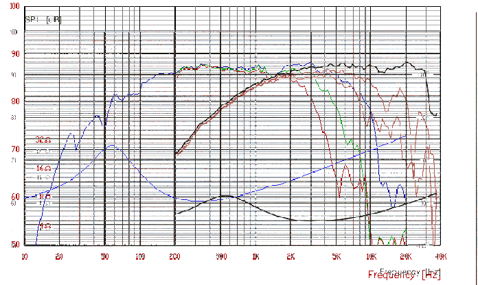

5" p13wh-00-09e

i was wondering,i see plenty of information online about HOW active filters work,yet little work on how to actualy implement them with woofers practically?? -actively.eg the ESP site just shows active filtering but not how to apply it to his certain speakers.
eg=i have these 2 woofers-if i just decide,ok 3khz looks nice,
how can i expect that to sound? can i use the manufacturers FR curves? do i have to measure my own? what problems may occur?

ive looked at the responses of both of these speakers,very good.
i cannot deduce anything from the decay response..i have nothing to compare to.So dont know whats good or bad.
Can anyone direct me to a real world example of active filter usage?

Try looking for active crossovers or try www.linkwitzlab.com
You can learn more there than you think is possible.
As for picking crossover points. Well the best I can tell you is to look at the response of all the drivers you are considering. Pick the crossover points so that the frequency responses of the drivers overlap by at least one octive. Then crossover somewhere near the middle of the overlap.
I have no doubt that others will have other ideas but that should get you started.
