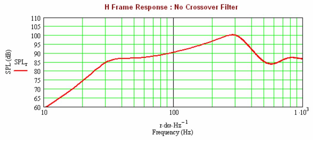

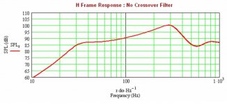

I built 2 eminence alpha 15a in h-frame as per Martin J.King's design (http://www.quarter-wave.com/OBs/U_and_H_Frames.pdf).
The frequency response graph shown in the document(pic attached) suggest a need for a 4-6db cut around 100hz, and perhaps a 6db boost at around 25hz.

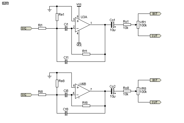

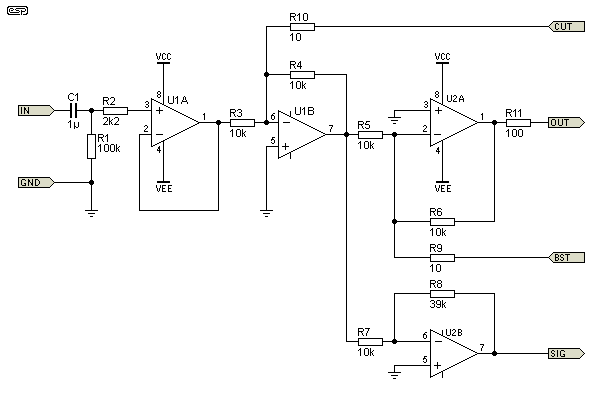

I've been looking at ESP Eight Band Sub-Woofer Graphic Equaliser
wondering if it is possible to implement a part of the circuit i.e. just the two bands i.e. 25hz and 100hz.
And perhaps a fixed resistor instead of a pot for a 6db boost at 25hz and 6db cut at 100hz. The circuit examples given in this documents are attached below.

Hi kaytata,
Rec:You need a PEQ=Parametric EQ, not a Third Octave Graphic EQ
PEQ vs Graphic EQ
A good textbook One Section DIY analogue PEQ can be found here:
faktiskt.io • Visa trad - Julklapp fran Morello's lab.
faktiskt.io • Visa trad - The Morello PEQ
Use Google Translate!
Use HR Hornresp Program to find out the needed PEQ settings.
b 🙂
