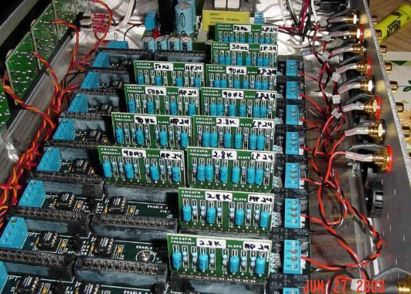

I have 2 crossovers from Marchand, a XM-9-3KK 3 channel crossover and a XM44-4 4-way crossover. The XM44 has slots for plug in modules for Shelving filters, notch filters, time delay, and such, also is capable of 1st, 2nd, 3rd, 4th and 48db slopes as well as asymmetric slopes. Very good unit for DIY and experimenting, and it sounds very smooth and quite.

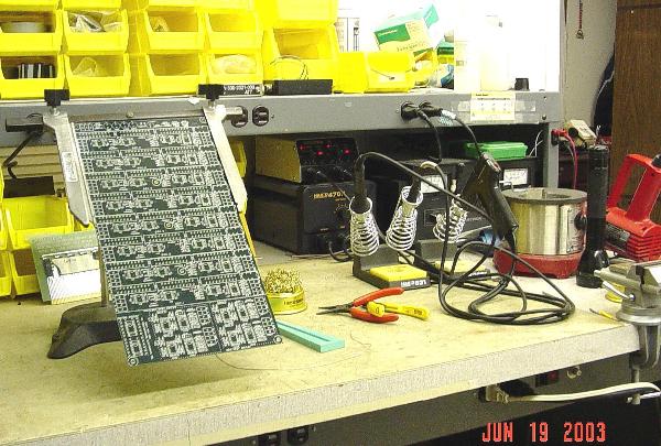

Nice job on the kit, it took me a full day to finish my 4-way. I think you're really missing out on something by not trying to cross the Tweeter/Mid with this, IMO it makes magic compared to passive. I had to use a XM26 (tube x-over) power supply on mine, the stock one would not handle all the op-amps.
A 4-way in one day is very fast, given the number of components. Hope you had good ventilation.
Btw crossing at 90 Hz, makes me curious what speakers you use.
I see you don't have the silver mica caps Marchand is using today. I got mine from Marchand (on request) half year or so after I bought the kit. First he wanted to send them to me for free, but I didn't wanted that. Than he quotes me a very low price for 20 silver mica's (a few dollars). Only shipping does cost that 😉

Well as I said I cheated and did it at work where I'm well set up for PC board assy, and I've spent many hours stuffing boards fare more complex then anything like this, so it was easy.
the 90Hz crossover point was originally for the mid/woofers (SS8530-K00) hi-pass but that didn't work out very well, so I ended up with 40Hz. I bought a dozen extra plug in cards and made many extra for testing. So far I've tried 1st, 2nd, 3rd and 4th order slopes at many x-points, but I like the 4 pole the best.
