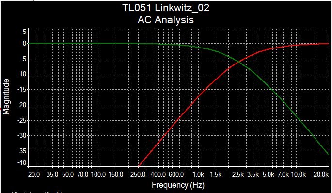

When the four resistors are 6k34
the crossover frequency is 2510 Hz. See image.
By changing any frequency can be achieved.

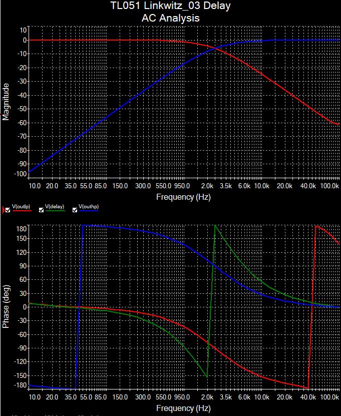

You should add an all pass filter to add a delay on the tweeter : All pass filter wiki
Delay ~ 176us to be evaluated.
You will have better transient 🙂

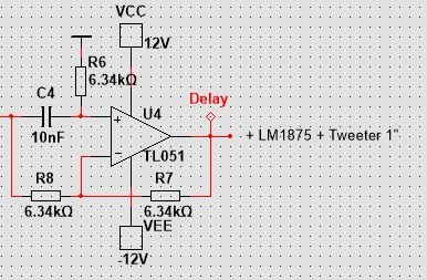

Never seen an analogue xo with tweeter delay; it'd be an outstanding feature to solve.
I added a delay allpass to the highpass.I added a delay to mine, I too use a LR2 analog. It does make a difference.
This is the circuit I used: Would this work correctly?

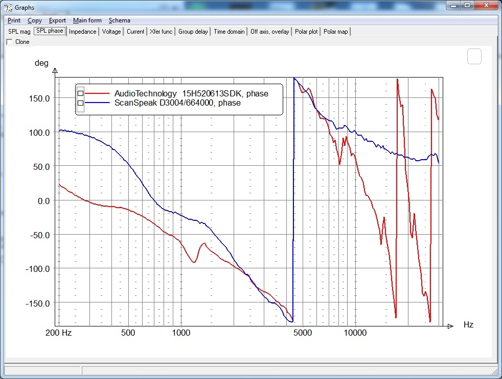

Nice project. I would think before adding an all pass filter to the tweeter circuit that you would want to measure the time alignment between your tweeter and woofer in order to get a better sense of how much delay you need to add on the tweeter channel. (A simple impulse measurement in REW would tell you what you need to know.)
As as aside some years ago I designed a 24dB/oct 3 way LR crossover and came to profoundly regret that I did not make provisions for time delays. This was made even worse because I was using a long mid-range horn and physical time alignment wasn't possible. I actually needed to delay the woofers in this case. (Ultimately went to DSP and learned that having the ability to adjust time alignment electrically was critical to achieving the performance I was looking for.)
I tried to get the phase assuming a given delay in vituixcad so we could compare them but got lost. Need chime-in from analog circuit experts. This is how vitiuixcad draws an opa all-pass block (at 2510hz with different default resistance):I added a delay allpass to the highpass.
I must admit I find delay circuits pretty murky. Here an example from Goran of a passive implementation: https://www.audioexcite.com/?page_id=1988
I guess the proof would be some kind of test against a known control. The difficulty vs dsp I suppose is how does the user calculate/fiddle/set the delay depending on the drivers and baffle layout/cabinet used, per design,

Me too, and I have a lot of analog design experience. Have a look at the schematic and manual (attached) of the EV XEQ-3 for some workable all pass filter design as a guide. A single stage all pass is not a great solution as the delay is not constant over frequency range to be covered IIRC.I must admit I find delay circuits pretty murky. <snip>
You don't need to calculate anything, measure it with an inexpensive calibrated USB mic like the MiniDSP Umik-1, REW and a cheap USB stereo dac. The end result is you know almost exactly how much delay you need to add.
