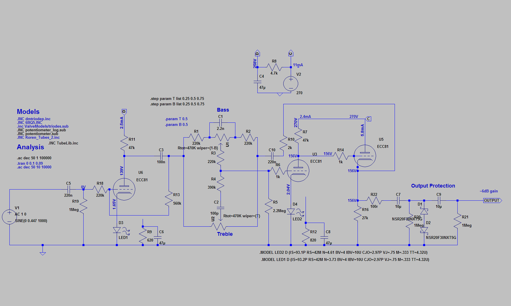

However, my sources don't drive the DCPP to anywhere near full output. I'm at 50/64 on the volume control watching TV at normal level, e.g. So I'd like a version of my preamp design with ~6dB gain.
Attached is what I've come up with.
1st stage is ECC81 gain stage with red LED biasing and local NFB to reduce the gain.
2nd & 3rd stages are the active Baxandall stack using another ECC81. The feedback & output taken from the 3rd stage cathode.

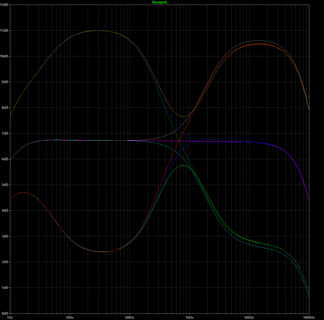

Using lots of NFB, I assume, means distortion will be reduced. Simming this gives ~6dB gain and shows fairly flat at central settings, also attached.
Does anyone see any problems / improvements with this scheme? Would there be a better way to achieve what I want?

Decrease R18 from 470k to 220k. This should increase the overall gain by about 6dB more.
Thanks - yes I had done some tinkering with both R18 & R13 to get flat response and the gain needed. 220k & 560k gives me just over 6dB.
Would 12dB not be way too much? Maybe it's a trial and error situation - would be nice to have a bit more travel on the volume knob!

For a start I would use a 1k2 with a decoupling capacitor in the cathodes not non linear diodes. Remove the feedback on the first stage as 220n and about 1Meg will possibly oscillate.
Use an ECC83 not 81 and why use a cathode follower in the last stage, it just makes things more complex for no reason.

Why is response rising below 30Hz? (I think I see why, but it is your project.)
_I_ would command SPICE to track it down to 0.1Hz and be sure there is no big sub-sonic lump.
Recall that 33RPM is 0.55Hz so some turntable problems can be greatly magnified by sub-Hz bumps.
Thanks - yes, I can flatten that by decreasing C3 to 100n. I had kept it at 220n to match C10, the feedback capacitor for the tone stack. Latest schematic and plots attached.
Have you considered thermal noise in R18 and the tone control network? May be OK for line level, but you should do the sums just to check.
This is a worry. My currrent build is very quiet (well, there is no perceptible hiss when in use) so it would really be the addition of R18 in the signal path. I'll likely get some expensive Vishay/Dale low noise ones to go there...

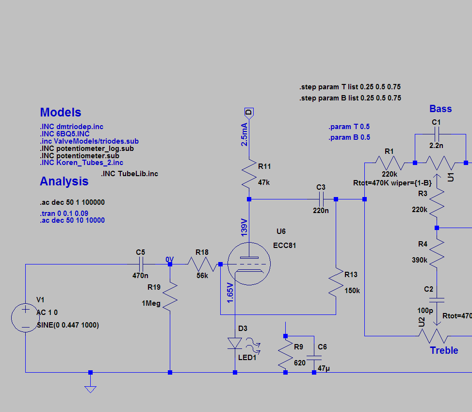

The interaction of R18, R13, C3 & C5 is very interesting. If I halve R18 & R13 I need to double C3 and increase C5 to get a similar response as attached. I guess this is the changing impedance at work?
If anyone can suggest a simpler way to get 6-12dB gain please do let me know!

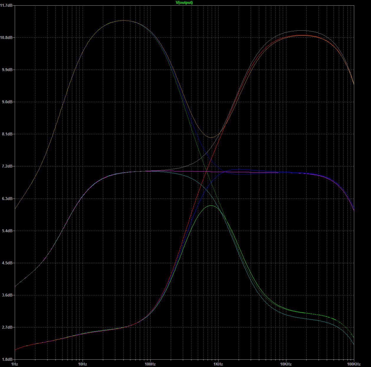

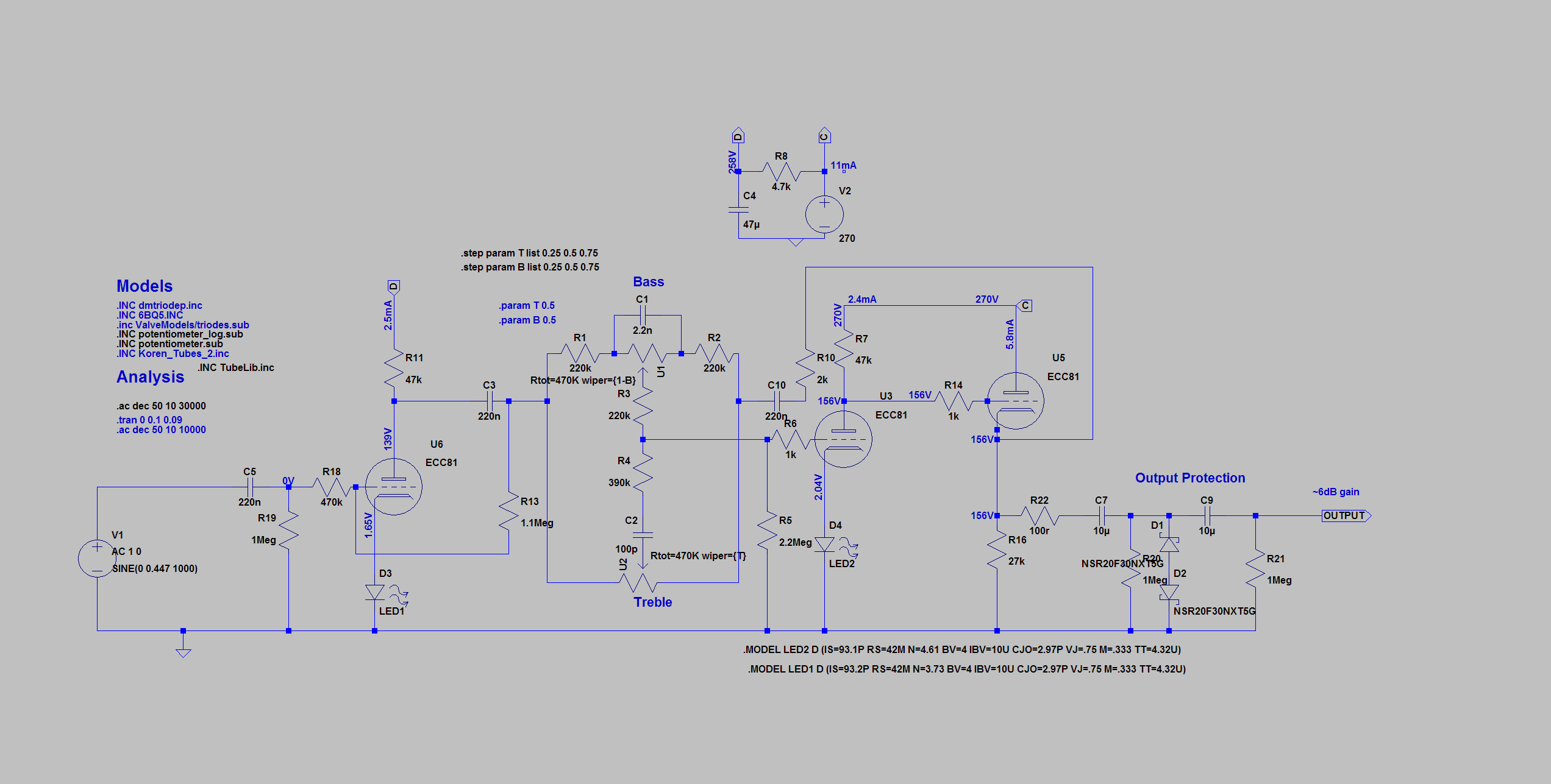

By way of example, here is the sweep when R18 and R1 are 56k and 150k. So lower R18 = lower noise. But this alters the impedance to the previous / next stage. The modelling may not give the whole story?
e.g.: to get a flatter response C5 needs to be increased. Going up to 680n gives practically flat. 470n seems OK.

C3 and C10 do not need to match, as they are inside different feedback loops so are not directly comparable. There may be some advantage in ensuring that the Baxandall network is symmetric, by adding another capacitor after C3 but outside the first stage feedback loop.
R18 thermal noise cannot be eliminated by choosing any particular resistor type. However, reducing its value as you have now done will reduce thermal noise. It will increase the load on the source, but this should not matter.
